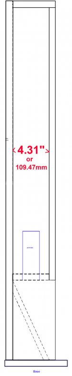

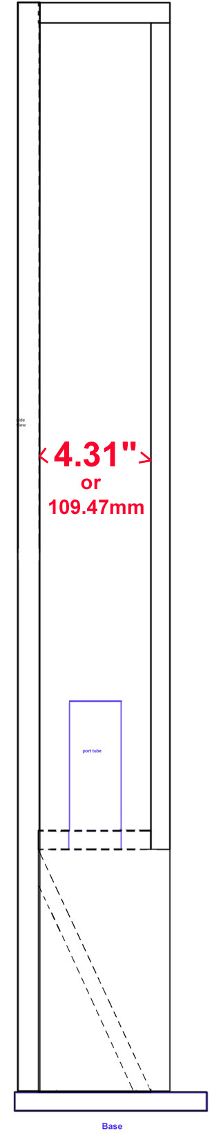

In terms of scaling, for the most part, I'm only looking to make the box narrower - no change in driver.
Hmm, since the Pensil is already long enough to tune/damp its vent over a relatively wide BW, adding a large vent to the existing one would lower Fb, adding more gain BW at the expense of smoothness, but not sure if that's a good plan or not, especially WRT driver protection. Don't recall ever experimenting with, or even simming, one.
Then again, I guess the bottom vent couplers I've used like I spec'd for the original 'short' Jordan JX92S MLTL could be construed as one [the volume behind the sloped baffle should be filled with sterilized sand, Portland cement, Kitty Litter, Oil Dri or similar].
I've never built or even auditioned any, but folks say it makes smooth, solid bass with no need for BSC once properly toe'd in as Jordan recommends.
Scaling in what way? By reducing its net Vb or just changing its width x depth ratio to some golden or acoustic ratio?
