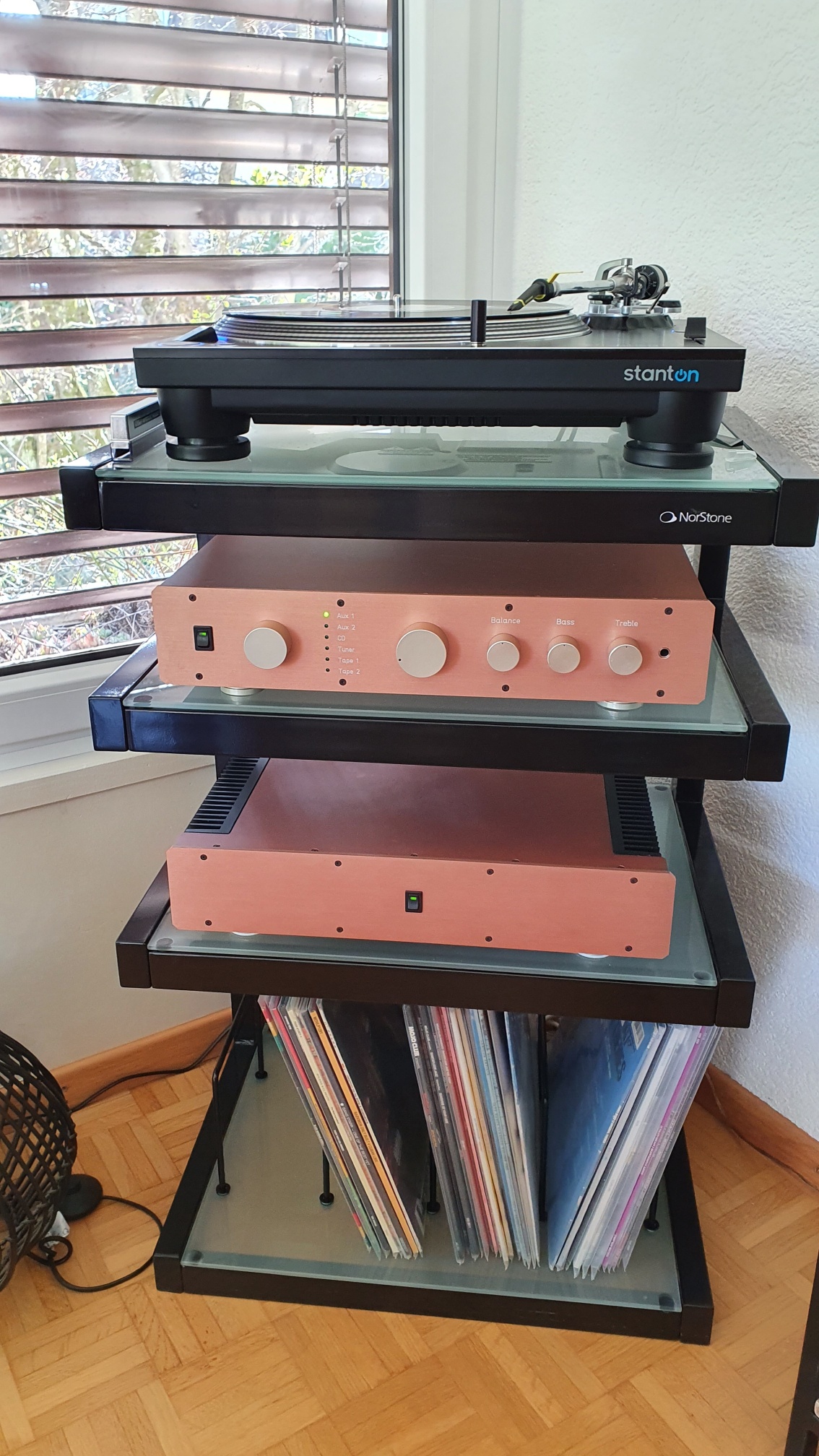

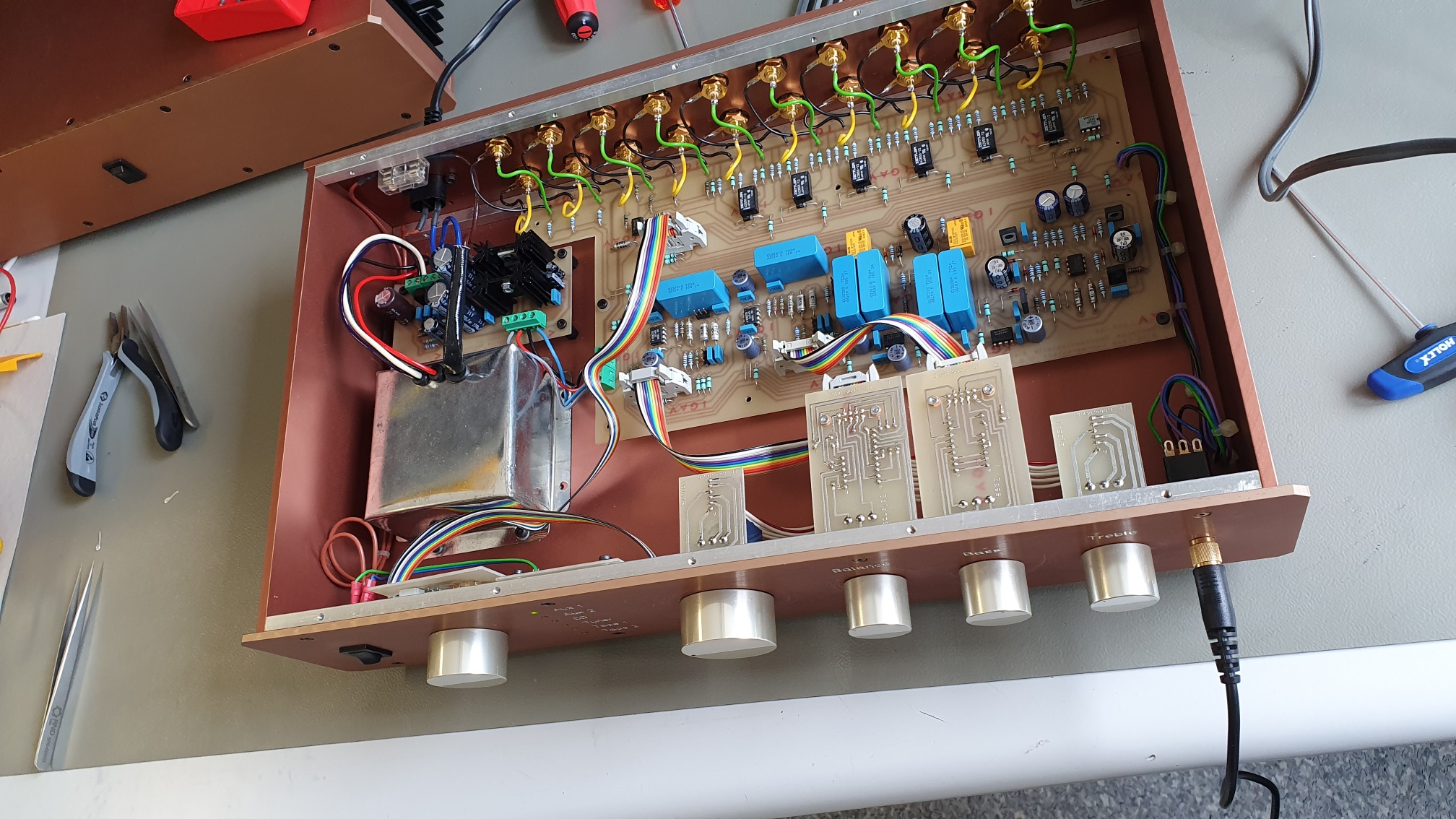

Hi guys,
I'm having issues with a buzzing noise on my self made pre amp.
I manufactured it (together with a power amp, see pictures) during my apprenticeship 22 years ago. I believe the noise was present since ever, that's why it did not use for a longer time.

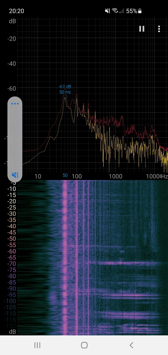

  • I used the spectroid app on the handy to record the noise in front of the speaker. There are obvious peaks at 50Hz, 100Hz, 200Hz and harmonics. See attachment for details of the spectragram.

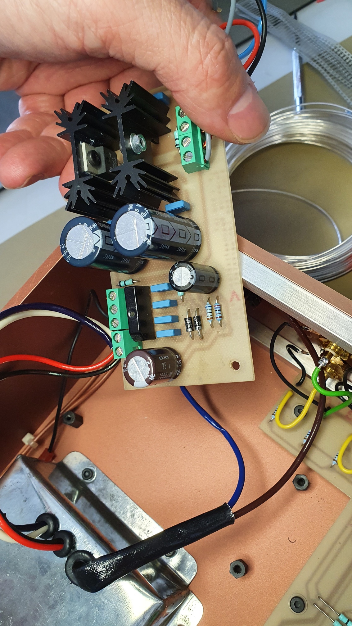

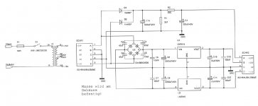

  • The root cause must be somewhere in or before the power supply (see schematics attached). Btw. my supply is +/12V instead of 15V, using LM7812/7912 from Motorola (output noise voltage Vn = 10uV/Vo).
    As well the filter before the voltage regulator is modified with an RC-circuit (10R and 4700uF Elko instead of 2200uF))
  • When disconnecting the internal power supply +12/-12V and using an external device, the noise dissapears.
  • Exchanging all capacitors on the power supply did not solve the problem
  • Exchanging the rectifier did not solve the problem
  • Exchanging to different voltage regulators LM7812/7912 from On Semi did not help. It even amplified to problem (higher Vn = 40uV/Vo might be responsible).
  • I checked the ground routing with an ohm-meter, every assembly seems well connected to ground and the housing.
  • Exchanging the transformer does not solve the problem.

Hi! There is a fault in the system. For starters please use a 3 pin IEC inlet so with PE as the casing is made from metal and we like safety. You will love the challenge as it means drilling and filing. Best would be to use an IEC inlet that has PE combined with a quality mains filter so HF/RF will be filtered. That types are somewhat more easy to fit in general as the hole often is rectangular. Connect PE directly to the casing with the well-known yellow/green flexible wire in the specified way so with bolt, nut, washer. Please measure continuity.
Disconnect Audio GND (Masse) from the casing and connect with a 1W 100 Ohm resistor again. So now Audio GND/Masse is only connected to the casing/PE with a 100 Ohm resistor. The idea should be that the casing is not a part of the circuit. The casing should only be directly connected to Sicherheitserde/Protective Earth (PE) for safety and shielding.
Also check if, for instance, the headphones connector GND does not make contact with the casing. There should only be 1 point where Audio GND and PE meet. I am pretty sure your issues will be gone then.
In the power amplifier also a 3 pin IEC inlet with PE should be used, again for safety but there you may connect Audio GND to PE directly (this in no other sources device!).
Another obvious problem is D1 & D2 have no RF snubbers on them. Put .01 uf across them or between the output rails.
2nd non-obvious problem, the .047 uf caps across the bridge rectifiers. Are these ceramic disks? That number is too big to be economic for ceramic disks, but wound plastic caps would have too much inductance to reduce the transmission of RF by the shut off of the diodes in the bridge. Most preamps I've used had one .01 uf ceramic disk from + to - of the bridge, not 4 of them.
3rd non-obvious problem, is that small board on the left the rectifier diodes & bridge? you need to put a grounded steel box around them. Safety ground, not analog ground. Both my dynaco PAS2 and my Peavey MMA mixer-amps have grounded steel walls between the rectification section and the high gain audio sections.

50 hz, 100 hz, 200 hz? serious indicators to switching noise.
I doubt if you have equipment necessary to detect the radio frequency interference. Optimize the design how? by looking at the DC output with a scope? Radio interference transmits through space, not the wire.

The PSU by Rod Elliot (only wisdom from this master!) is not the same as it does not connect Audio GND to the casing as that is wrong. Your PSU is fine too except for the GND to casing connection.

There is a good amount of 50 Hz in the offending buzz, which suggests either of two sources:
1. Electrostatic coupling of high-impedance nodes to transformer E field. Now there is what appears to be a shielding can over the transformer, so this becomes rather unlikely even with the ribbon cables running close by. A look at ribbon cable pinout would still be good. I may be inclined to wrap them in copper tape connected to chassis if need be. I take it that all chassis parts have good electrical connection between them, and chassis connects to circuit ground somewhere? (Anodised surfaces do not seem to be very conductive at all.)
2. Magnetic coupling of internal ground loops to transformer H field. This pretty much requires finding and eliminating the offending ground loops. We would need to make a plan of the entire grounding scheme of this amplifier, which will take about all the details you could provide us with, OP - notably board layouts and a wiring plan. I bet the problem is somewhere in there.
For one thing, I am not liking the individual wires connecting the RCA jacks very much, it's not exactly the epitome of shielding. Also, it is generally more advantageous to be using the metal backplate as a (sub-)star ground, rather than trying to painstakingly insulate all the RCA jacks from it as seems to be the case here (or am I seeing that wrong?). It means much less effort required in keeping RF out if nothing else. This is standard practice in basically anything Japanese and mass-market with lots of RCA jacks.
I am guessing the sub PCBs are single layer affairs, while the main board may be dual layer? It's all looking very '90s for sure.

I can attach the schematic of the pre amp as additional information.
