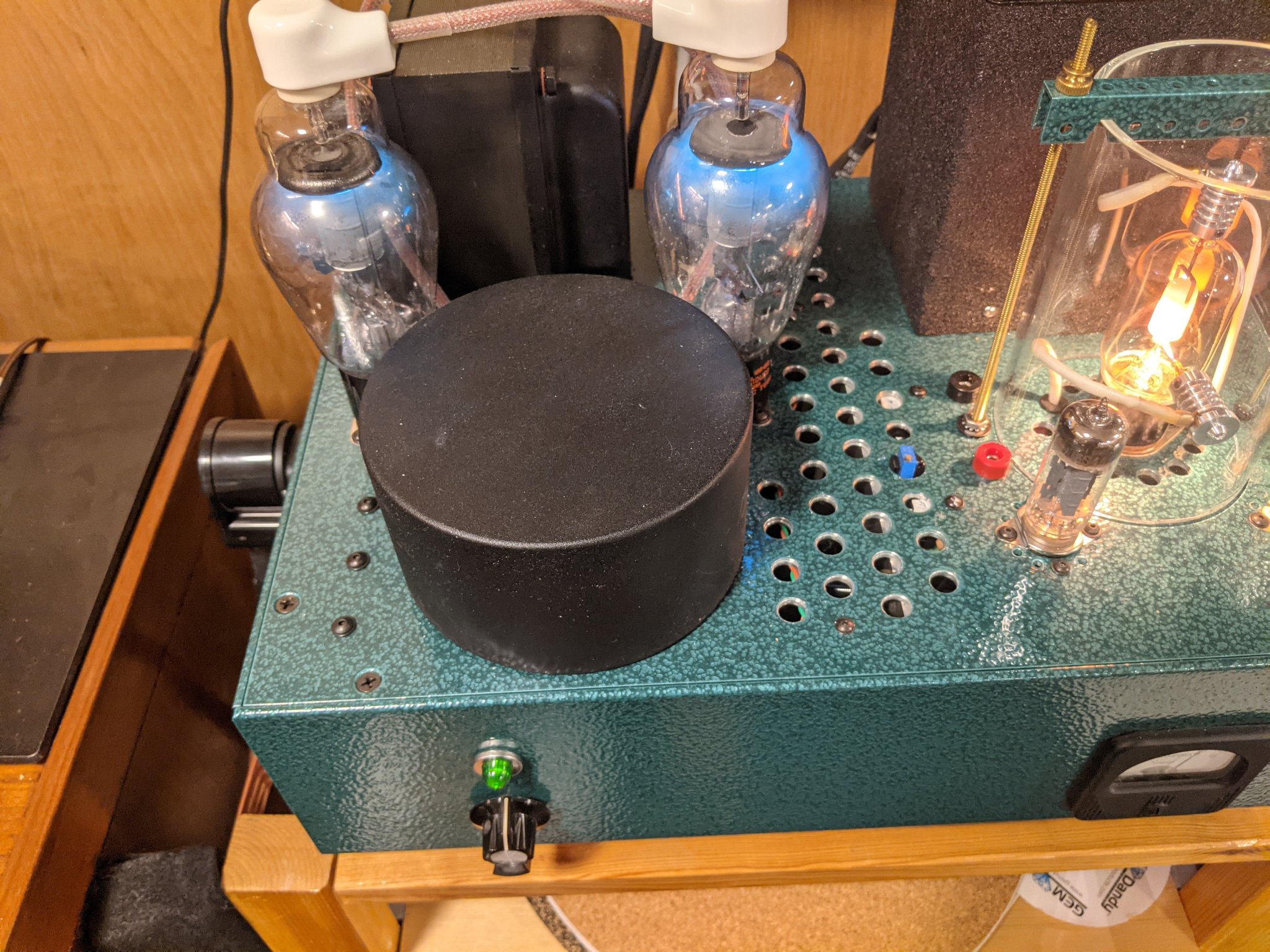

Antek sells a higher "grade" transformer cover without the acorn nut. Expensive they were but the look nice and are heavy. I don't really understand how this avoids the shorted coil syndrome but it has been working for over a year without complaint so I guess Antek knows a thing or two. COVER

A bolt through the center of a toroid produces a shorted turn if the metal cover is also in contact with the chassis. I worked on a project where this mistake was made (bolt got hot!); the fix was to insulate one end of the bolt with a shoulder washer.
The Hammond 270 series transformers are rated for 60 Hz operation, 370 for 50/60 so you get 20% lower flux density on 60 Hz. On 50 Hz... not so much.
The thing is there is a center bolt holding the center shaft to the chassis. Doesn't get hot and works just fine. I seem to remember a rubber washer that insulates the top of the toroid from the steel cover but I'm not disassembling things to check. The toroid has a metal plate that screws on to that shaft to hold the transformer tight inside.
