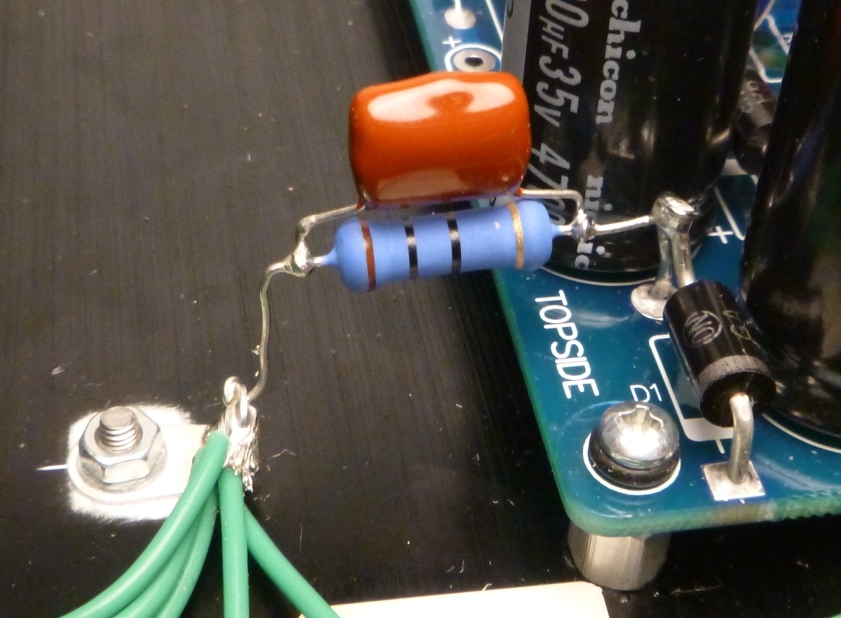

As per your C10 image the 12Vac power supply elevates the filaments. Make sure the ground terminal, NOT the neutral on the AC inlet is connected to circuit ground. See attached picture of how I connected circuit ground to chassis and AC inlet ground (it's one of the green wires on the left side) on a 12Vac using a 10 ohm resistor and a small film cap.
