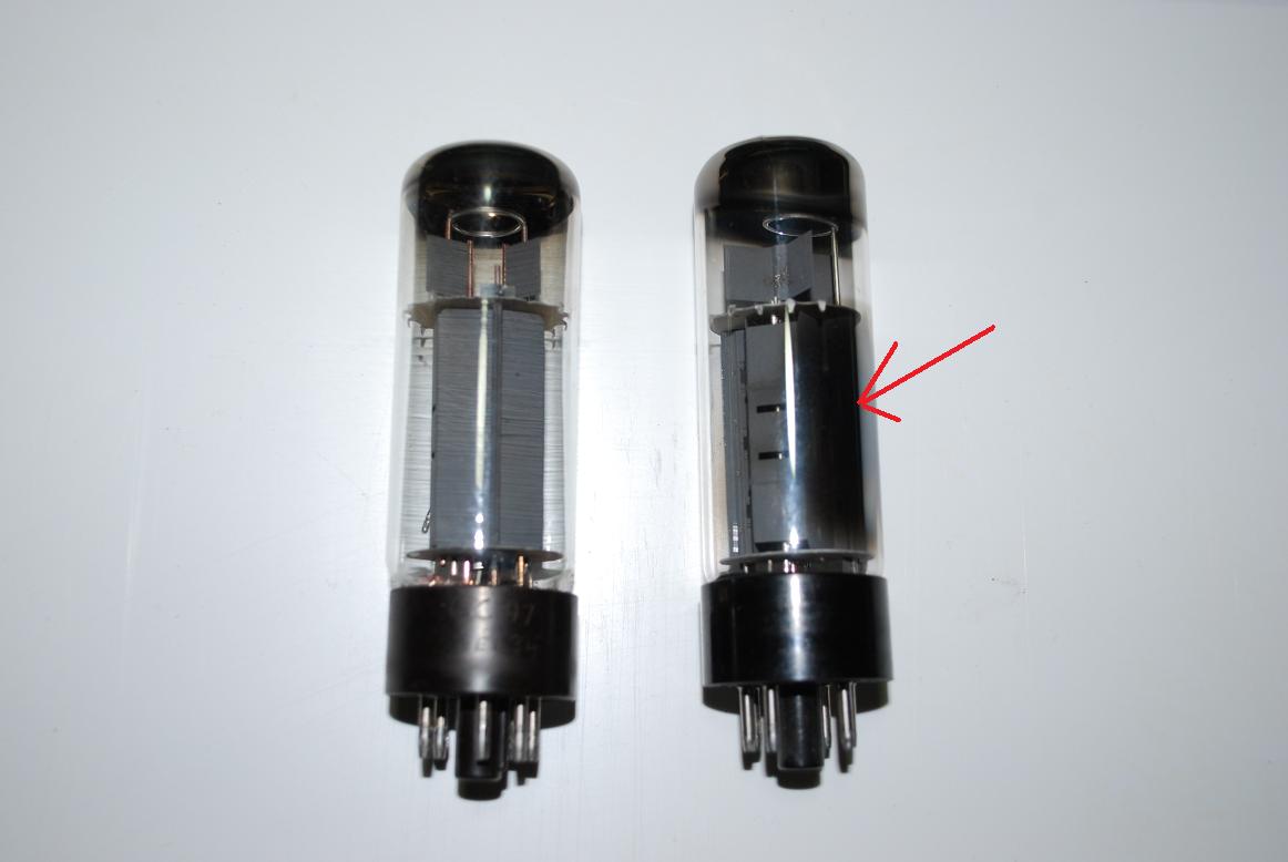

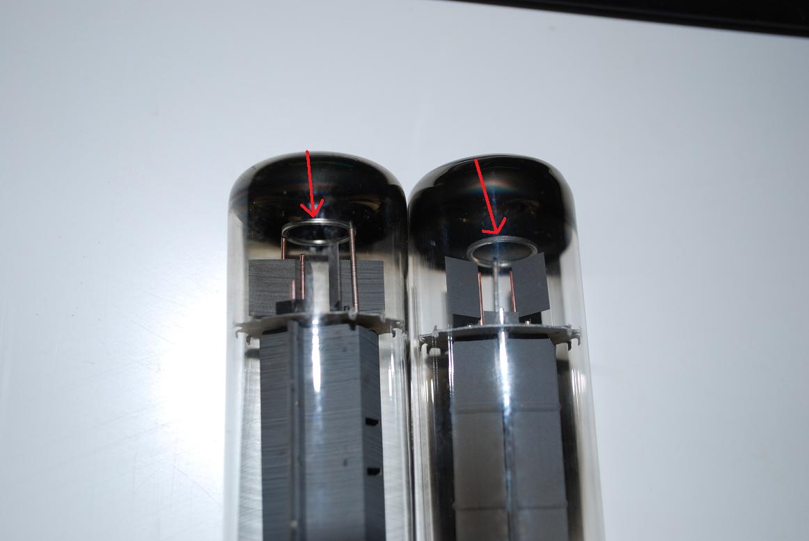

Ok, I then had a very close look at the power valves, as I mentioned earlier on, they looked a little different.
One is Marked 6CA7/EL34 on the base, it's been scribed in.
The other valve has no markings at all, you can see where it was printed on the valve itself but has been worn off & you can't read it.
On closer inspection the internals of the valves are are slightly different, I'll try to get this right, correct me if i'm wrong.
The one that is scribed has the getter ring in the top of the valve connected by two points.
The other unmarked one has the getter ring connected by only one point & is 90deg different than the other valve..
There is a metalic deposit on the top of one & on the top & side of the unmarked one.
I'm not sure if these differences will hurt anything or cause the problem but I thought it may be the best place to start & clear this up first before going on. The base pins in relation to the locator slot are identical.
If it is an issue I will have to wait until some new valves turn up before proceeding.
Wavebourn asked if I had a DMM, yes i have a bit of equipment, an O'scope signal generators etc etc but have never worked with valves before.
It's time I learn more.
I have attached some pictures of the valves & you will see the differences.
Let me know if there ok to use & I will work through all of the previous suggestions & post the results.

Both tubes look like EL34.
My advice is to get the amp into spec. EL34s can have a few variations. Where the getter is does not matter. If its an EL34 then it should work in the amp. I know we like matched tubes,however get your amp working within the spec for the valves. (why trash new tubes for testing!)
The fact that one valve is running so high shows a problem. You can measure the voltage on the cathode resistor to ground. Use ohms law to calculate the current in the resistor. This will give the current in the tubes, However because the tubes are using the same resistor you will not know how much is in each one! Calc is voltage on resistor divided by resistance of resistor = current.
Anodes "plates" must not run so they are RED! It is obvious that you have to much current! You could try some new old tubes!
