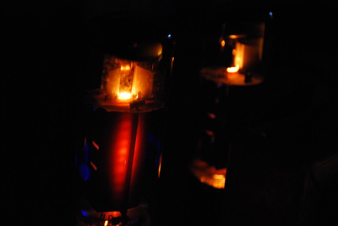

I removed the amp as mentioned previously & after a quick check to see if any of the components looked faulty, burnt etc which they didn't.
I thought I would clean all the pots & try the amp again before touching anything, so I cleaned them & then tried it again with the noise still there.
I then swapped the two output valves over & the noise disappeared, even with full volume playing all the strings very hard--no noise.
There is one valve that is running very hot so I swapped it back over to see if it was the particular socket but it seems to be the valve as it runs hot in either socket & the other valve is a lot cooler.
I have attached a picture, you will see what I mean.
Why would it produce the noise when in one socket & not the other?

You have a fault!
I would change the coupling caps on the EL34's they show on the schematic as 100nF thats a 0.1 uF if you use polyprop you will reduce the leakage! Also change the cap on the EL34 cathode resistor!

Red plating 😱
As I said the other day, measure the relevant voltages to see where your tubes are opeerating (inside or outside maximum suggested limits). As you mention you amplifier has obviously been a victim of a "modder" so chances are bias conditions were changed beyond suggested maximum which some tubes handle better than others.
Do they have some resistors soldered from pin 8 to the ground?
If yes, what are their values?
Do you have a DMM to measure voltages on them?
Also, voltages on 1'st grids need to be measured: if a tube is gassy negative bias voltage on it's grid would go down to zero volt.
