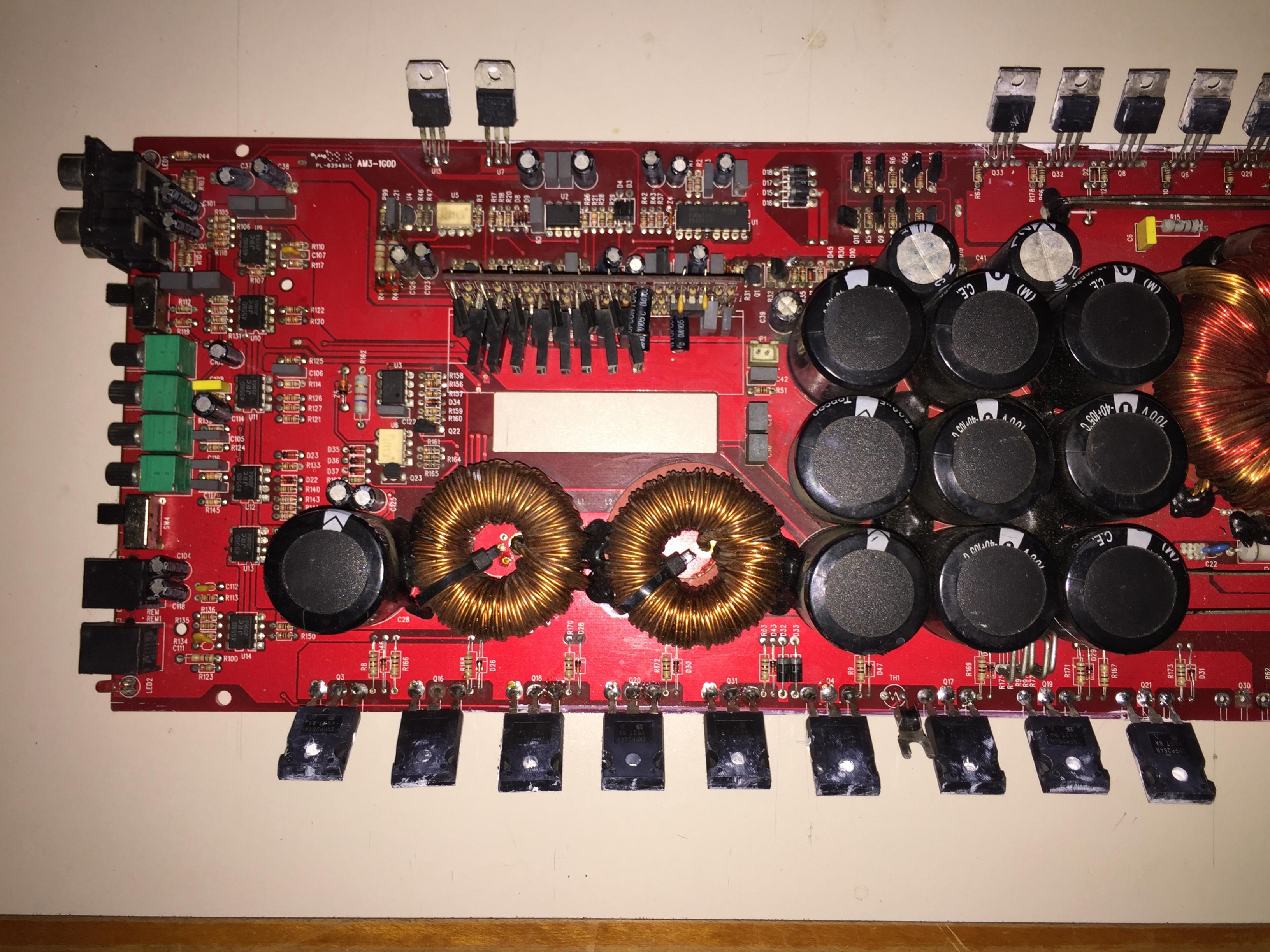

What do you mean by 'one side'? Be specific.
sorry, low side.
That should mean that the output of the amplifier goes to the full negative rail voltage when the amp is switched off. Is that correct?
If the gate of the low-side FET is going to 30v, the low-side would be fully on and the output would go to the negative rail.
