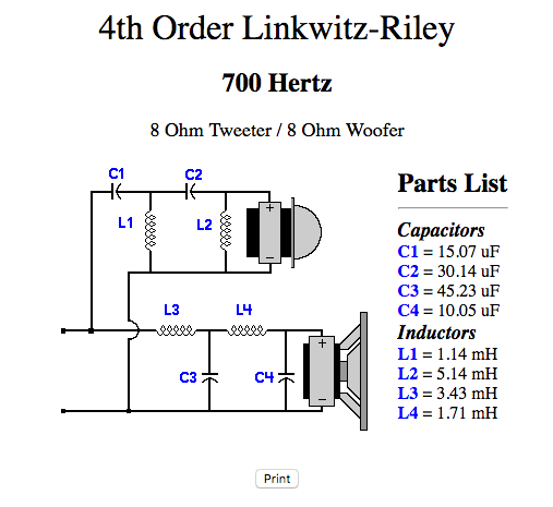

In definitions of the L-R 4th order circuit it's usually stated simply that it's the result of 2 second order Butterworth circuits in series. But both in schematics and the results of many of the online calculators the values of the first series/parallel combination are of different values than the second pair and they are also not always different by the same ratio. I haven't yet found any reference to what that's about. Can somebody give an introductory explanation to how this would be worked out?
Hi and thanks.
In this case the question is about the passive filter.
I took another look at some calculators (four of them) and found they all agreed so I'll consider the one I found the other day that gave different values from the others as an exception, mistaken or not.
My point is that in written explanations of the L-R 4th order it's simply stated that it's two Butterworths in series but there's never a mention of the change in values between the first pair and the second. My question is about that. Just trying to understand what is being done.

LR4 is two B2 in series electrically. That is actively you can
cascade two identitical B2 circuits, but that is not the only
way of cascading two circuits to end up with LR4, there
are degrees of freedom in 4th order implementations.
A passive LR4 (assuming a resistive load and zero source
impedance) can never be made by cascading two identical
B2's. It simply doesn't work like that. And it simply doesn't
work the way those stupid calculators calculate either.

In an active LR4 implementation, you have two B2 blocks, each with high input impedance and low output impedance. They do not interact. This is called a cascade.
In a passive implementation, you have two LC circuits and the driver. It might be instructive to place yourself between the two circuits. The first circuit sees then the combined impedance of the driver and the second circuit. The second circuit sees the combined frequency response and output impedance of the amp plus the first circuit. these interactions are what cause the altered values.

A passive filter requires both the source impedance and the load impedance to be fixed before the design can commence.
Usually the design assumes that the source impedance is zero ohms and the load impedance is infinite ohms. Those are the fundamental "rules" for that filter design.
If either the source impedance or the load impedance or both are not the same as the design assumptions, then the filter will not meet it's required roll-off characteristic.
Take a properly designed LC, or CL, filter that is exactly correct for the two terminal impedances and attach it to another identical filter and both filters will now be "wrong".
The first filter sees the second as it's load. It now has a different roll-off.
The second filter sees the first filter as it's source. It too is now corrupted.
Ron said much the same
The desired cascaded LR4 does not work as intended because the two "Butterworth 2pole" are both corrupted.
Presumably the LR4 calculator takes account of the changed source and loading and give the correct component values to achieve a real LR4.
The mathematics (not simple arithmetic) is quite advanced to achieve a passive LR4.

The Wikipedia page on L-R filters tells me that is is a filter with -6dB at the corner frequency. So 2nd-order L-R is a second order filter with Q=0.5. Fourth order L-R (the most popular) consists of two identical (frequency response) Butterworth (i.e. Q=0.707) second-order filters. Note that this assumes they are buffered (or active).
Two active filters (e.g. Sallen-Key) can be cascaded and you get the product of the individual responses. Two passive filters cannot be cascaded without affecting each other. Two solutions: use a buffer between them, or adjust the values.
There are various ways of adjusting the values so it is perhaps not too surprising that different calculators get different answers - however, I have not looked into this so I don't know if there is a range of correct answers or merely a range of useful approximate answers. My guess (and its only a guess) is that simply cascading two LC with no buffer cannot give the correct response, but can get sufficiently close for most practical purposes.

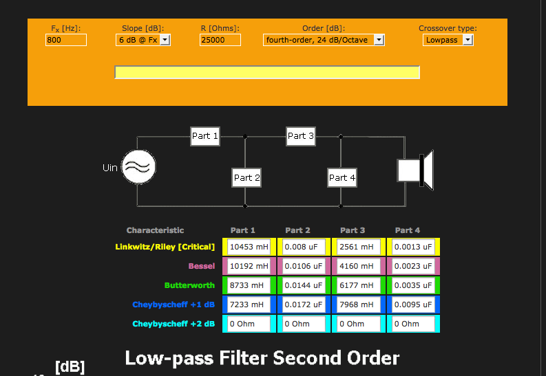

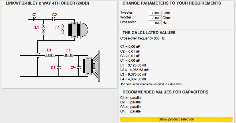

Actually , for the record, I was wrong. I looked again tonight and found three that give near but differing values.
(The 25000Ω was done thinking of the passive filter going into a grid circuit impedance.)

I think the first is not giving an LR4. It is titled Butterworth.
It also has C1 in there which is effectively doing nothing when the source impedance is zero, i.e. it leaves just three components forming an LCL filter
The third is titled "Low-pass Filter Second Order". That would make the top line components into an LR2, not an LR4.
I suspect that the first and third also assume 25k source impedance, as well as 25k load impedance. The title on the third one is clearly wrong, as it shows 4th-order filters.
If you understand filters then you can successfully use an online calculator to do the hard work of doing the messy maths. Otherwise, they are likely to lead you astray.
