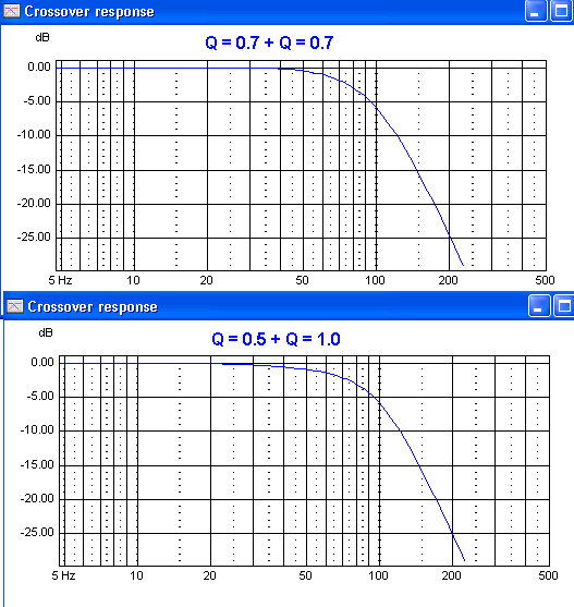

I think I just have one thing to add to Svante's post
Svante, you say that defining a >2 order filter with only one Q is wrong, but I'm not sure about that.
Imagine a 4th order L-R. It's 2 Butterworth in series
a LR's Q is 0.5
a Butterworth's Q is 0.707
0.707*0.707=0.5
so I think you can also put a Q=1 and Q=0.5 in series, that will end in a LR4
But this is yet to confirm
a LR's Q is 0.5
0.707*0.707=0.5

I was just about to say something similar. I think your Q's are right, Ron, but that you can say nothing about the power response in general. The power response will depend on the distance between the drivers, in relation to the wavelength at the crossover frequency. What you can say, though is that LR with swapped polarity on one driver is the only configuration that produces flat on-axis response (for 2nd order, given ideal drivers)

1+0.5 will not yield the same transfer function as 0.7+0.7. It is true that the amplitude at fc will be the same, but to the sides of fc, the responses will differ. The bottom line is, the definition of Q is not the level at fc, unless the filter is 2nd order. So 1+0.5 is not LR.
After looking at some exemple values; it seems you're right.
The total Q is still the same as the 2nd order equivalent, but there's a defined order for the intermediate Qs

Mark25 said:
The above will hold true of any cascaded filter sections, to a certain degree, due to component tolerance, etc
Nope. Not for the Butterworth filter which have all F0 equal. Of course, if the component values are not exact, the F0s will differ, but on the other hand the filter will not be Butterworth any more 😉 😎
Thanks for bringing up the Q=1 + Q=0.5 example, I had always thought that would result in the same as 2 cascaded Butterworth's. Some playing with sims is in order.
Yep me too. Being the stubborn guy I am I had to build 'em in LspCAD and see for myself. 😉
In the pic, the top one is a real 100Hz LR4 and the bottom one is a .5 + 1 kludge. They are pretty close but there are small differences of a dB or so in the shoulder region below Fc.
I had always thought the Q values Linkwitz picked for his stacked filters were arbitrary but I guess we'd better stick to the Q values on his web page for building LR filters of orders up to 10. Thanks for the heads up, guys.
http://www.linkwitzlab.com/filters.htm#2
