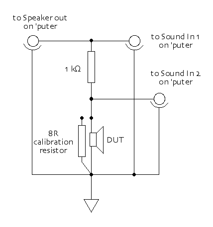

What Mac do you have? By no additional hardware i think Chris really means "no additional computer hardware". If your Mac has a mic input you can at least use the Apple PlainTalk mic (ie on my old PowerBook i used this with mac-the-scope). But my G4 only has a line-level input so i need a mic pre... the Griffin iMic is an option, a more serious mic pre can be bought from a number of vendors, BrianGT & Vikash are putting together a mic pre group buy (boards at least) based on the Neal/Wallin design (my V1 board from Neal attached -- assembled, not tested).
To do impedance you need a jig... a simple jig requires a 1k R, a stereo miniPhone cable, and a calibration R (ideally a similar R to what you are measuring (ie typically 8 ohms).
dave
DRCope said:I've downloaded the fuzzmeasure, and there's much esoteric discussion about it, but what I can't find is an explanation as to how it actually gets USED! How do I get the test signal out to the system - surely not through the headphone jack! What should I use for a mic, and how does it get back into the Mac? The notion that no additional hardware is required, but I don't see how that's possible. . . .

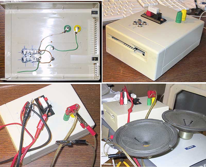

I built up a more elaborate jig... a DUT connection (with wire & alligator clips), a pluggable space for the nominal 1K R, RCA I/O,. the calibration R mounted in an easy to get to place (installed after these pics -- also doubles as an alligator clip dock), all mounted in an old Apple 400k floppy disk drive enclosure.
I plan an even more elaborate one with a switch and additional miniPhone jack so i can hook my 'puter speakers to the jig and switch between them and the jig.
dave

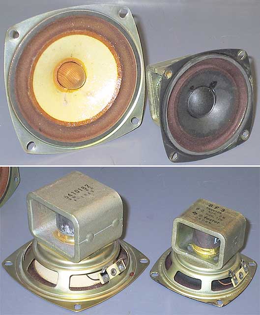

Meanwhile, the 103A's do appear to be identical or nearly so to the Panasonics Dave shows a way back upstream. They do have the ribs, too.

I've since seen these with an Everlite brand name & had correspondence with a Japanese gentlemen eho bought some new, and says they are made by Atomix (they supposedly were one of the smaller OEMs building a lot of the drivers for Sansui -- which i've previously attributed to Coral or Panasonic)

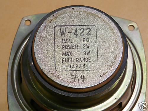

Valeriano said:I'm in the process of taking a pair of foster w422..could you please confirm to me that below attached image is truly original w422 alnico
Can you post a pic of the front. Radial ribs (usually just sticking out from a black dustcap) will confirm that this is a set of the rare Atomix driver. If it is not suffering from SSS (stiff surround syndrome) you have a set of some of the very best exemplars of the 103a genre (along with the holey basket Coral). Yours does have ceramic magnet which i haven't seen and may knock them back a notch in desireability.
dave
