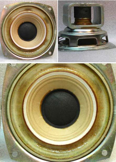

Oops, not Foster - likely panasonic/matsushita
Actually, these aren't coming from Dave, but I tripped over his site, and it was in ordering the phase plugs that he informed me that the drivers weren't what I thought they were. Once the drivers get here, I'll measure and order up.

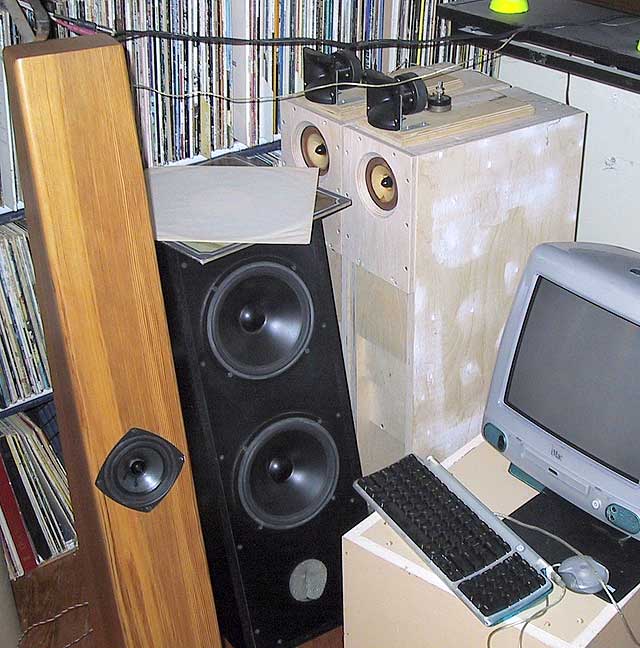

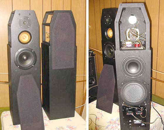

And speaking of Cal's FE103As.... here is a pic of them in his new "Jimmy Buffet" 4-ways (or maybe 3.5 way). They are actually just place holdng for a pair of Coral 103As which -- unmodified & with a bit of "stiff surround syndrome" -- he liked better than the tweaked Fosters. His Corals are over here for surround resurrection and tweaks including phase plugs.
Dave's 103As, to my best guess, are also Corals and very similar to Cal's, the prime difference being the baskets.
Also of note in Cal's JBs are the Foster inverted dme tweeters. These are the only ones i have ever seen and look really nice (and Cal says they sound really good too)

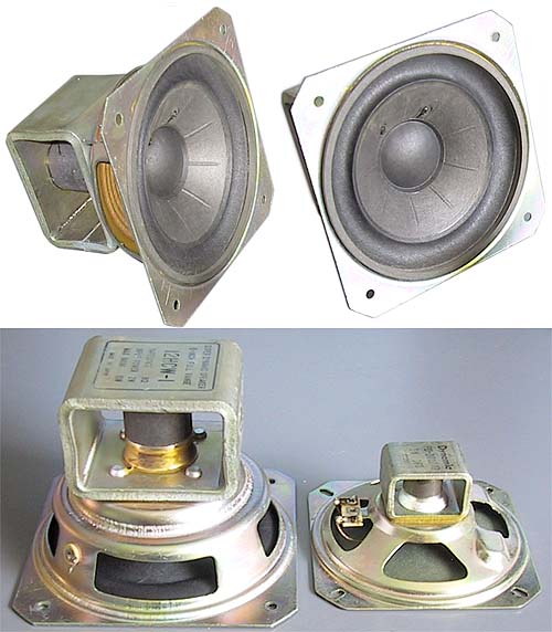

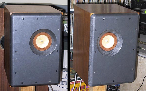

Here is a pic of the Corals (i'm going to call them that, but still have some suspicions they may actually be Panasonic/Matsushita -- note that these were the guys that pushed FR tech the furthest of any of the big 3 OEMS)... note what looks like may be the points of ribs sticking out from under the dust cap)

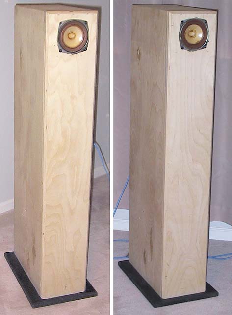

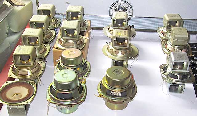

and a group photo... mostly Foster FE103As ... of special note are the set on the lower right, these are a Canadian made Radio Speakers of Canada variant found i a set of the trendy Electrohome speakers -- unfortunately foam surrounds that are now dust. Since this pic was taken i've gotten at least 3 more flacvours of Corals (2 of those are singles), 2 more flavours of Foster, and the Panasonics above. Dave's are another i haven't seen. I mention numbers because this is probably fairly representative of the population distribution.

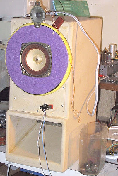

and here they are in the Fostex FE103 recommended horn... these need work. They have a "closed-in" character in the mid-range that makes them hard to listen too. 1st thing we are going to try is apacer plate on the front to make the compression chamber larger (Chris B-Horns with FE108ES developed a similar charachter when he decreased the compresion chamber). The Tim Forman-style ML-Voigts with 40-1197s easily out perform them. (the vintage iMac is intended to become a digital music server, and the black box has the Peerless 8s -- the ones with the really low Fs).

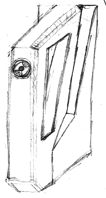

An early concept sketch attached -- it has evolved from this sketch.

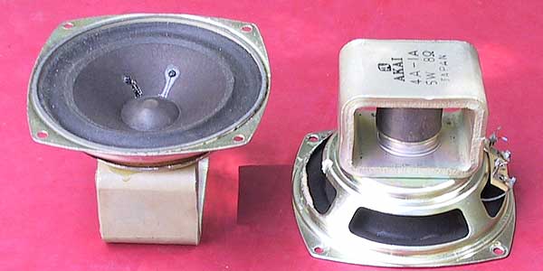

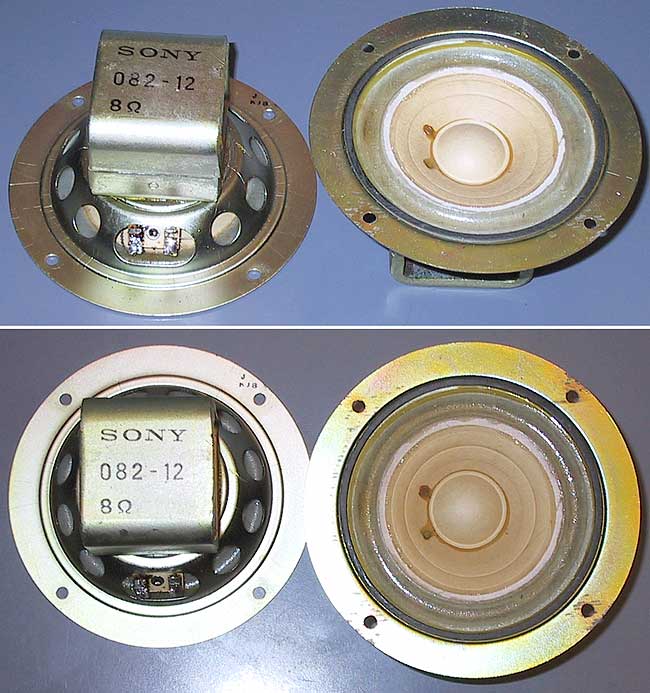

Dave,
I see the ribs in the cone in the larger driver, but I don't see anything in the pix of mine either in the cone or the dustcap. I assume, if they're there, that they stiffen the cone with little weight penalty, which would make the wave launch more uniform. What about the resulting sound makes them "special"?

Hey dave, you posted pics of my unfinished Jimmy Buffett speakers. I haven't done the top grille yet. I will post when it's complete.
