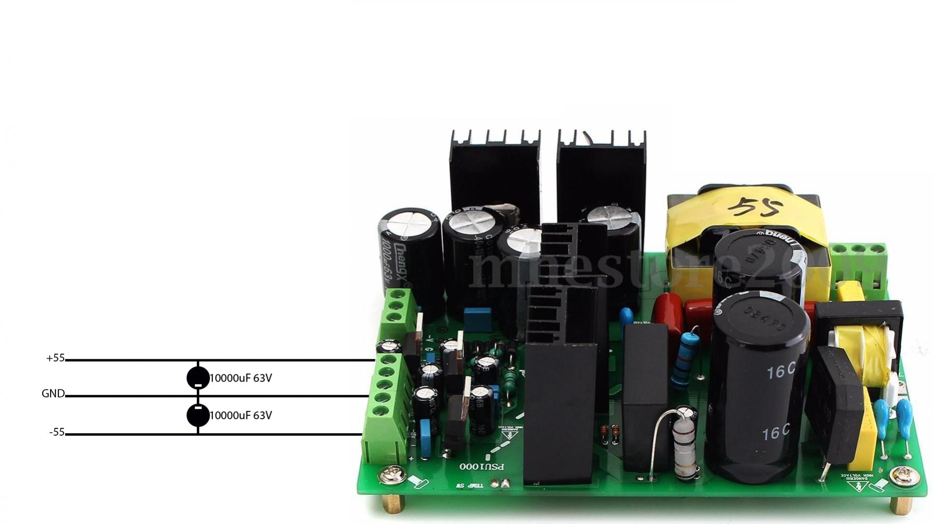

Will try with capacitors first, and keep a look out for bus pumping. I have read a lot of places I might not even get a problem...
Finally figured out why I have to put - on the capacitor to -55V, and "+" to GND.

Attached my PSU with the way I expect the caps to be wired.
Hi Mortenhoe: I just came upon this post of yours about eliminating bus pumping. Two questions: if that is a negative symbol on the caps to added to the output shouldn’t the bottom caps polarities be reversed so the “-“ is on the negative rail? Secondly, did this technique actually work for you?
