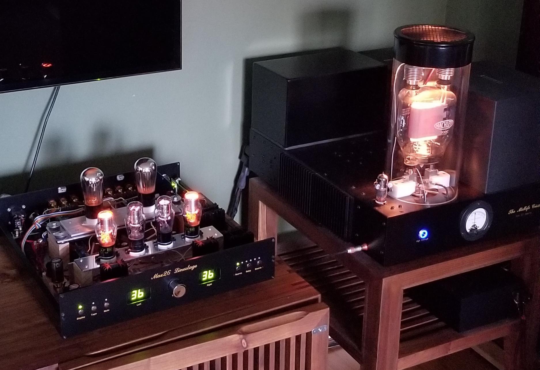

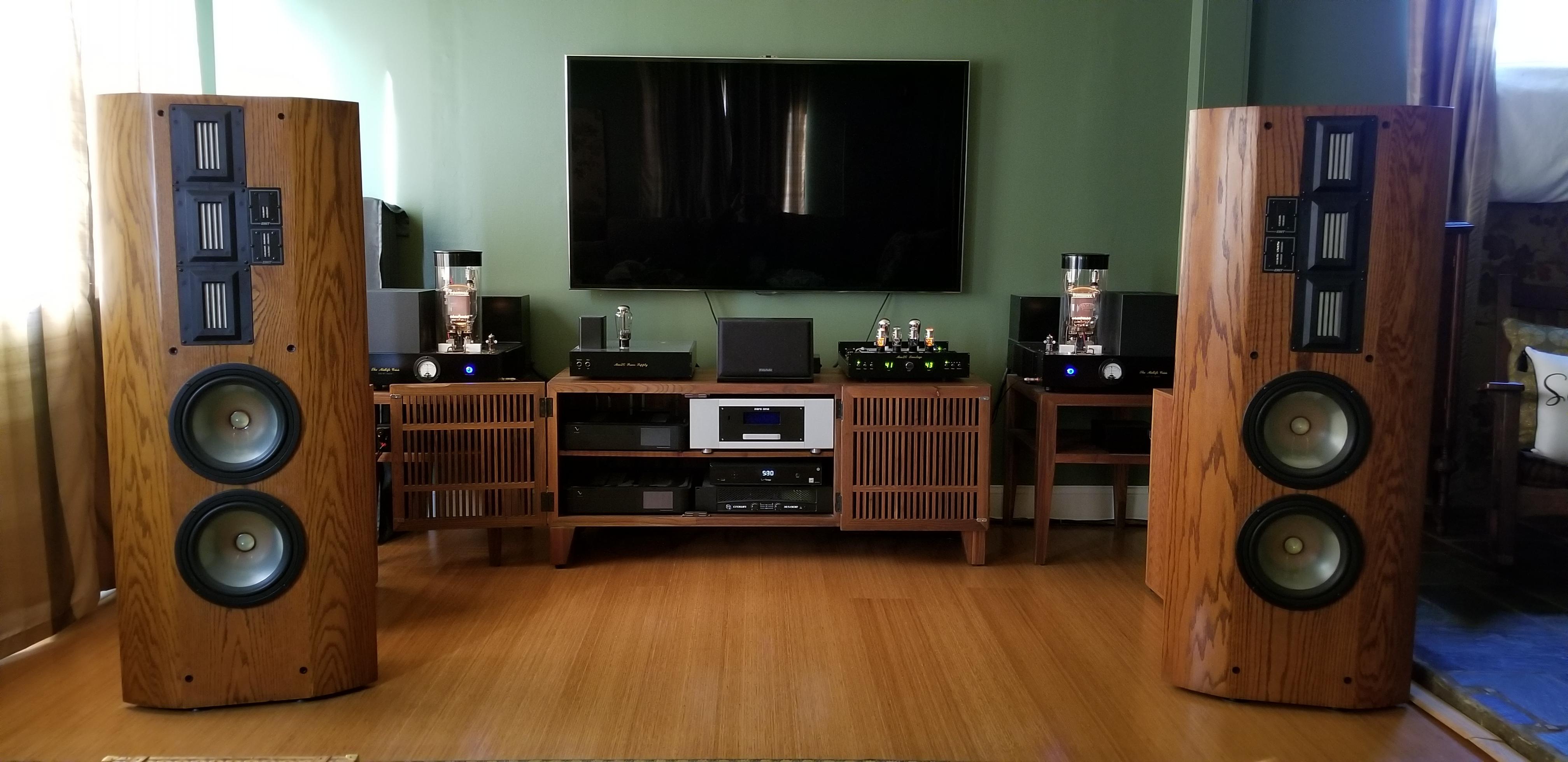

Attached is a pic of the system and one showing my preamp/DAC with the lid off. I designed and built the DAC/Preamp and the mono amps myself. The preamp uses UX-201A directly heated triode tubes (circa 1925), fed from a gas-tube regulated, all choke input supply. The amps are SETs featuring 833C transmitter tubes run at 2.3kV - pure class A1 up to 40W, A2 above that to 200W. From an SET. The speakers are Infinity RSIIb refurbished by me with external passive crossovers.
So, all I came here for was to share my puzzlement at the Burson spec sheet Ib value, and to ask if there was a good reason for it other than pure error. I didn't want to debate about the merits of discrete vs IC or any other religious convictions. I'm a tube guy, anyway, so I couldn't care less except for how it impacts the sound of my lovely tubes.
