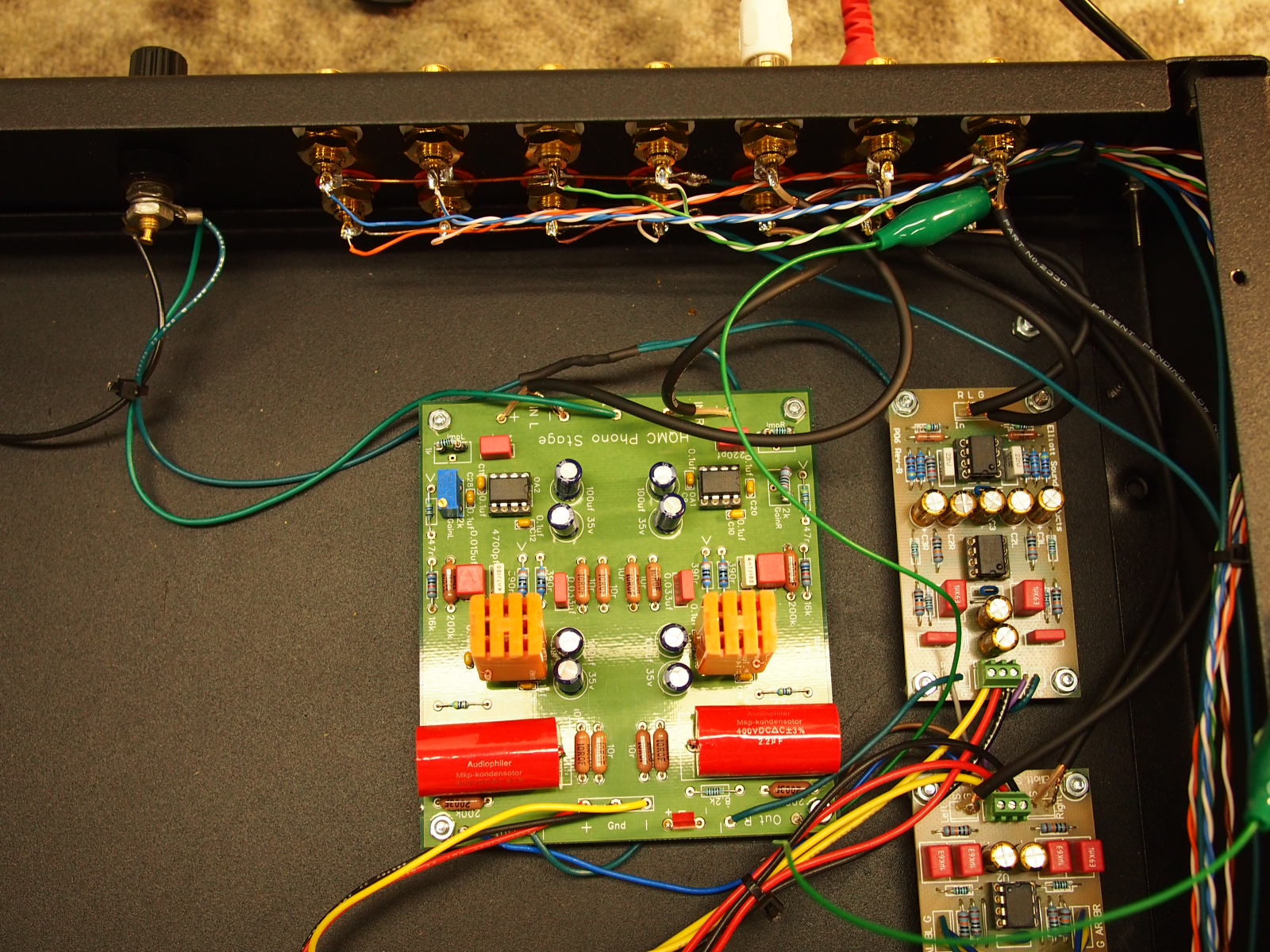

I have been used Burson Supreme Sound discrete opamps in previous projects. I have had success with both the single and dual version, V4. I found them to have a clean and pleasant sound quality.
I recently completed a preamp based on Rod Elliot's P88 PCB. I also used ESP's phono section for the MM input. I was very pleased with the performance of this preamp.

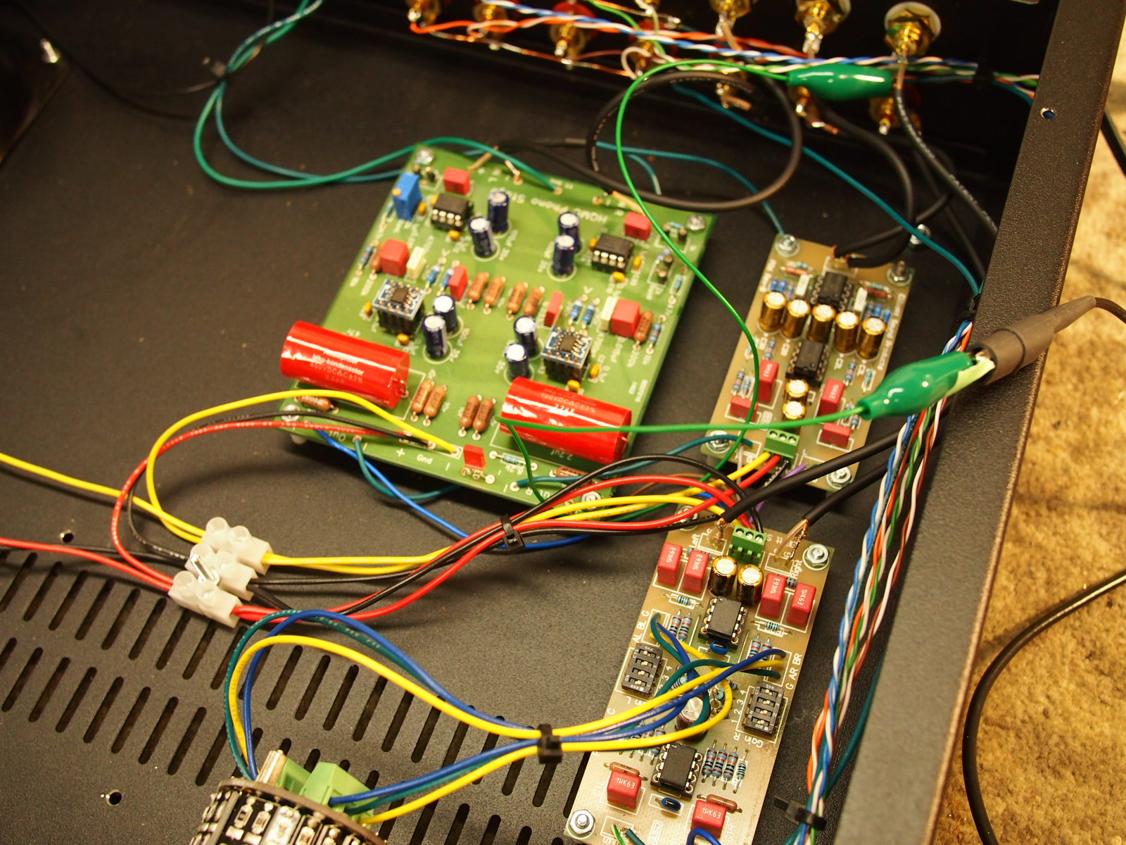

In addition to the ESP phono section, I included an HQMC MC phono section designed by Hypnotoad on AudioKarma. This uses AD797 opamps for the first stage. The second stage seems to respond to different opamps. There is a lot written on AK about the characteristics of the various choices. I have built 3 or 4 of the HQMC previously and settled on the LME49990 opamp. The sound quality with that pairing (AD797/LME49990) is a nice blend of detail with smoothness. For this test I swapped the LME49990 with the Burson V6 Classic(retained the AD797 in first stage). I was pleased with the results. The V6 was very smooth but showed a bit more detail than the LME49990. The Burson are a bit less harsh. It would be interesting to see how the circuit performed with Bursons in both stages. While the difference is not "night & day" it's an easy decision to replace the LME49990. The Burson are very reasonably priced and well made and they do offer sound improvement in my opinion. Unless you have a very shallow enclosure, they will fit.
Just for fun, I wanted to compare the V4 and V6. I believe the V6 offers a bit more detail retrieval or presentation than the V4. It's not enough that I would upgrade V4 to V6 but the V6 is better to me. I hope to test the V6 Vivid at some point in the future.
The first photo shows the HQMC with the Bursons. The second shows the Lme49990.
