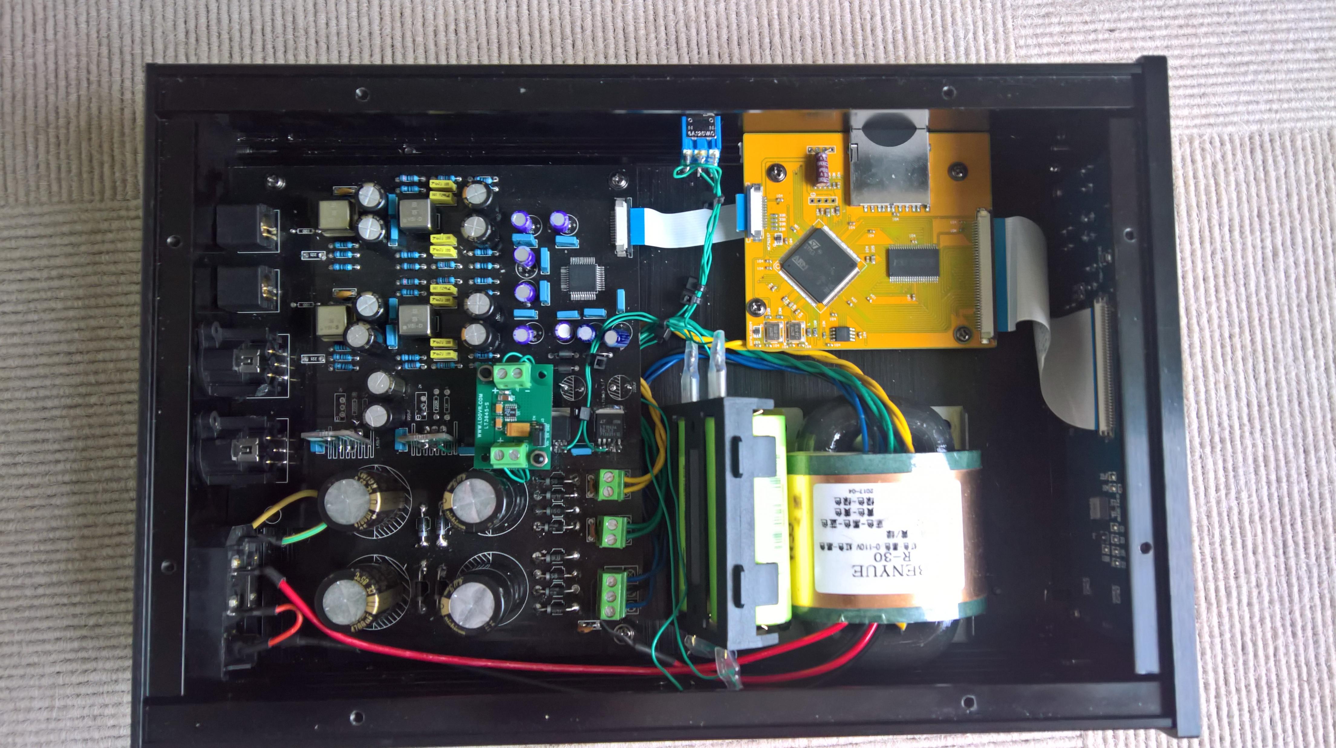

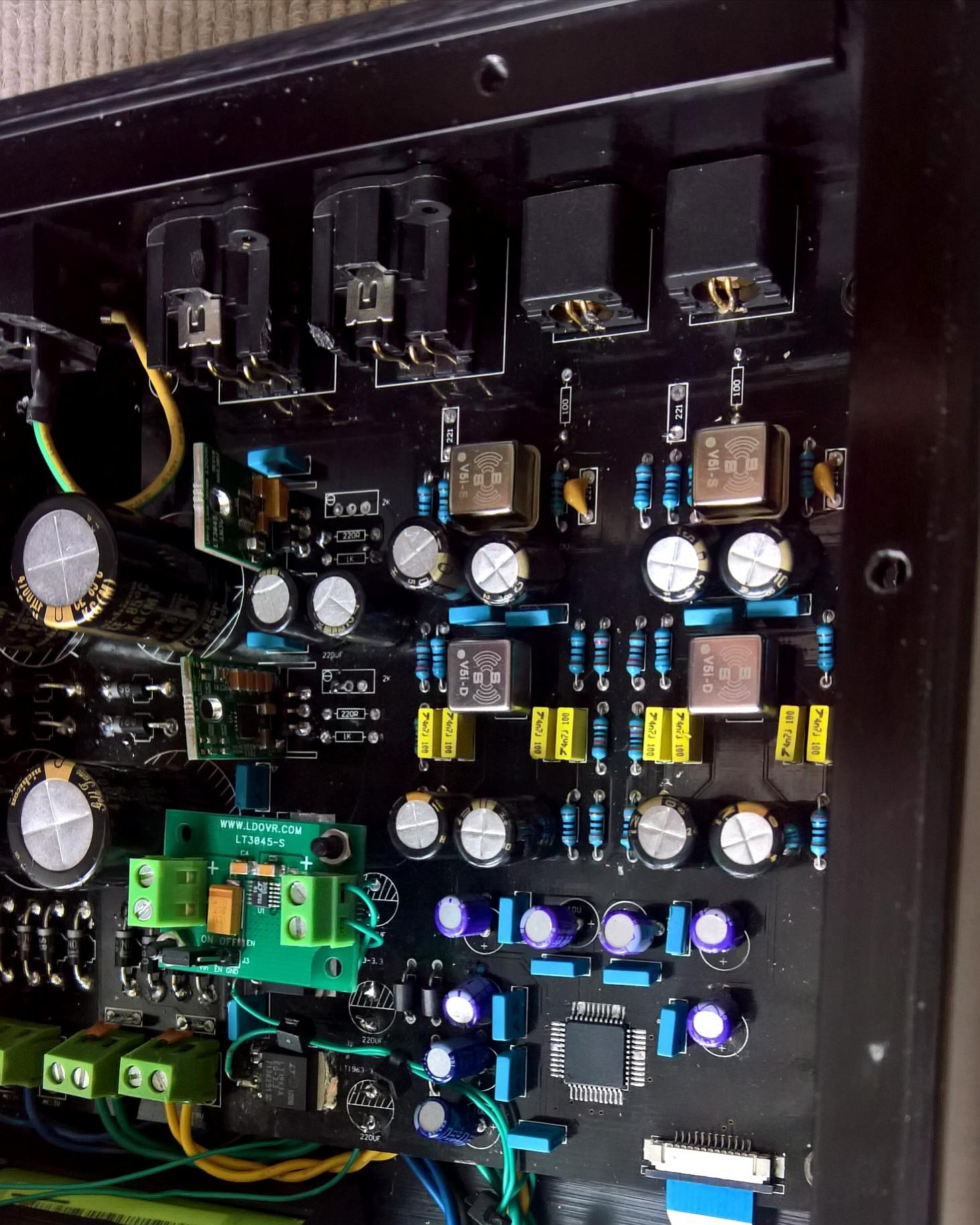

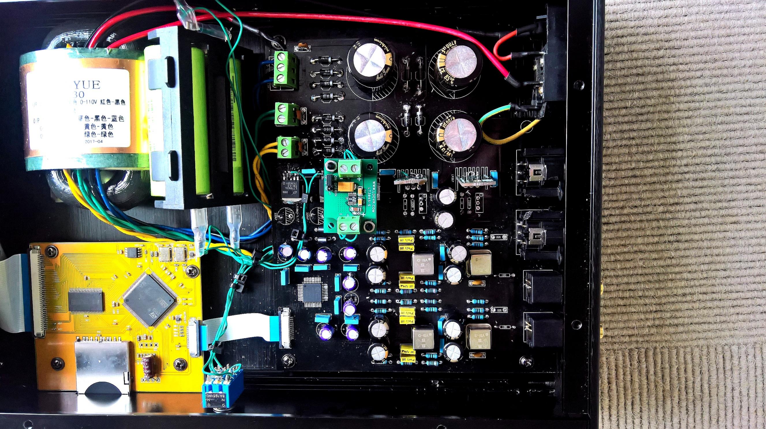

I would love to try Burson opamps for my DIY CNC Phonostage. I am currently using a pair of LME49720 opamps.
Regards
Sachin

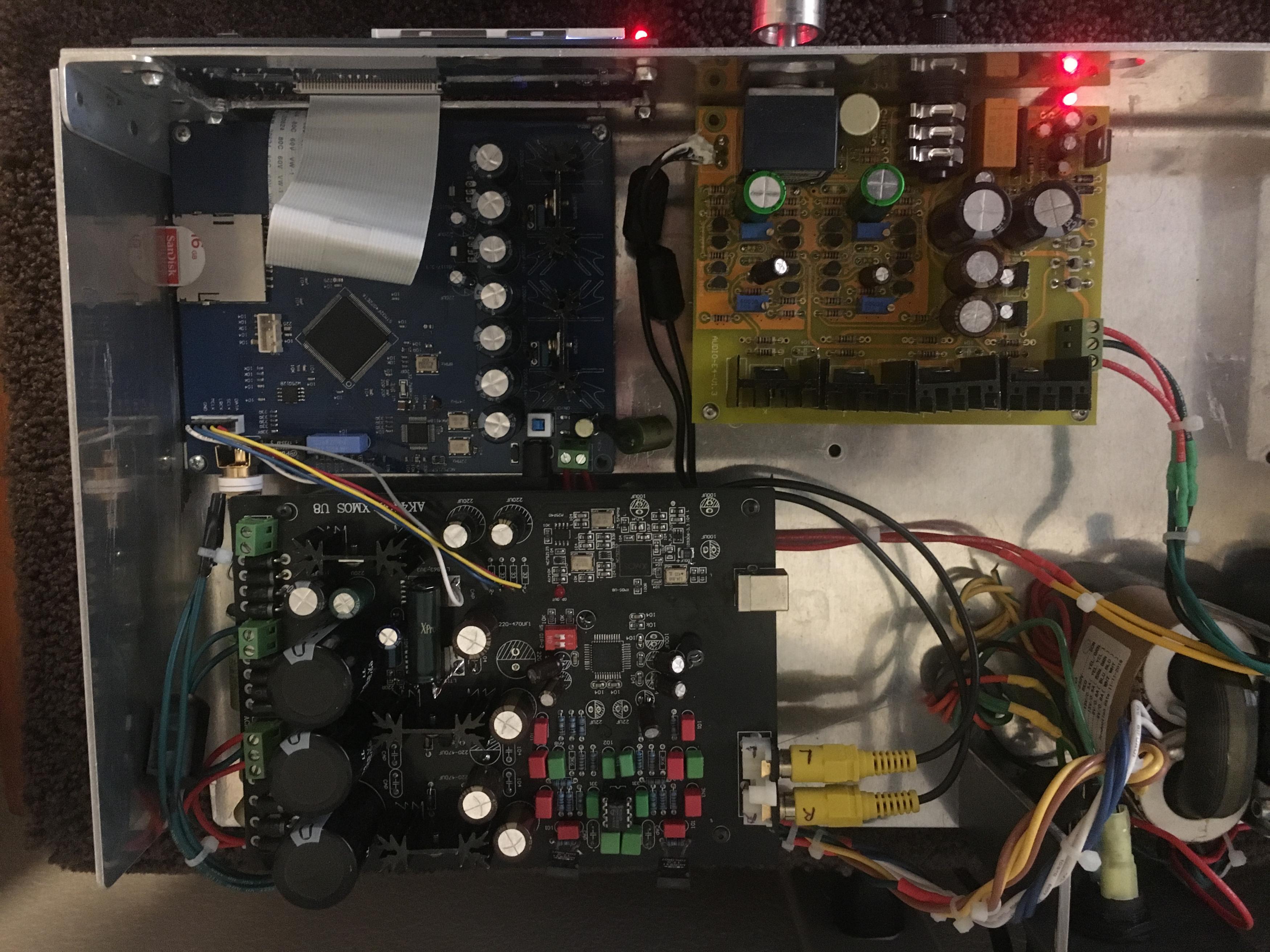

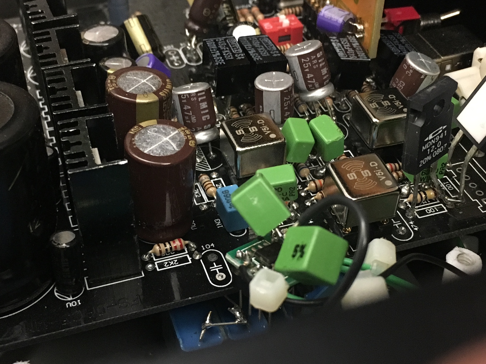

Here is a picture of my digital player/DAC that I put together recently.
I had also tried the lme49720, yet it seemed to work better with ne5532, overall anyways.

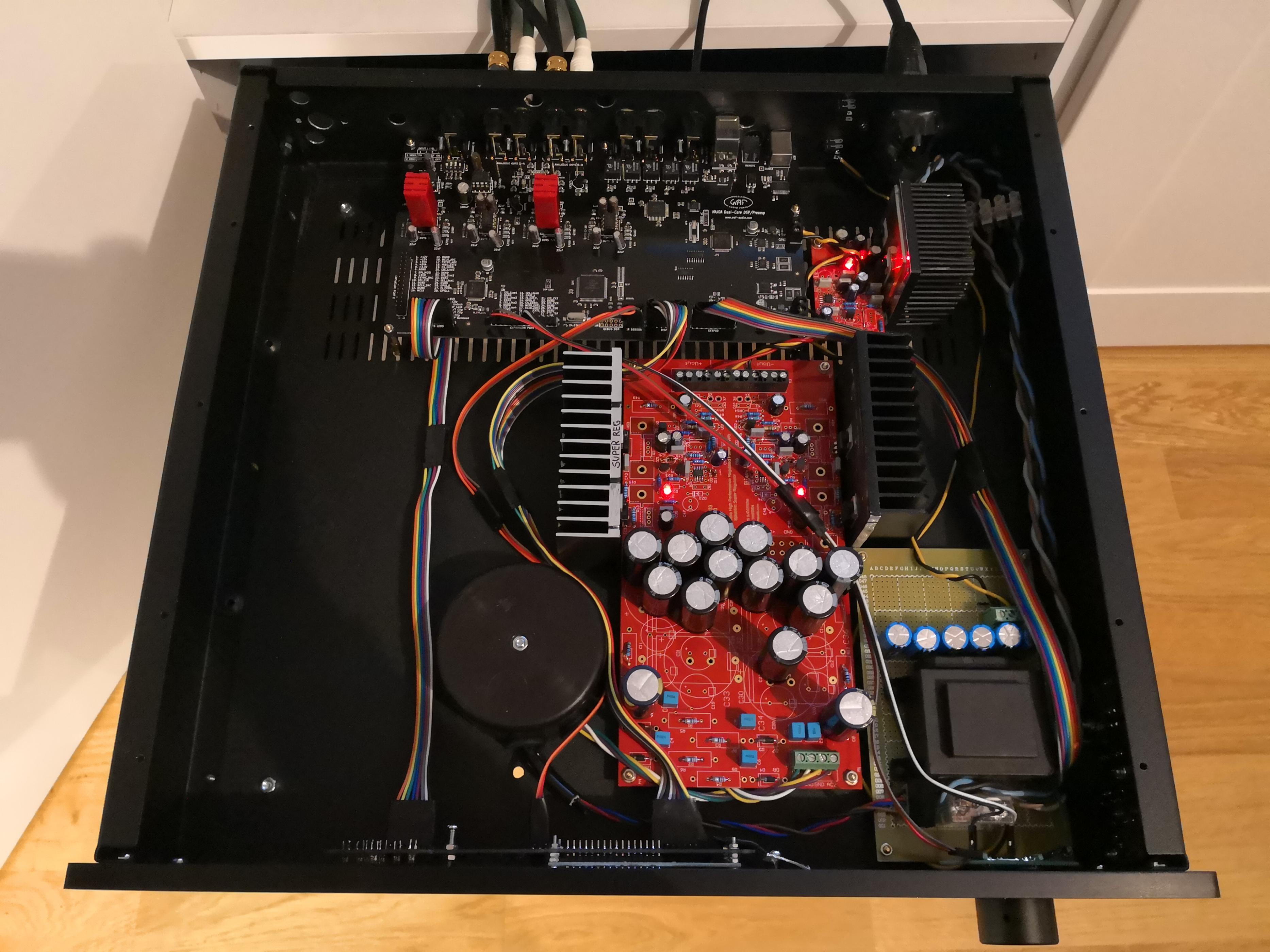

Ok, so I was also one of the lucky guys receiving a sample from Burson, in my case it is the V5i both in double and single version, as required by the output stage of a AK4495 dac in a Chinese SD card player.
Signal is passing a hotrodded DCB1 preamp, which is very transparent, and goes to a tweaked TPA3255 chip amp, or a DIY Pass F5, which are both very transparent as well.
That said, I have to confess that I used to be not a fan of op amps in general, I do prefer discrete circuits or even valves, even though it is often somehow more complex to get it right.
The CD card player came with loads of fake parts, which I almost all replaced. Still the conditions are less than optimal for the output stage, particularly the power supply. LT3045 regulators are on their way, but not in duty yet.(Pictures coming soon btw)
I compared the Bursons with Opa2134 and some other BB op amps, and LM4562 and LME49720. These have quite a different presentation, the BB more on the "musical" side with more flesh and bones, but a tad unprecise and bloated sometimes; and the LMs more controlled, better bass, more extended high freq and overall well balanced, maybe a little flat sounding.
At first the Bursons showed a clear need of burning in for some days, they sounded a little sharp and not very dynamic.
After a week they seem to hit the line between the BB and the LMs, they are well fleshed out in the midrange while at the same time having a pretty controlled bass.
That bass is not as deep compared to the LM, almost a little shy with a tendency to pronounce the upper bass more than the deep bass, and giving especially male voices chest and body. Same for instruments like cello, very full and colourful reproduction, maybe not the most neutral though.
Upper frequencies are a tiny bit recessed and not that extended, but have always a kind of golden shimmer. That makes for a pleasant listener experience in general; i would recommend those for classical music, voices etc, for electronic and other modern genres I actually preferred the LM4562 with its more controlled and open presentation.
Best in my player is the combination of both, with the Bursons as the output buffers. I cannot see a night and day difference between the op amps I tested, but the bursons seem to fill a gap between a more "modern", linear sound and a more "romantic", colourful one. As the prices for, lets say, genuine opa627 are almost in the same region, I would definitely give the Bursons a try.
And, maybe all that will change soon with the better power supply. I will post an update for sure, probably not before my well deserved holidays.
I also built another more simple output stage with only one single op amp, maybe this will make it possible to differentiate a little better.
And...to my surprise I like what I hear from those op amp stage, which is probably also coming from the relaxed playback from SD card. Nice surprise for sure...
And thanks alot to Burson for the fast delivery and friendly contact...
