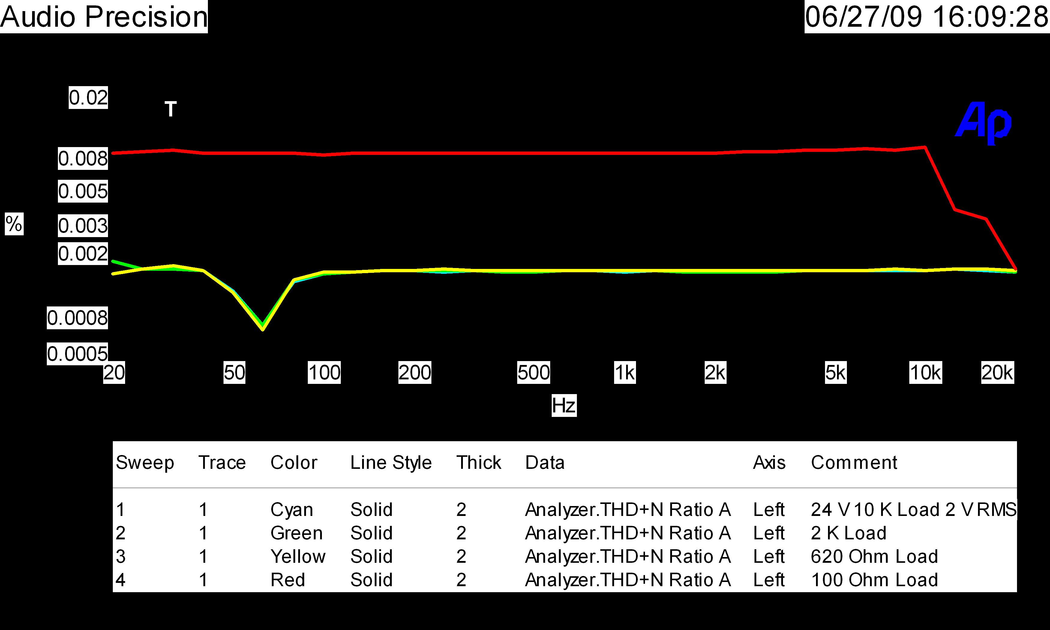

I'm perhaps thinking of trying one out.. Does anyone have any specs about these modules, particularly their input offset voltage?? What about their operating voltage,, the website says from +/-12V,, but how good will they work with only +/-9V ??

IF it says from 12 V than i would take that serious !
No just these.
Ok so there is in fact huge different in THD with different Supplys. Easy to se 6 V is to low !

Someone posted THD+N graphs of the Burson Modules being powered at +/- 6, 18, 24 volts,, and interestingly enough, best (lowest) THD+N was +/-18v,, so I will set my supply to 18v
