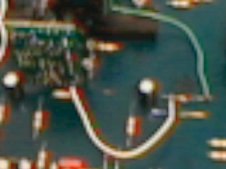

Grounding the Bursons OpAmps
indeed not a great picture 😱 but should give an idea.. 😉

finally , I go time to work back on my machine
I have cut out some plastic frame from the CD player and remove the extension of the Burson amp
the noise problem has been improved, but I still get terrible noise if I earth the amp.
I feel so sad .....🙁
as sad as Bear Stearn
Hi chofaichan,
Since previous monolithic dual opamp serve as current to voltage converter and analog filter, the nearest signal ground is where noninverting input (+IN) is connected, be it from opamp no.1 (or A) or opamp no.2 (or B). So, check with the DVM pins no. 3 and 5, one of them is in direct contact with signal ground, so use that pin to connect separate ground from Burson discrete opamps.
BTW, where you have connected separate ground wire to Burson opamps?
