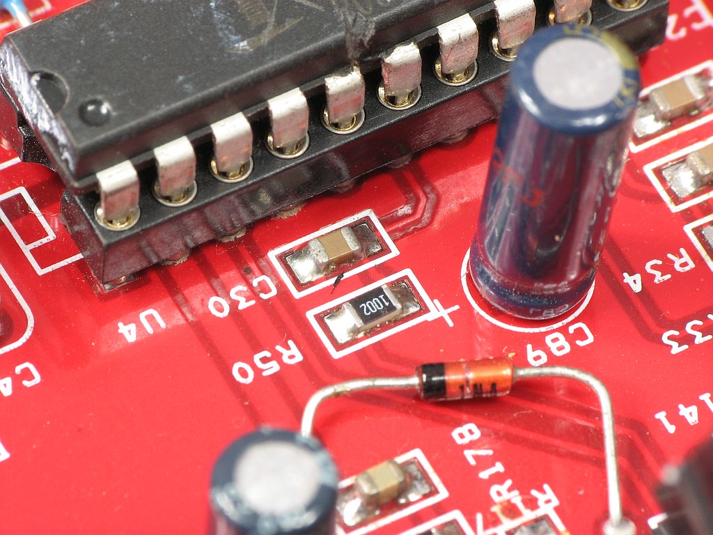

Perry I discovered one of the smd caps labelled c30 near the 4080 ic is cracked completely in half. Am guessing vibration related , no markings on it whatsoever and now its completely out the board because it fell out after moving around the bench. Do you have any idea from the ones you worked with in the past what value it may have been ? Again its the mmats 3500.1
This is a low voltage circuit. You don't need to be concerned about voltage if you're replacing it with a ceramic or film capacitor.
