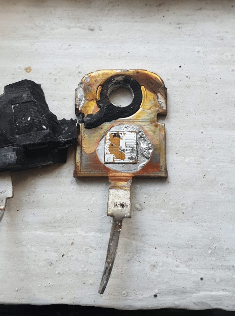

So the other day I blew pretty much all the transistors in my amp with my butter fingers. The one time I decide to set the bias without the safety lamp and I short the rails. lol.

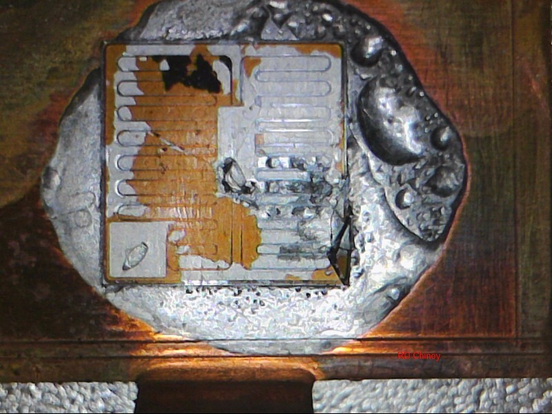

So I had the amp up and running in 30 min. But also had a lot of failed transistors. So I thought lets expose the internals and take some macros shots.

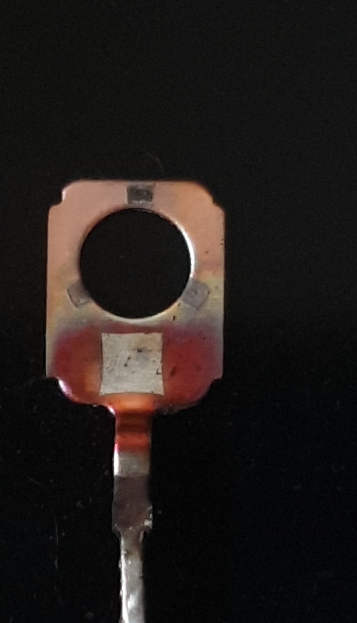

I started with my CDIL large drivers. These were hard to open up. Even putting them on the gas stove did not soften the epoxy. But after doing this I moved onto doing the CDIL BD139 / BD140. This time I found the transistors instantly lit up like camphor balls.
The epoxy was highly inflammable. And once burnt out the epoxy just fell away like dust.
Ive seen hundreds of posts on testing transistors but not once have i read of people talking about analyzing the epoxy used.
I find it strange that a company like CDIL would have two types of epoxy in use. And what their logic would be for this.
Its more likely that the BDs were fake. But all of them worked fine. They were all pushed hard and tested on the scope.
Food for thought the next time you blow a transistor and want to see what's inside.
I use a special brand of araldite Highly dielectric epoxy CY205 mixed with powered glass. There is no way in hell I would randomly change the epoxy I have been using for years.
If you do decide to try what I just did. Be safe some of these light up like petrol. Some explode some pop.
Epoxy molded transistors don’t contain BeO. Some old metal can ones did.
Ive seen plastic transistors bust into flame, and others explode and throw pieces across the room. I’ve been hit squarely in the forehead by exploding pieces of TO-247 hexfet.
Ive also see them crack open, glow orange inside and still be working. I’ve had a TDA2002 IC do that, while still playing distorted music! Once it cooled, it was dead as a door nail.

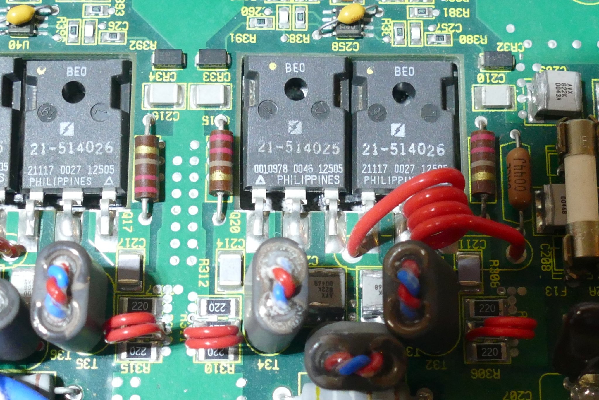

Some molded transistors and nearly all RF power transistors do contain BeO. These TO247 mosfets are clearly marked, but there are likely some out there that aren't. The main issue with BeO stuff isn't from heating it. It is from any operation like grinding or sanding that would create BeO dust. Even small amounts of BeO dust can cause lung cancer if inhaled. I'm not sure that burning off the plastic would generate enough heat to liberate any BeO molecules, but I'm not going to try it either.
Reactions: gorgon53
Let me venture a guess to say these don’t go BCE (GDS). When the collector is bonded to tab it is not needed. Regular BCE transistors are going to be “safe” (well, as far as cancer is concerned. Eye protection may be advisable).
