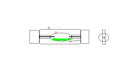

This is a rough sketch of my lamp from the side and end on. Does the spec of HOR +-45° refer to the flat ends where it fits into the holders or the little metal thing at the bottom under thedischarge chamber??

The 45 degree angle is to prevent the filling to condense at 2 electrodes. You can mount it on a rotating grill if you like...
JUST DONT LET ANY OF THE 2 ELECTRODES IN THE QUARTZ CONTAINER POINT DOWNWARDS
