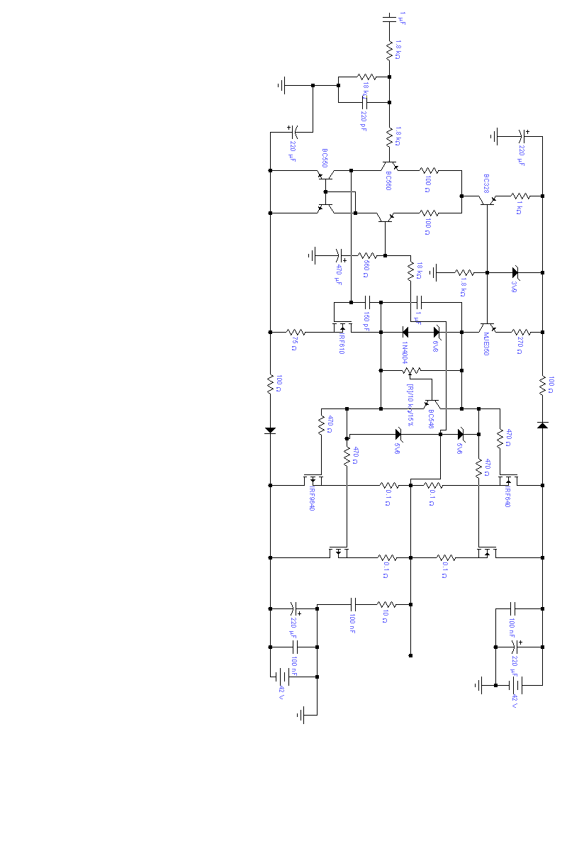

I've built a AB class mosfet output amp using two pairs of IRF640/9640 as output devices.
The strange thing is that the amp has worked, and suddenly it stopped working and smoke appeared in the output mosfets, and they didn't had any shortcircuit beetwen GS or DS or GD!
What can be happening, and how can I solve it.
PS: I have built this amplifier before but with less power and only one pair at the output something like three weeks ago, and it is working fine, the only changes are some different resistor values the aditional pair and some zener protection diodes.
Need lots of help.

It was stable, no doubt that. The problem was only on the output, the rest of the circuit is ok. I used 0R10 source resistors.
I don't know how to match mosfet, becouse I'm only a begginer so I used different dissipators for them. Could it be a mistake in the zener's protection value?
Here
I don't see any Gate protection for your IRF610 coming
off the diff pair. When you clip the amp, the gate can
be driven to supply rail values, and will often break at
40 volts or so. Maybe a nice 10-15 V Zener from Gate to
V- would be a good idea.

olá Diogo 😉
the way that the pot (10k Ohm)
that change the bias setting in your schematic
is implemented, is dangerous...if for a malfunction of the pot the wipper make no contact with resistitive part of the pot...
the output mosfets will see a lot (maybe too much) bias across they!
Maybe can be that ,that have kiled them!
Regards

Yeah, always put the bias pot Base to Emitter. Why not
try using a Mosfet like an IRF610 or so for the bias device?
That way the gain will only need to be about 2 to get
the correct value, instead of 12, and the bias adjustment
will be a lot less sensitive.
:bigeyes:
I found the main problem!
The main problem of the amp is the bias adjust stage, The amp worked well using a single trimpot to adjust the bias, so can anyone help-me design a good bias adjust for that amp, the suggestions of nelson pass did not worked.....
I see another possible issue here:
The addition of the second pair of transistors is what is causing the problem. Remove them first. Maybe they're 'overloading' the bias stage. I would change from the BC 546 and implement probably a Darlington pair, to maybe add to what Nelson said, and increase the sensitivity and enhance the ability of the bias stage to drive two output stages.
The other is the transistors themselves. They should be rated to take full rail voltage, not just one half of it, in an ideal situation. When one half of the output is locked into conduction and will show full voltage across the other half.
Sang
