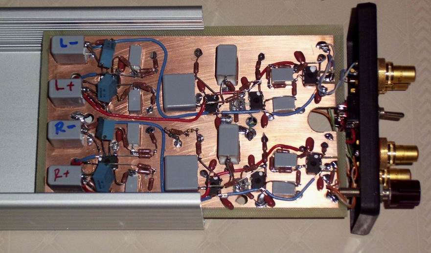

So I'm starting this thread to get a couple of designs together that can be put together easily. I figure that some F4 type follower systems will be the easiest, although there's no reason that we can't explore other stuff.
I've always wanted to hang some output followers on a BZLS. Maybe that will end up being one of the other things explored?
JJ

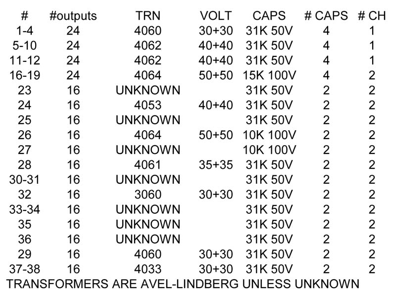

So here's the list I have of the amplifiers, keyed to the number on
the amp. If you lost that piece of paper, you will find the number
on the floor of the amp on a Dymo label.
The list is not 100% accurate.
If the devices on the amp are *ALL* IRF240 or IRF244 or IRF230 then
you have what we will call SE for single-ended.
If they are a mix of IRF240, etc and IRF9240 or other "9" types, then
you have what we will call COMP for complementary
If they are MJ part #'s, then they are BIPOLAR.

Nelson: Your chart for #26 is wrong ... xformer should be 18+18 (Avel model AT7 D4030).
But that's OK. I'll just get a bigger one for my project = no worry, mate.

FWIW, #28, a Comp MOSFET unit, and has no transformer thought the spreadsheet indicated that it was a 4061.
#35, a bipolar unit, with transformer indicated as unknown, has a 45+45 transformer from Cotswold Electronics Model D1054. I can't seem to find any info on this one at all despite multiple searches of every combination I can think of.
Have a great evening!
