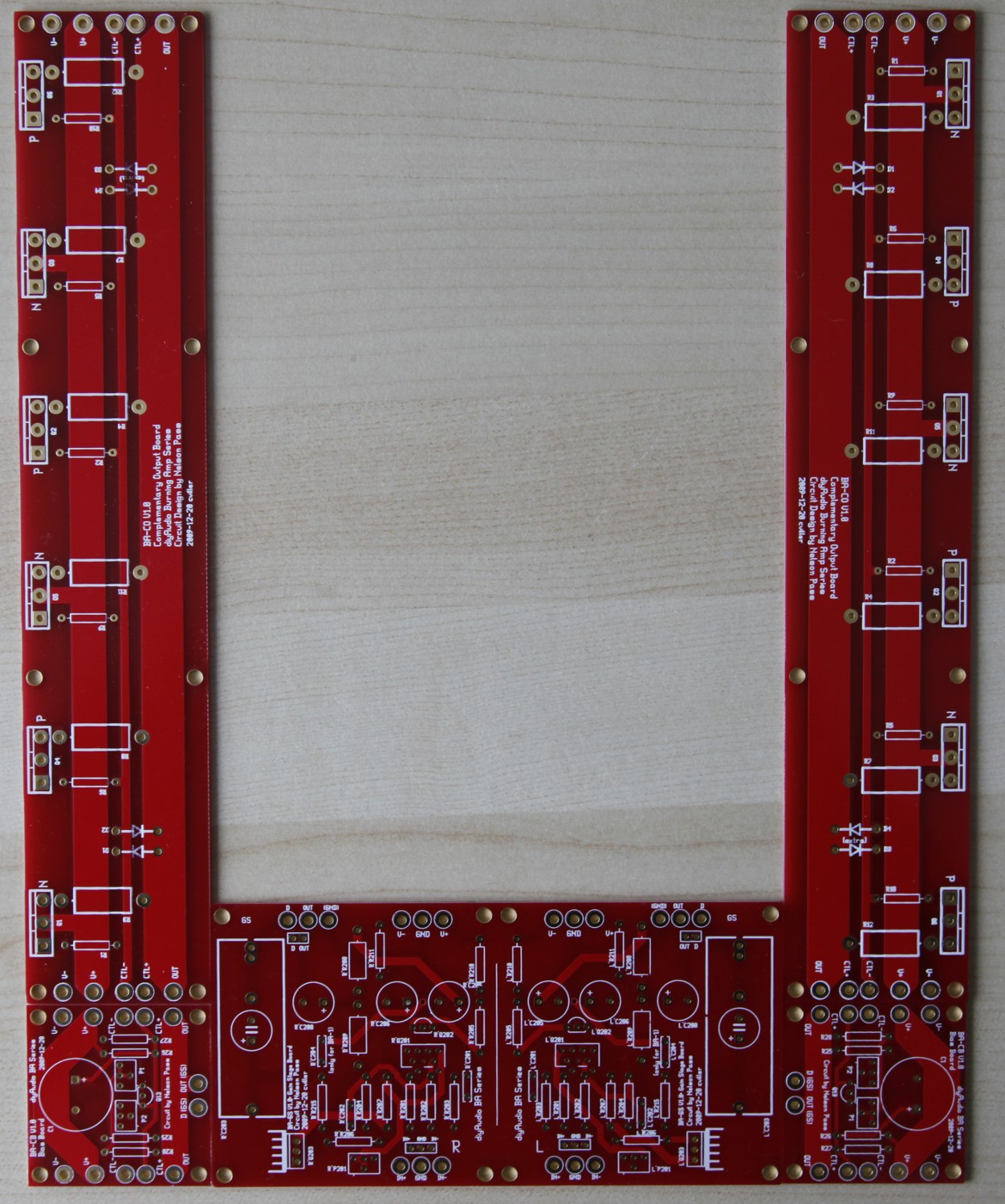

They are pretty versatile. Why not just use 2 output driver boards hooked to one bias board? One output board on each side of the case? Is there any reason that it is better to have all NPN on one side and all PNP on the other? I wouldn't think so.
If you only want two pairs per heatsink just don't use all the MOSFET mounting holes. You can also cut the output boards shorter if having an empty area without MOSFETS bothers you. The boards have connectors on both ends so they can be cut to be symetrical. If you only want one pair per side of the case, you could cut one output board into two short , symetrical ones- you wouldn't even need 2 boards..
Hmm, they are actually the same, arent they
I mean, only difference is supply polarity
All other components and connections are the same
Not sure, but wouldnt it be possible to mount a one channel BA-2 board with all NPN or PNP respectively
And supply both the positive and negative power supply board lines with either positive or negative respectively
Sure looks like that to me
Or have i overlooked something ?

Keep us informed. I'll forward to JAson who whipped the store into shape. The voltage gain board is the same for both amps, and the people with a Burning Amp Festival chassis don't need the output boards. The voltage gain boards will fit in the chassis from the Burning Amp Festival, verticall right behind the front faceplate, but Nelson recommends that it be in a separate box for the small chassis, but if you are clever you could get it in there - smaller format power supply caps would help a lot..Having the voltage gain board outboard in any of the amps increases S/N and makes swapping out the board easier if another gainstage design comes along
I ordered a BA-2 Set too, but wondering why schematic ist with 12 Output
Devices and Board with 6 ?
regards michael
In the article papa says that here is no need to have so many output devices - most would be ok with two or three pairs. If you want to use 6 pairs, you can order double the number of output boards.
