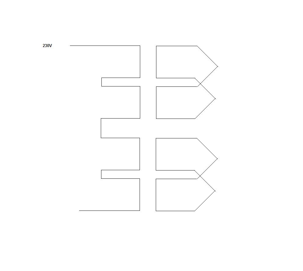

I’ve found four transformers specified to 115 or 230 V primary and 2*35 V secondary, 2-300 VA (aprox). I´m pretty novice when it comes to electronics and therefore I might ask very naive questions.
Could I make these transformers work in the PSU for the BA2 by connecting the secondaries in series? Would that give me a secondary AC voltage of 35/2=17.5 V?

I'll assume your mains is 230 VAC Forsman.
I think not the secondaries, I wonder if you connected the primaries of two transformers together, would you have 4 AC secondaries of 17.5 VAC.

Not sure it can be treated as one 600VA in this configuration. The limit is the current that can be drawn through the secondary winding.
300VA, 35VAC x 2 => 300/35/2 (4.2857142857)A secondary winding limit.
300VA 18VAC x 2 => 300/18/2 (8.3333333333)A.
It is like overclocking a CPU, it is hard to tell how much current it can safely pass beyond what it is designed for. I wouldn't push a toroid beyond it's specs for long term safety and reliability reason.

to be sure that you always have identical loads for both xformers - primary wise - combine (parallel) their secondaries - secondary 1 from xformer A with secondary 1 from xformer B ;
same for secondaries 2 - s. 2 from x. 1 with s.2 from x.2
but - parallel them after diode bridges , to prevent any current hogging in case of slightest difference in secondaries voltages ;
so - one bridge per secondary

what's your intention - to use 2 xformers per channel ?
give us lam dimensions , so we can calculate what's resulting VA of each
The seller tells me that they probably are rated 200-300 VA each. I’m not sure about the lam-size but a not so qualified guess would be lam-248. That figure is a gestimation from the picture. I haven’t got hold on them yet so I can’t measure them.
Because I’m not sure of their VA specifications I’m thinking if I use two of them per channel I probably have enough VA even if they should turn out to be rated 200 VA.

point is that you'll have just half VA of each of them
that's always the case when you are feeding xformer with just halv prymary voltage
so - be sure what you have , before paying them
BA amps are VA- hungry
Aha, in that case they need to be at least 300 VA or I will not get enough VA in the end. I’ll look in to the transformers specs better before I purchase them.

you may want to make the mounting of this brick flexible in the sense that you can adjust its orientation. These EI-types have quite some stray fields that could make problems (that are often solved by rotating them by 90 degrees or so).
If you connect two transformers in parallel or series you may have problems if there are differences in their impedences. This could result in overloading of one of the pair.
If you connect secondaries in parallel you double the current whilst the voltage remains the same.

Now the transformers are tested to see how they perform in reality.
With 2 transformers with the mains (230 VAC) in series and the secedaries in parallel with pure resistance as a load (not sure on how much) we get the following figures:
The numbers above are measured on 2 transformers and I have 4 available.
What is your take on this?
Kind regards
/Forsman
- 20.4 A - 15.7 VAC
- 15.6 A – 16.4 VAC
- 11.1 A – 17.1 VAC
