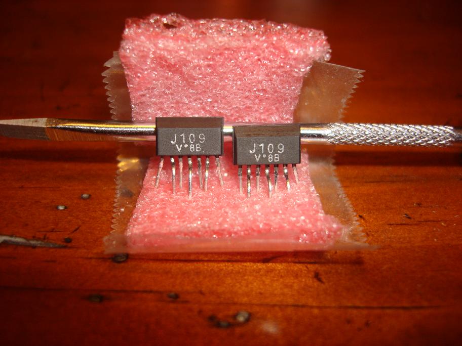

I bought two 2SJ109V's of Ebay (I know this is risky) from an USA source. I'm using the attached circuit to test the IDSS of them. I'm using a fluke 77 meter set to the 300ma scale. On one I get numbers that are 60.2 and the other is 59.8. This seems way high as the v series should be 10-20ma. Am I doing something wrong or have I been duped? The parts look real, and like they came out of a piece of equipment as legs are short like they have been cut out. Probably be another week before my 74bl and 170bl show up so something to compare them to.

The parts look
Chad,
they look like the fakes i got from A'af, and like the counterfeits i received through the group buy at the French HCFR forum.
Shiny legs and the even numbered ones are folded at a larger distance below the case.
In both cases, the fake ones were relabelled matched dual BJT Toshiba 2SA1349/2SC3381.
Also obsolete, with a steep NOS value in the west.
(unfortunately for moi, i bumped into sources in Asia that offer the matched BJT items for less than 50 cents)
each 2sk109 contains two jFETs.
Identify the legs and then measure one jFET, then measure the other jFET.
Do the same for the second k109.
I prefer to replace the ammeter with a resistor and then set my DMM to read DCV.
What size resistor do you recommend. I did measure both sides of the supposed Fet. They measure within about .5 ma at right around 59 ma depending on the temperature. I wish my 74's would get here so that I could compare them. I knew I was taking a chance buying the 109 but I really want to build as Neslon had intended. Another lesson learned the hard way. I want test them using Andrews method once more before I tell the vendor I believe he has fakes.
I have few 74's coming and 100 of the k170 in bl grade so should get proficient in matching.
Chad
you could use as low as 1r0 for the drain resistor. But you would have to be careful not to take the jFET overvoltage.
I would use 100r, that should drop between 600mV and 1200mV for BL grade jFET.
If you have a higher supply voltage for the testing you can increase the drain resistor to 1k0 or more.
Use the DMM to measure the voltage drop and then convert that mVdc to a current using I=V/R.

Yes, measure them again according to AndrewT's method.
Hopefully you have made a silly mistake in the measurement, but it is not looking good.
I have a fluke meter and it gives very accurate current readings. I have tried it measuring both ways and the error is well below 0.1%.
Fingers crossed you have made some sought of silly mistake in the first measurement.
Well doing it Andrews way unfortunately gave me the the same numbers. I've purchased fakes. I e-mailed the seller to let him know and asked for refund. We will see how he responds. Luckily I have some 74's that I can finish this project with. Any one know the status of Linear Systems 74's so this won't be in short supply any more?
Well good news, vendor immediately return the price of the 2sj109's and shipping to my Papal account. Lesson learned about buying semiconductors on Ebay. Seller had 99.8% rating. I dont think he realized what he was sold. I now believe the 109 is a piece of history in the diyaudio world.

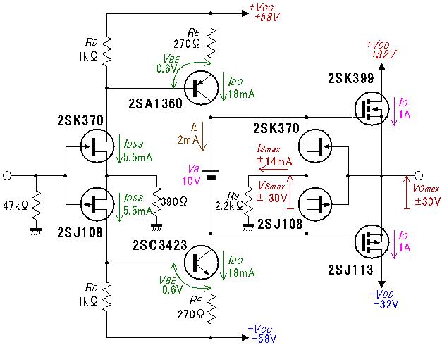

2SJ74 / 2SK170 replacement
We don't need to be scared, Toshiba has already launched successors for J74 and K170 type JFET's in slightly smaller packages but with the identical chips and the same pin outs. NP is aleady using these types.
2SJ108 replace 2SJ74
2SK370 replace 2SK170
Please ask your dealers.
Unfortunately for the dual JFET'S 2SJ109 and 2SK389 no successors exist.
But matching is quit easy using the methodes described in this tread.
