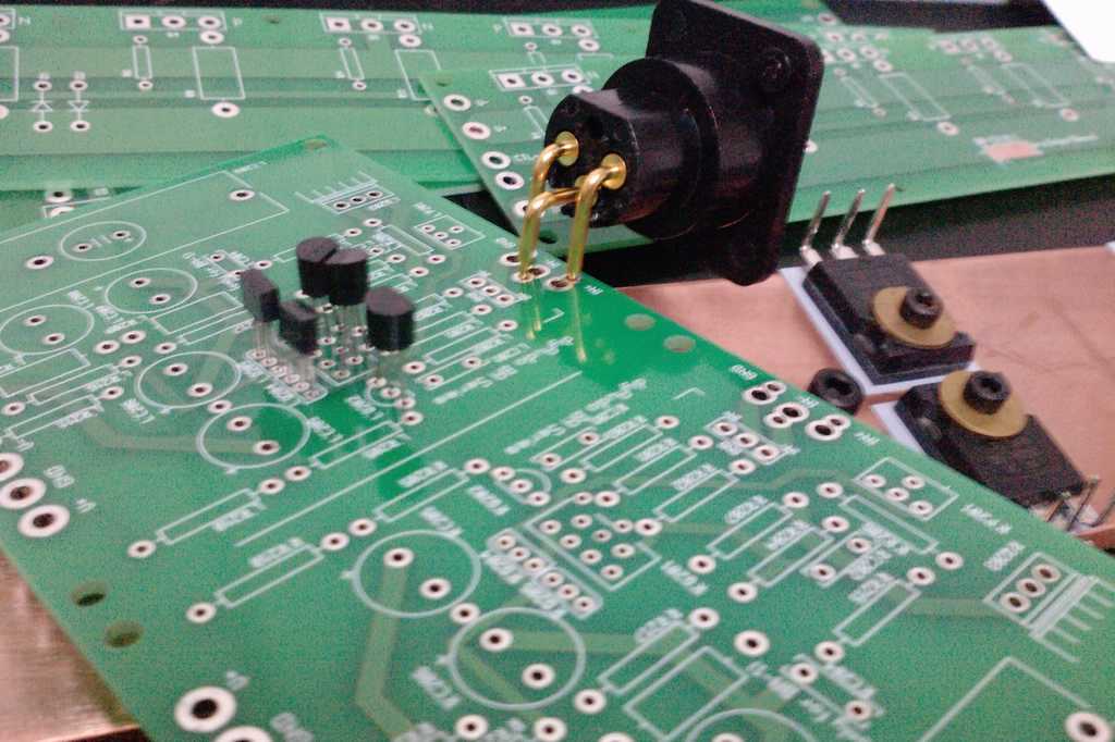

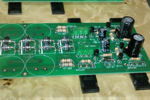

My BA-2 front board with cascade input.
So cviller added the cascode option to the board (I couldn't remember what happened about that)?
Where did you get those washers on the mosfets from?

Its been a while since I built an amp, just ordered the boards from the store. Last time I built and amp was back in like 2001. Had to take a DIY audio break, as 3 kids consumed all extra time and $resources$. Looking forward to building a new heater for my listening room, wait I live in Florida, Nelson could you make amp that sucks heat out the air please. I find myself loosing sleep again at night thinking of different circuits and mods. Time pull the heatsink extrusions (those chunks of metal) as my wife calls em out of the corner of the garage.
Now to find, beg borrow or steal a some elusive Toshiba 2SJ109. Any one have some laying around that aren't needed?

The input JFET pair should be matched. Maybe not an exact, very close match but, not just purchasing 2 (per channel) off the shelf devices. I would suggest chasing down Blues or someone with a copuple matched devices for sale at a reasonable $$$ for a good start on your amp. it's a good place to spend a few extra bucks
I'm going to use two 2SJ74.s to replace the one 2SJ109. I found some 2SJ74's at MCM Electronics they are GR classification with IDSS of -2.6 to -6.5ma but they should work in this application.
Yeah, tracking down the 2SJ109 is really tough. We assumed that most people will use two discrete JFETS. They should work..
