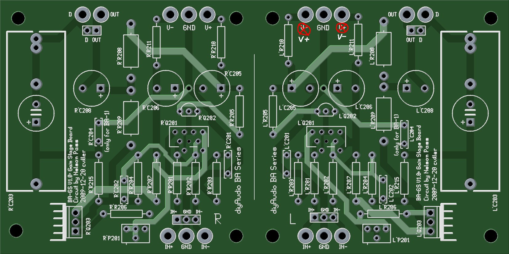

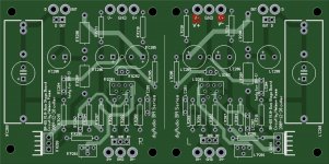

Yesterday I got the boards:😀
BA1&BA2 - Windows Live

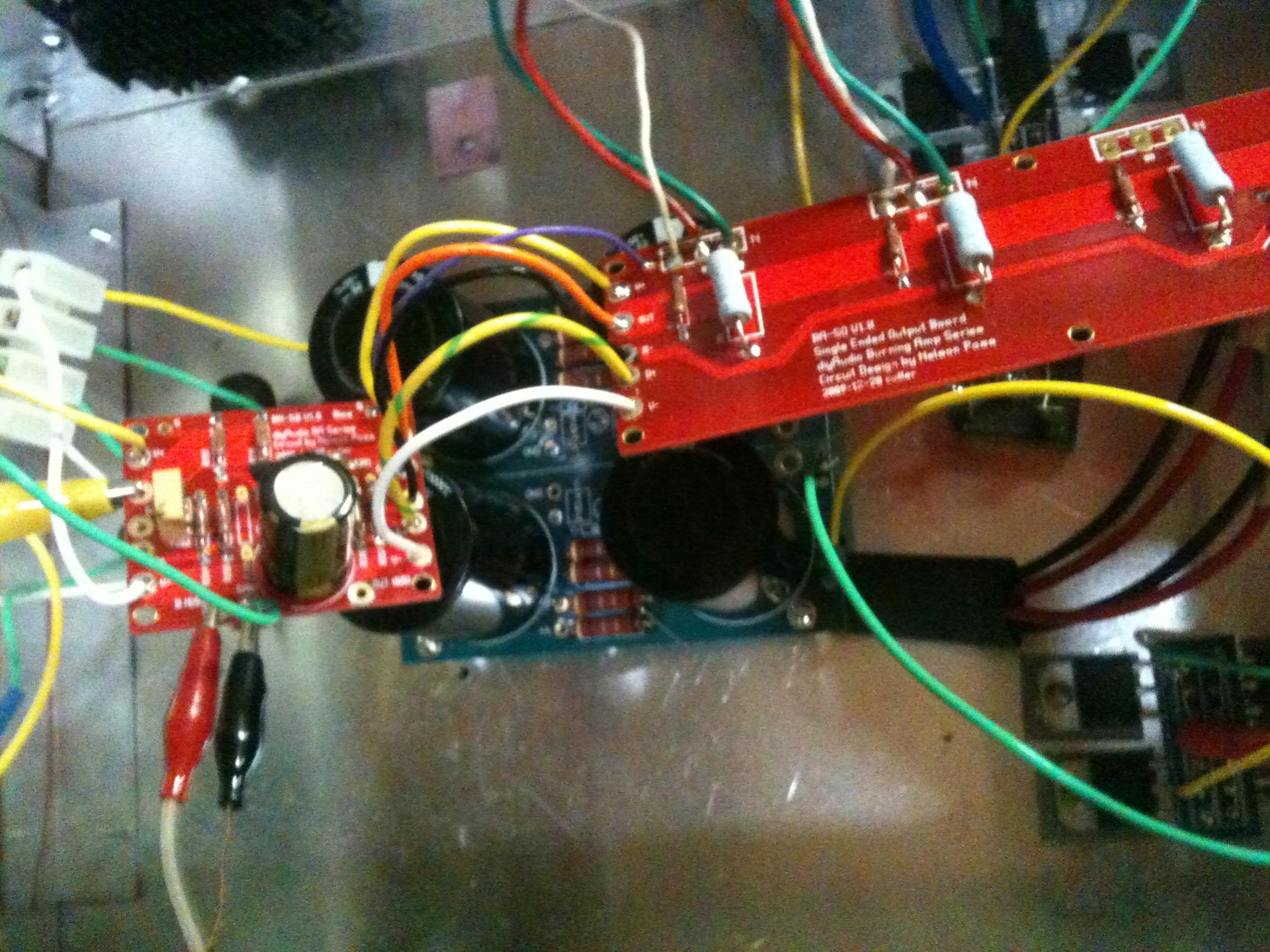

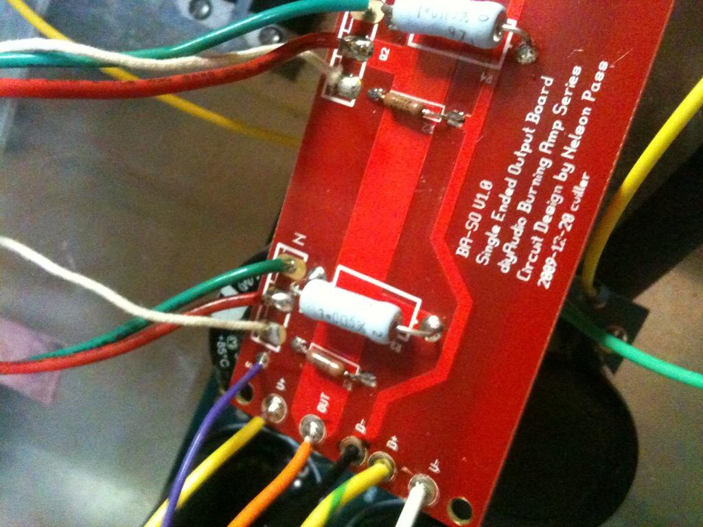

Well, I got the follower up and running with two FET's. Seemed pretty simple to get rid of DC offset like this, but I didn't have it powered up too long.
Well and without the gain board there is not much gain.😛
I think lowering C203 will act as a high pass filter. But I am unsure of the Resistor value associated with it, possibly R14. I was shooting for 180-200hz for my lowthers.
Popped a Semisouth into the Q101 position, and was able to stablize bias with the fixed Q102 .6v.
Time to get a front end built.
