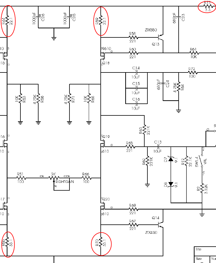

There is both a set of 22,1 ohm and a set of 33,1 ohm - but in each half of the circuit is also a 3,3 ohm, which is the first resistor after the DC input.

They are 22.1 (twenty-two-point-one) and 33.1 ohm resistors. And a 3.3 (three point three) ohm at the DC input - Guess Kristjan K did not use the official notaion when doing this schematic. I have attached a portion of the official schematic that shows the same resistors. To me it looks like that the PS traces are seperate between channels, so I just connect one side at a time.

OK... so it works out like this,
PSU 60 Volt ac transformer gives around 85 volts DC input to the reg. 7 times 9.1v zeners is 63 volts less the gate source drop across the FET in the PSU, say 4 or 5 volts. So the PSU gives 60 volts or so output with 25 dropped across the FET (85-60)
The amp has a 33.1 ohms resistor as the element that defines the current flow in one side. The ZTX transistor turn on at around 0.7 volts B-E and holds the current in the chain constant. So the current is 0.7/33.1 = 22 ma. That gives a dissipation in the PSU FET of 0.55 watt or 1.1 watt both sides running. So yes a small heatsink should be OK.
So you have to now get one side to run OK, and that means totally removing the ZTX500 and the 22.1 ohm on one side only and also one of the 100 ohm that go to the preset pot.
The side that's left "should" power up and run with 0.7 volts across the 22.1 and 33.1 resistors.
I would definitely use a low wattage bulb in the PSU primary and have the meter connected across the 22.1 ohm as you power up. If the voltage goes over 0.7 switch off immediately and then you have to get technical with faultfinding on it :) easy...
