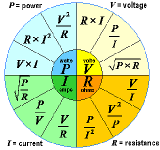

Jim,Vo(peak rms)=square root of Po times RL.
Po=I squared times RL, and Irms out = square root of Po divided by RL.
So if we have amp with Po = 100 watts into 8 ohm resistive load at frequency of 1 KHZ then Vo (rms peak)=square root of 100 times 8 or 28.28 RMS volts peak or 56.57 peak to peak rms.
The current into the 8 ohm load will be 3.54 amps RMS.
Now if we change the load to 4 ohms the voltage will remain the same 28.28 volts rms peak, so Po=28.28 squared =799.76 divided by 4 is 199.94 watts. The current will be 7.2 amps rms.
you were doing really well prior to this point.
No, that's square root or 100 times 16
P= (Vo / 1.414) * (Vo/ 1.414) /Rload
P= (Vo x Vo) /2Rload (this is the formula to remember)
Which gives 40V for 100W
As pointed out your peak and average and rms etc seem to have got us confused.I think we want to avoid the phrase "peak to peak rms"
