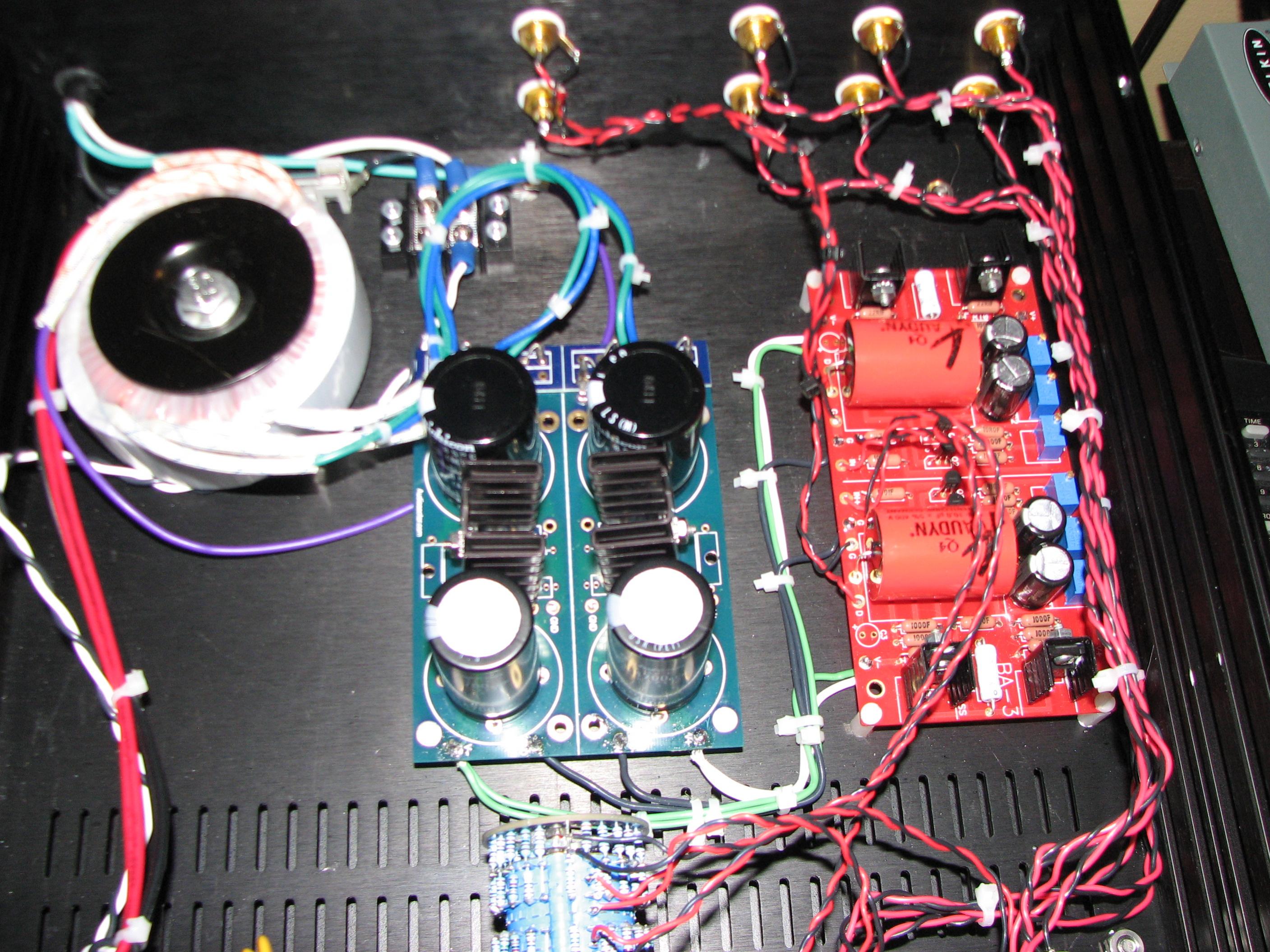

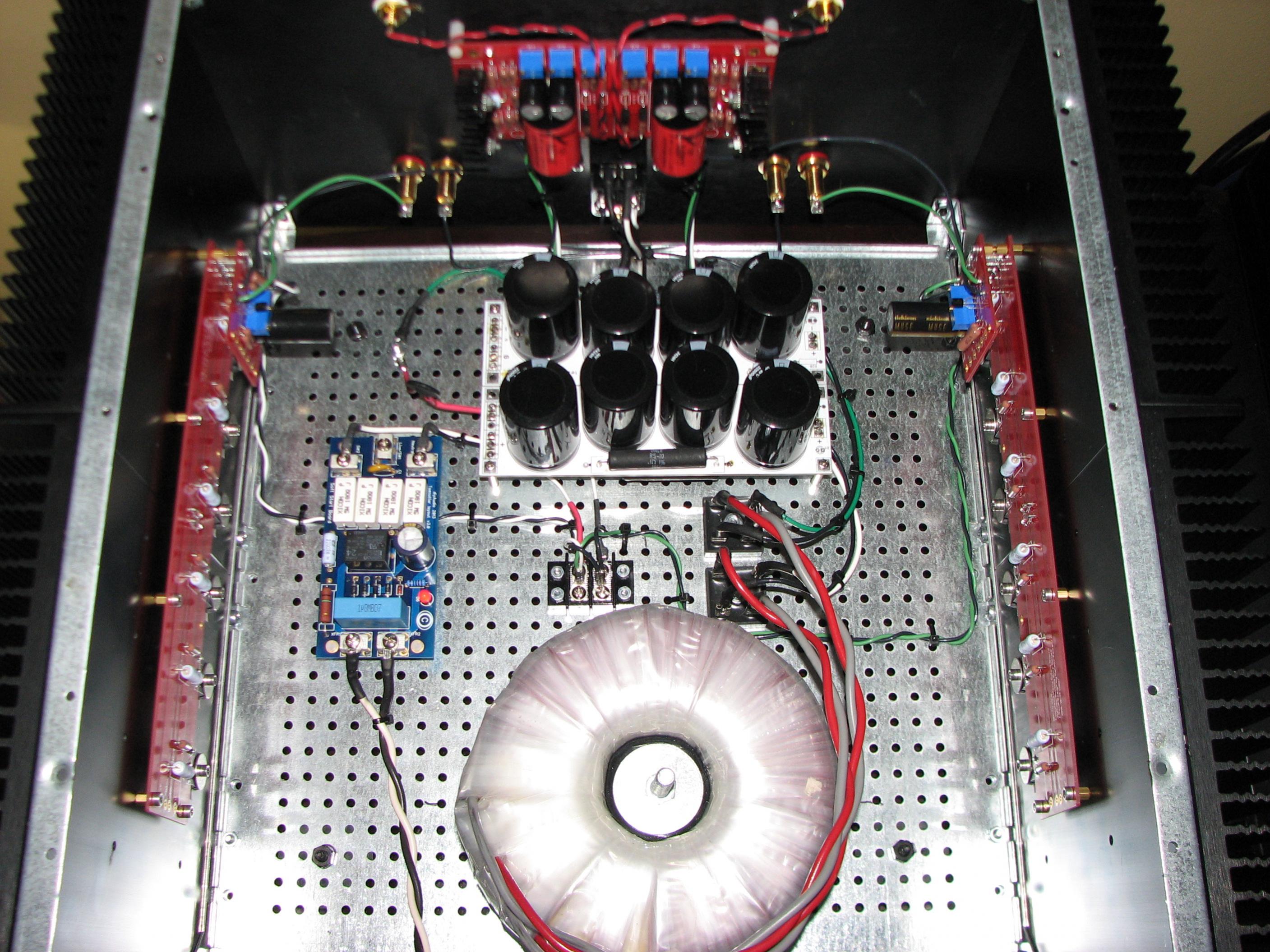

Check 6L6 build thread its just like that. Its not the size of the box, its the heatsinks, which are minimal. Transformer is not stuck in the corner, its in the middle towards the front. The transformer is huge!

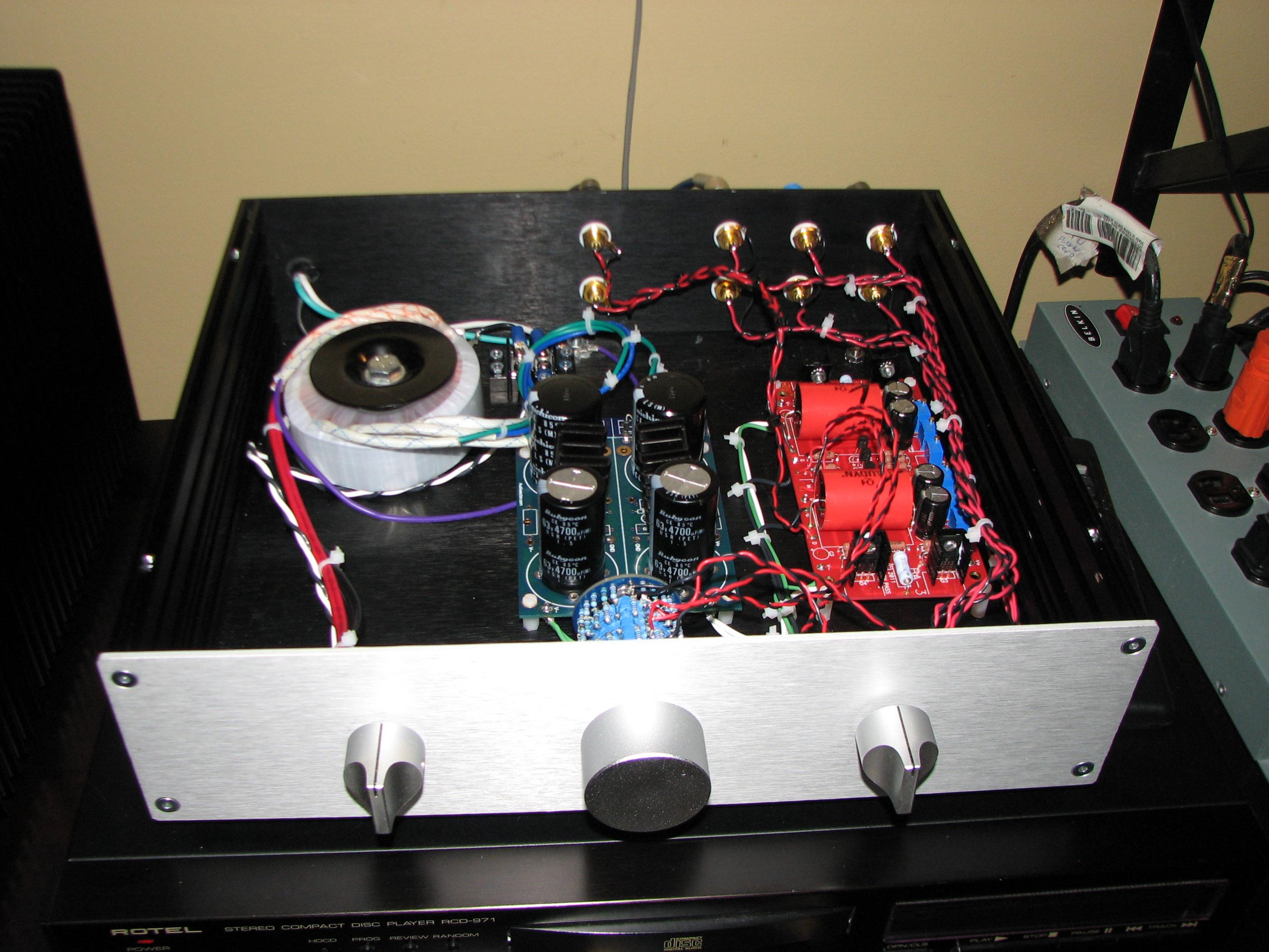

Surprising how hot this amp gets! Shoot, I put my BA-3 preamp in a 288 box! I hope you have huge heatsinks hanging off that little box or its going to not allow much bias...Those "Quasi heatsinks" are NOT going to handle the heat! Are you talking about a pre amp or amplifier?
If pre, mine is in a 288 chassis, with power supply inside, also dead quiet.
Russellc

OK, I see you are after a FE! Here it is, I see no reason for the remote power supply, but whatever...
This is the Amp thread ya know! The transformer here is a shielded Antek. Pre is DEAD quiet as well.
Same chassis 6L6 used in his build thread, 3mm 288 I believe.
