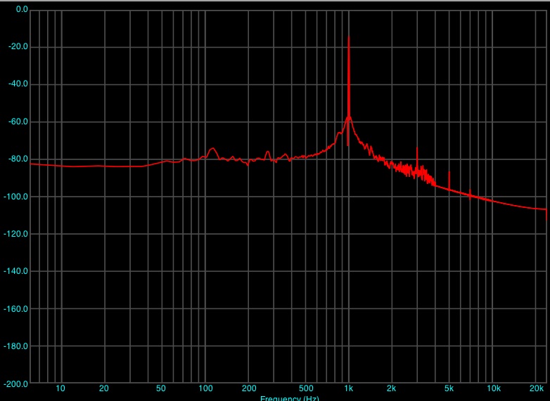

Generg, what do you mean "P"s?
Also, what soundcard application etc are you using for the 1K test?

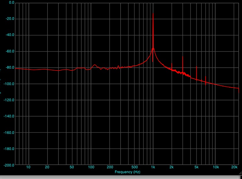

Hi tea-bag,
The software was
Electroacoustics Toolbox
Because I like to work with Mac OS, the hardware an E-MU 0204
And the Ps are P1, P2 and P3 from BA-3
It took me one and a have day to get ready with the software and the hardware, there are so many new aspect, for instance Hamming window. So I still do not know what I am doing and choosing, but I managed to get these results.....
