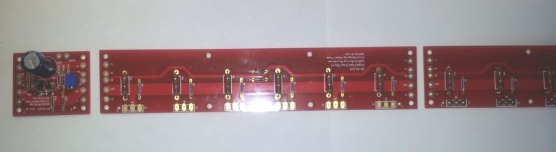

I have the BA-3 FE boards ready to go, but the initial adjustment procedure from 6L6 refers to the R10 & R11 resistors. Is that on the FE before the output boards are attached , which also have an R10 & R11.
I ask thinking there must be some influence on this FE adjustment when the bias boards and output boards are in the circuit. I've completed the same adjustments on the F5 successfully a couple times, but can't determine if I need the whole package when doing it on this build. What is the sequence?

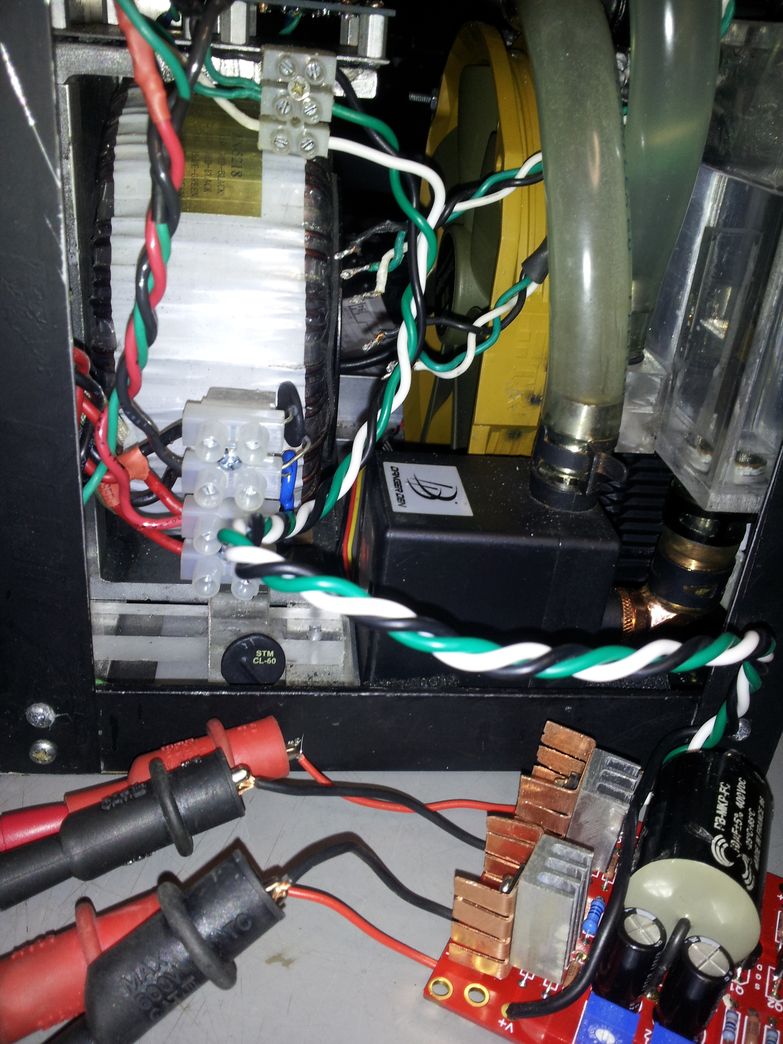

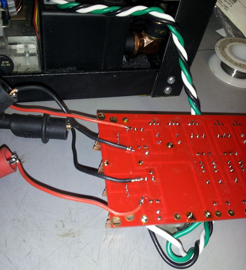

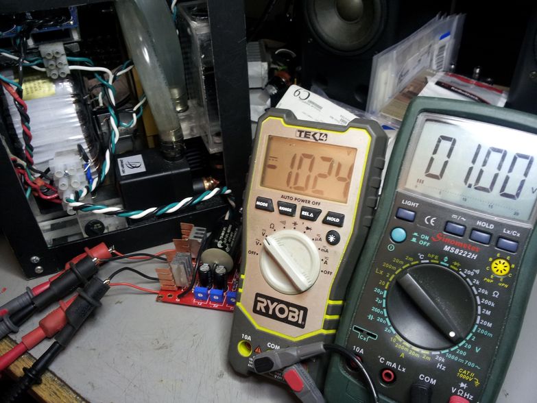

Ah Ha! Made it to first base.😀
All the trimmers are functional without that nasty green smoke. :h_ache: Due to my handy-dandy home-made heat sinks I had to add some extensions to reach the resistors. I didn't want to buy the Audyn Plus caps for C3 yet, so I have to steal one from an old crossover to get the twin for this one - in the morning.
Haven't decided stereo, dual mono or mono-block yet so I used the F5 PS for the power feed.

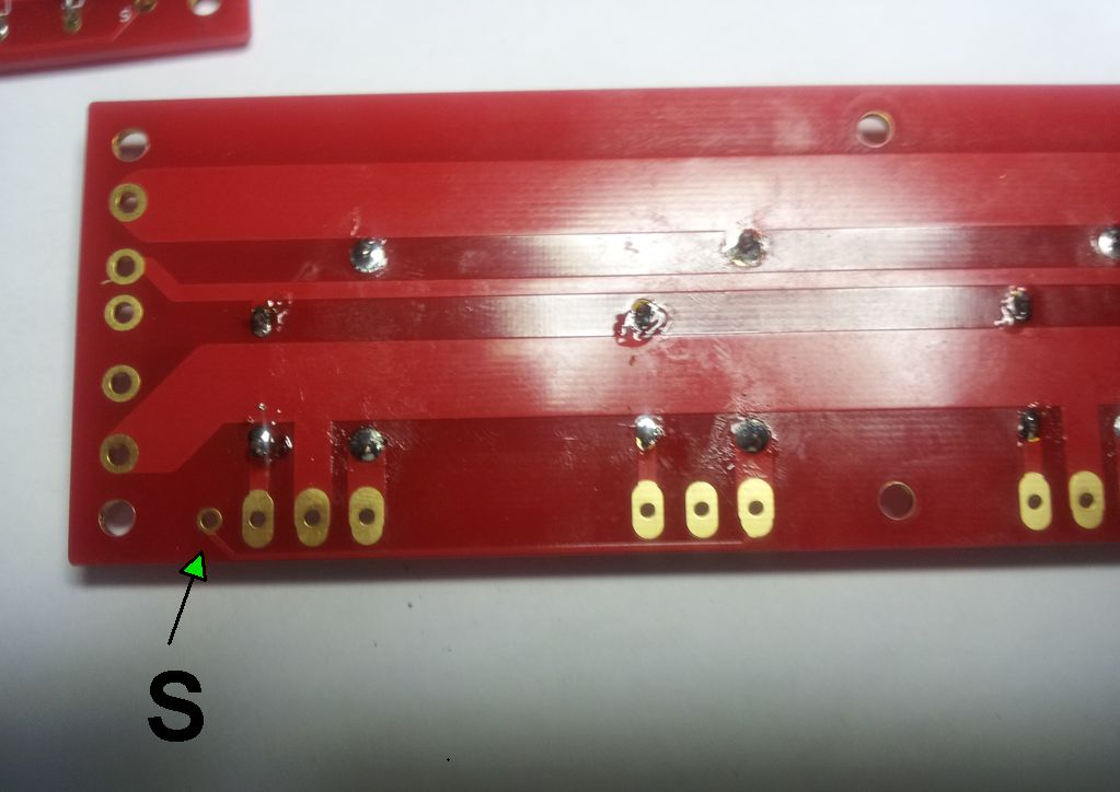

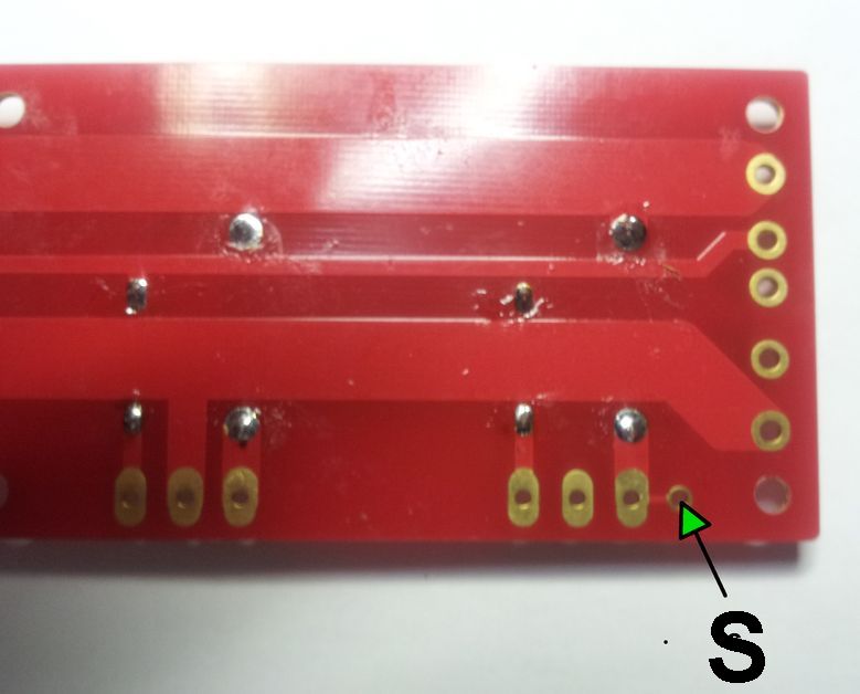

Now that's what I call a clear definition - thanks. So for a single output board having an S pad on both ends is for convenience/flexability, correct? If I add a second output board to each channel, do I need some sort of "S" continuity between those to feed back to the bias board?
Both ends is for conveniance, right.
Connecting one more board.....hm, hm, .....I have the impression the S point feels only the voltage at one resistor and adjusts the current accordingly for all the other pairs without any more connection....but
I am not quite sure in this case.....logical thinking is often difficult for me....

there is the S connection in BA-1 controlling the bias....
and he wants to use not only one outputboard but two...
both outputboards show the S pin on both sides and he asks if is it enough to connect one of the S pins of the first output board and must the S pin of the second board also connected to the S pin of the first board....?
really difficult without pictures I understand .....
I looked for the pictures at the shop, but the quality is so bad you can not see the S pin.....😡

If a second output board (six additional power transistors) is added in series, is there a need to connect the "S" pads between those two output boards. Or is sensing only the first resistor on the OB closest to the bias board sufficient?

No need to connect the "S" pads together. The bias circuit is only looking at the voltage drop across that one resistor to control how much the bottom set of power transistors are conducting. The important thing is that all of those are well matched of course so that they share the current equally.
