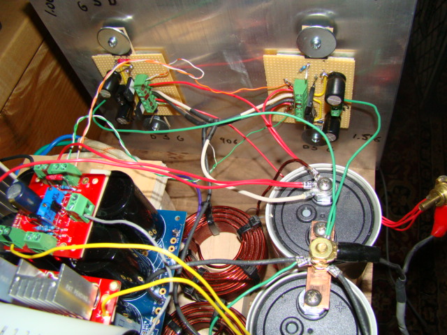

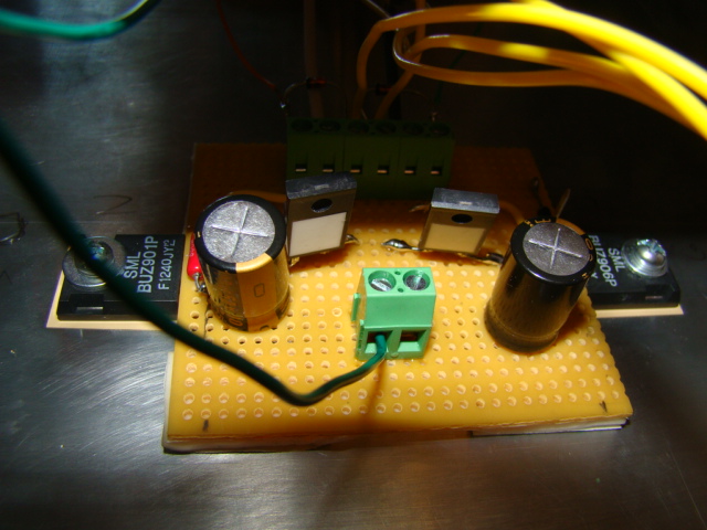

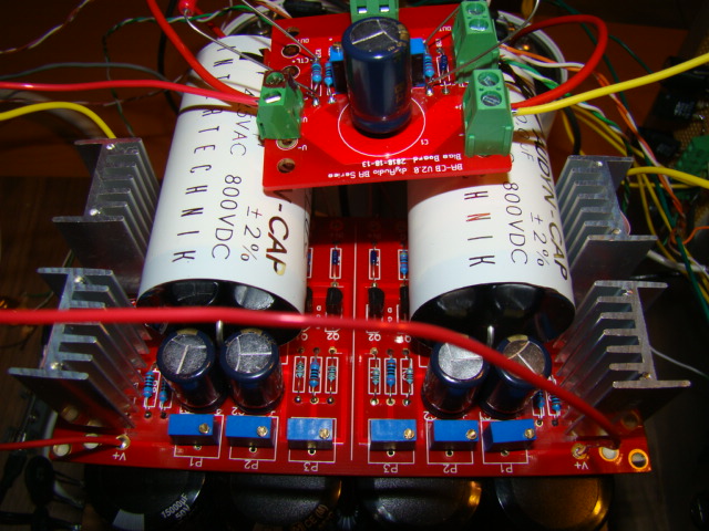

It lives...
I don't know if I'm proud or embarrassed but I got to give a listen. It took a while to make the mosfets behave but it seems to be working well. Two pairs of buz 901/906 driven by ba3 front end. The bias is set at 1.6 amps per output fet.
crclc power supply with 400 va 18 volt transformer.
I plan to build three more of the output stages and try them paralleled and balanced.
I can't really comment on the sound listening to one channel, but first impressions are pretty good.
Anyway it's fun to make stuff and even more fun when it works...
E

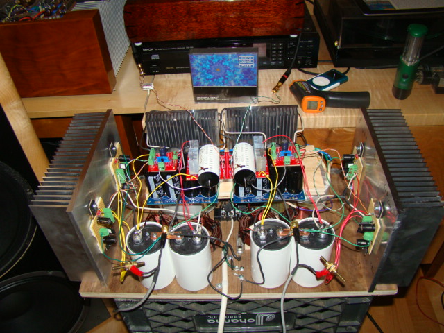

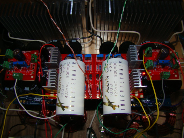

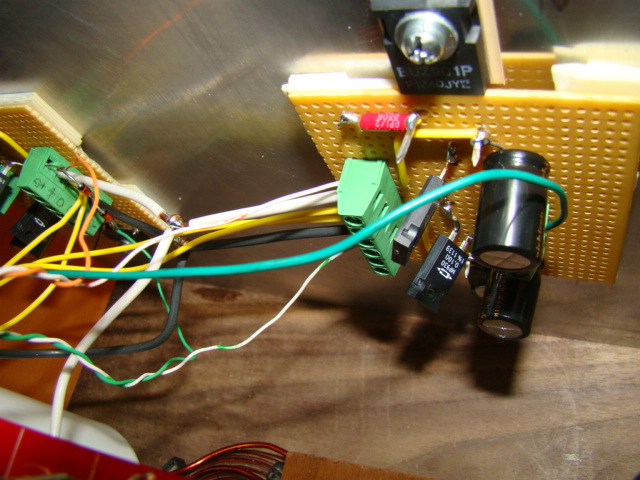

Finally got two channels going...Holy Sh!t this thing sounds good. There is so much different from other builds it's hard to say where the improvement is coming from. This is the second time I've used buz 901/906 outputs and I think that they may be part of what I like. The amp is very snappy. I will be building a couple more sets of output blocks to try balanced as well as well as just paralleling more outputs.
Thanks again too all the people who asked questions and answered them before I even had them...
Evan
