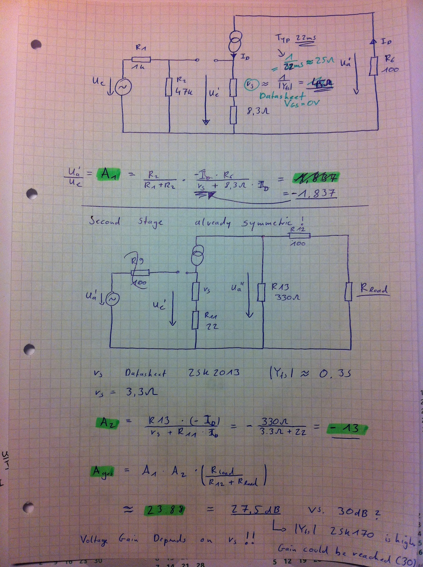

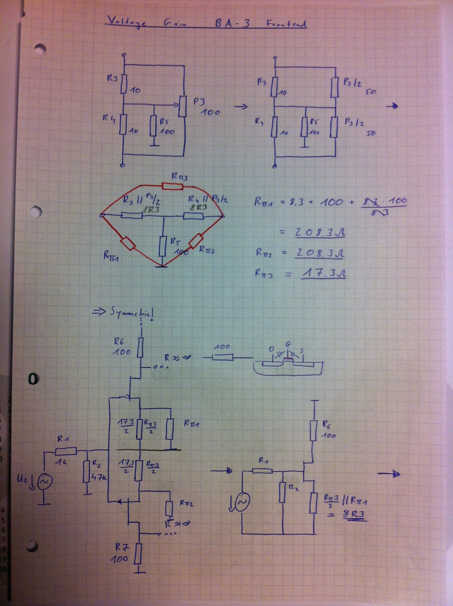

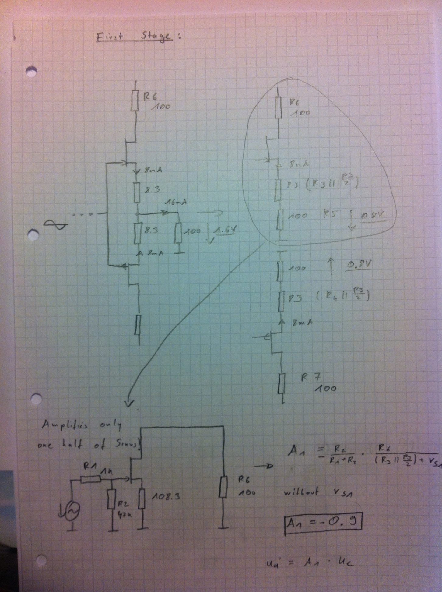

Because I ask unnecessary questions I worked a little bit on an AC Analysis of the BA-3
Note for the PushPull BA-2 Output Stage you need C3...
As you can see on the Pictures Voltage Gain mostly depends on transconductance of the 2SK170/2SJ74 and of course R3/R4 and R6/R7 for the first Stage, which is: A1= R6/(R3+(1/Yfs))
Jfets with higher Idss would have higher Voltage Gain!
The Voltage Gain of the Second Stage is: A2= R13/R10+(1/Yfs))
With higher BIAS Voltage Gain can be increased slightly.
Overall Gain is: A= A1*A2*(Rload/(R12+Rload))
I didn't observe fluctuations of Yfs which differs in large Signal conditions!
In this point of view the Bandwidth is infinite
Best regards Felix

Kamel,
You had it correct and it works out, you just dropped the R5.
So A1=R6/R5+(R3||(P3/2))+(1/Yfs)
First stage 100/100+8.3+45 =.65 gain for first stage and I verified it with my amp.
A2=R13/R10+(1/Yfs)
Second stage 330/22+3.3=13 gain.
For an overall gain of .65*13= 8.45 and that is what we are getting.
Now if you are running balanced you would get 8.45*2 =16.9 or 24.5dB
I’m now satisfied we can calculate the gain correctly.

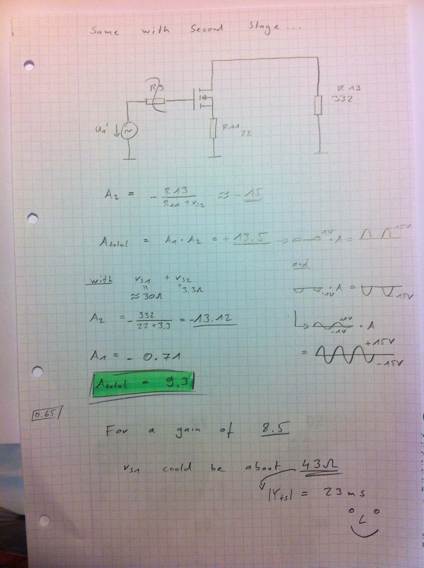

I would have thought that Q3 and Q4 being out of phase wouldn’t add together and then the rest of the math works.
My amp has a gain of 8.5X and sounds great. Thank you.
Assumed Gain of first Stage is (R6+R7)/R5 = 2 and of second Stage is (R10+R11)/R13 = 7.5... Overall Gain is 15.
Why adding Gain of upper and lower part of second stage?
When we split it up, so first Stage Gain is R6/R5 = 1 and of second Stage Gain is R13/R10 = 15... overall Gain is still 15?!
The upper half of the Stages only amplify the upper half of the Sine Wave and so second Stage the lower half...
Picture follows...

Oops, you are correct they are in phase, but they still don’t add together, they are push-pull. We are all still getting a gain of 8.5X.
Neither i get it.
let a 2V pp input signal.
positive half (1v) is amplified 15 times. thats 15v.
Negative half(1v) is amplified 15 times. thats 15v.
output is 30v pp.
That is 15 times 2volts.
