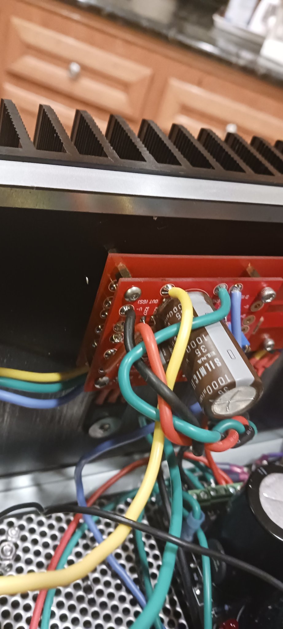

I finally got around to finishing the BA-3 with single-ended (BA-1) output boards. I was able to bias the front end with no issues. Now that I've hooked up the output boards, what's the procedure for adjusting them? There's a single pot on the top-mounted bias boards, but I'm not sure what I need to do.
Also, it looks like there are three ground connections per channel going to the power board, not including the chassis ground. These include one each to the front end GND, speaker -, and bias board GND. This differs from the push-pull which does not have the GND pad. Is that correct?
@maltboy1 Yes, the pot is used to zero the DC offset on the output. Bias is automatically set to 0.6A through the source resistor; just make sure you connected the S pad on the bias board to the corresponding pad on the output board if you don’t want things going up in smoke (ask me how I know).

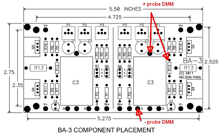

I'm using a BA-3 FE and BA-1 output, both running on 32V rails. The PS uses dual 300 VA donuts with a dual monoblock power board. Output is a steady 34V unloaded. The FE bias is currently running at 800mV. The FE biases well with the output disconnected, but the offset re-zeroes itself if I turn either P1 or P2. Is this normal?

Where are you measuring the FE offset? And what do you mean by “rezeroes itself”?

I'm measuring it at R12. I'm measuring bias at R10 and R11. P1 and P2 seem to be somewhat independent. Not like the F5. For example, if I turn P1, the bias on that half changes, and so does the offset, but then the offset reverses direction and goes to 0.

Make sure you’re not measuring offset across R12 (the drop across R12 will always be close to 0) but from the junction of R12 and the output cap, and ground (ie, one probe between R12 and the output cap, and the other probe at GND; i just hook one probe on the top lead of the output cap and the other to GND).
Well that would explain what I'm seeing. I was measuring across the resistor. I was also measuring bias across the resistors. Is that correct?
