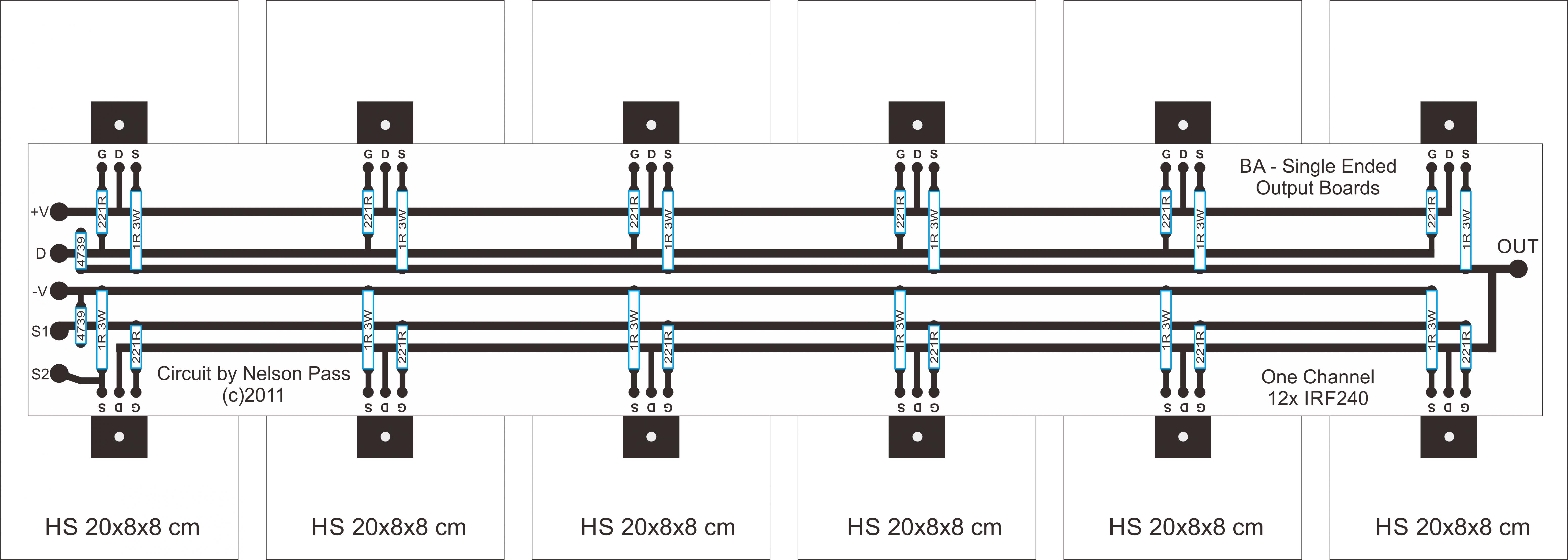

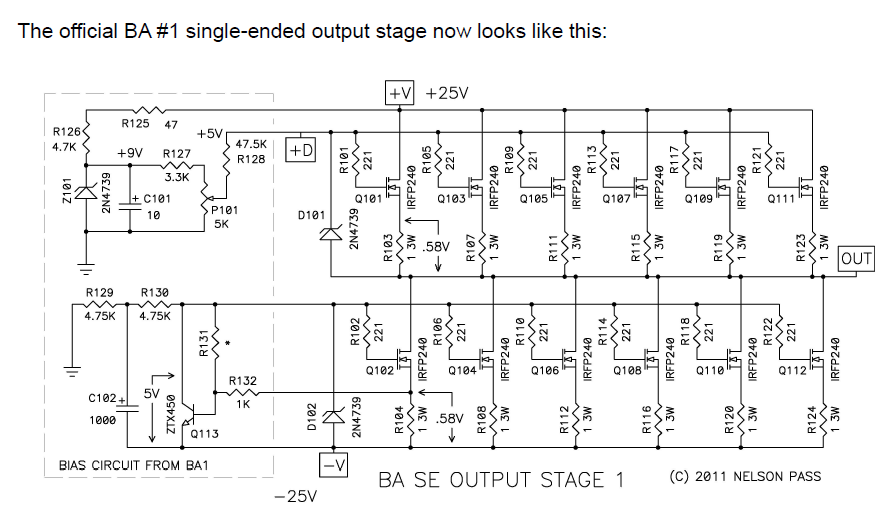

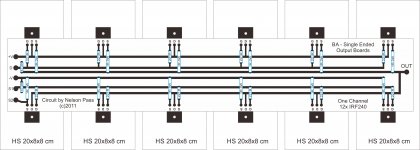

i also plan to build singe ended with 12 devices per channel.
but i think i want to make the output pcb's my self while learning at the same time.😀
schematics based on official BA SE output stage.
please someone here help me to trace the pcb layout.
let me know if there are any mistakes, or any advice welcome.
thanks. 😉

Quick question: The single-ended bias boards only have P1, so I'm assuming that there is no "offset," and that the only thing that needs to be set for the outputs is the bias itself?
Also, the FE gets biased to 1V, or a little under. Do the output boards get biased to the same amount?
Hi storm, I built the se version, the pot on the bias board zeroes the dc offset on the output terminals, the bias is fixed.
Do you remember what the bias is fixed at for the outputs?
I dont know if this helps, but with my complimentary BA-3, while the FE board biased like you say, from .900's to 1.000, the output stage, depending on room, circulation and so forth in a 5U chassis was limited to .46 or .50. Maybe this winter ( or with a babysitter ) a little higher. At this level the heatsink was reaching 52 degress centigrade.
Perhaps if someone with an up and running would measure across one of the resistors on the output board they could tell you, but if it is fixed, I guess it is fixed. I dont remember the BA-3 article mentioning it, but it may have escaped me as I was going complementary.
Anyone out there running a single ended BA-3 that wouldn't mind measuring this for stormfrontier?
