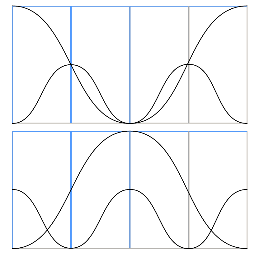

I still don't understand why, when reversing the speaker leads for out of phase connection, that the result is negative phase w/r/t fundamental) 2nd harmonic as opposed to positive phase 2nd when hooked up to speakers in phase. My logic tells me that the distortion would change phase with the fundamental and not reverse the relationship between the two....but who cares really? this is good fun.
I think it's easier to visualize if you just use a single cycle of fundamental frequency and its 2nd harmonic....I still don't understand why, when reversing the speaker leads for out of phase connection, that the result is negative phase w/r/t fundamental) 2nd harmonic as opposed to positive phase 2nd when hooked up to speakers in phase. My logic tells me that the distortion would change phase with the fundamental and not reverse the relationship between the two....
In the original one, you can see that both the high and low valleys correspond to low valleys of the 2nd harmonic. If you reverse the phase, you would note that the high and low valleys now correspond to HIGH valleys of the second harmonic:
So yes, both are reversed in phase, but that yields a different positive / negative relationship between the fundamental and 2nd harmonic.
Hope this helps,
Rafa.
Got it, thanks! I went back and re-read Nelson's paper, and indeed the same relationship shows up there.....it just took a second, ok, maybe a third go at it to make sense.
