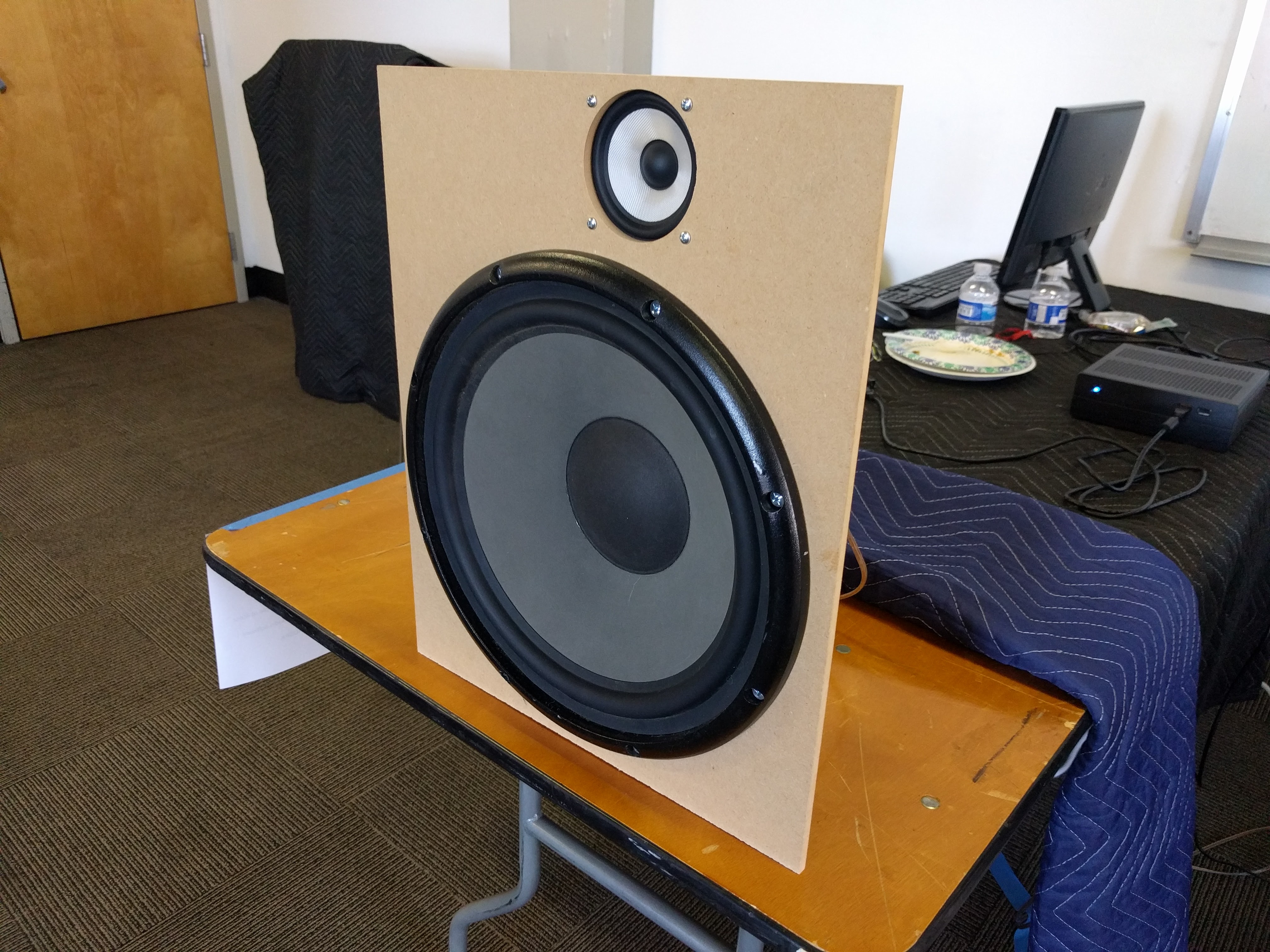

Can anyone share some details about these open baffles that were on display? Whose were they? Were they bi-amped? I remember them sounding way better than I would have expected, especially the bass with such a small baffle.
Thanks Russ for the photos of the event!
crossover
I don't remember if there was a passive or active crossover for that speaker. The photos suggest it was separate amps for both drivers. As I recall, the exhibitor was more about the class D amps he was using than the loudspeakers, which were just a last moment throw together.
These were mine. Happy to answer any questions about them, but RE the bass... did you notice the dipole subs on the floor? as Russ says, they were kind of a last minute thing. I put them together only during the couple of weeks leading up to the show.Can anyone share some details about these open baffles that were on display?
Actually, a funny gotcha happened with the subs. I set up the filters wrong and they were not properly equalized. I thought it was just the room being boomy (which it was to some extent). Nope, it was a mistake on my part.
I still haven't unpacked these since the show. I liked their potential and wanted to redo them with a different woofer eventually, but I don't have a good place where I can set them up at the moment.
Anyway these were an attempt at a minimal-baffle OB for about 100Hz and up. The tweeter is the Peerless TG9, the 8 ohm version and the woofer is an old Focal 12" unit. I had a linux computer doing the crossover in software with a USB "preamp" interface connected to the computer that could control the volume, which input was being used, etc. That's also a project that I still have not unpacked since the show!
Drop me a line if you have questions about anything in particular.
Thanks Charlie! I appreciate your reply. I saw the subs but wasn't sure if they were hooked up. I was just really impressed by how seamless and balanced they sounded. I found your post describing your speakers on the techtalk page at partsexpress.
