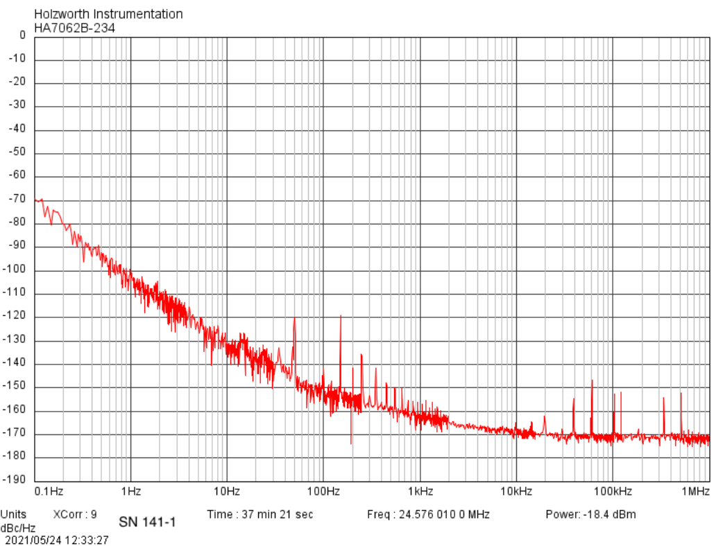

100kHz? Okay. Here is a plot of my 24MHz clock oscillator in use now with my dsd only dac:
However as can be seen, down at .1Hz offset frequency, it is at -70dBc. What some people believe matters a lot for audio dacs is around 1Hz - 10Hz offset. Far-out phase noise (e.g. 100kHz, mostly just affects noise floor, whereas close-in phase noise is more convolved with -- or multiplied by in the time domain view -- with our audio band frequencies).
