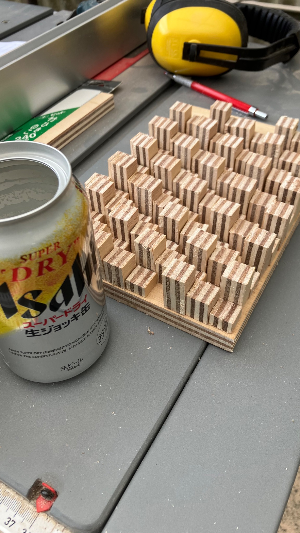

Note: if anyone reading this is optical, i have a set of Maeshowe (in cherry veneer) here for giveaway. They have the bumpy air cavity i did.
dave
I had a chance to work on this aspect of the build today, but at this point I am starting to think I might abandon this particular tweak. Getting this all glued together in a way that is relatively simple, quick, and effective seems nearly impossible. Wood glue takes a long time to dry and should be clamped for best results. Each piece needs to be glued to the base board plus any adjacent pieces to eliminate vibrations/rattling. It seems like if it is not done perfectly, it will do more harm than good. To do it perfectly with wood glue, it might take weeks. There are 120 pieces (per speaker).
Some sort of instant (or nearly instant) glue would change this situation quite a lot, but I don’t want to risk having pieces falling off and/or vibrating inside the driver chamber.

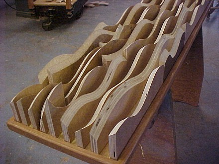

One alternate way Terry Cain used to make his own diffusers (similar, just on a much larger scale) was to cut some strips of stock, then run them, with a random, wavy line through a bandsaw with the table tilted so you got some random angles there too. Like so:
