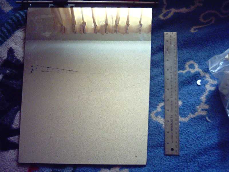

hey nice gear u got there, i like the big bulb for ideas, im sure it will bring some bright ones lol.
As for the front surface mirror yeah u cant use the dameaged part as that part wont reflect any light/image that needs to be reflected in that area, id try to cut it up so you are only using the good area with your lcd if possible, not sure on the copy lens, its big though, wana sell it? lol.

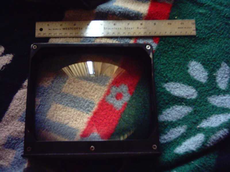

not quite yet
Hey Ace,
Not quite yet on the bright ideas or parting with the lens. I think the lens was used as a condensor in the enlarger. I had the chance today to pick up a bucket load of big lenses, but no money. Some a-hole I sold some stuff to on ebay claims he forgot to send the payment, so I missed a big chance. Maybe none would have been any good anyway, but they sure looked like fun to play with.
I put the lens out in front of my Sharp panel with a 50W halogen behind it and it cast a very big and sharp image so I think it might be an OK lens if I could find the right way to use it.
I found what looks to be a good book, Modern Optical Engineering, in my library today. Will get some background, if I can remember how to do the maths.
Also a question, does the spherical reflector cause hot spots in the bulb, by reflecting the light back into it, or do you move it out of the focal point?
Michael
