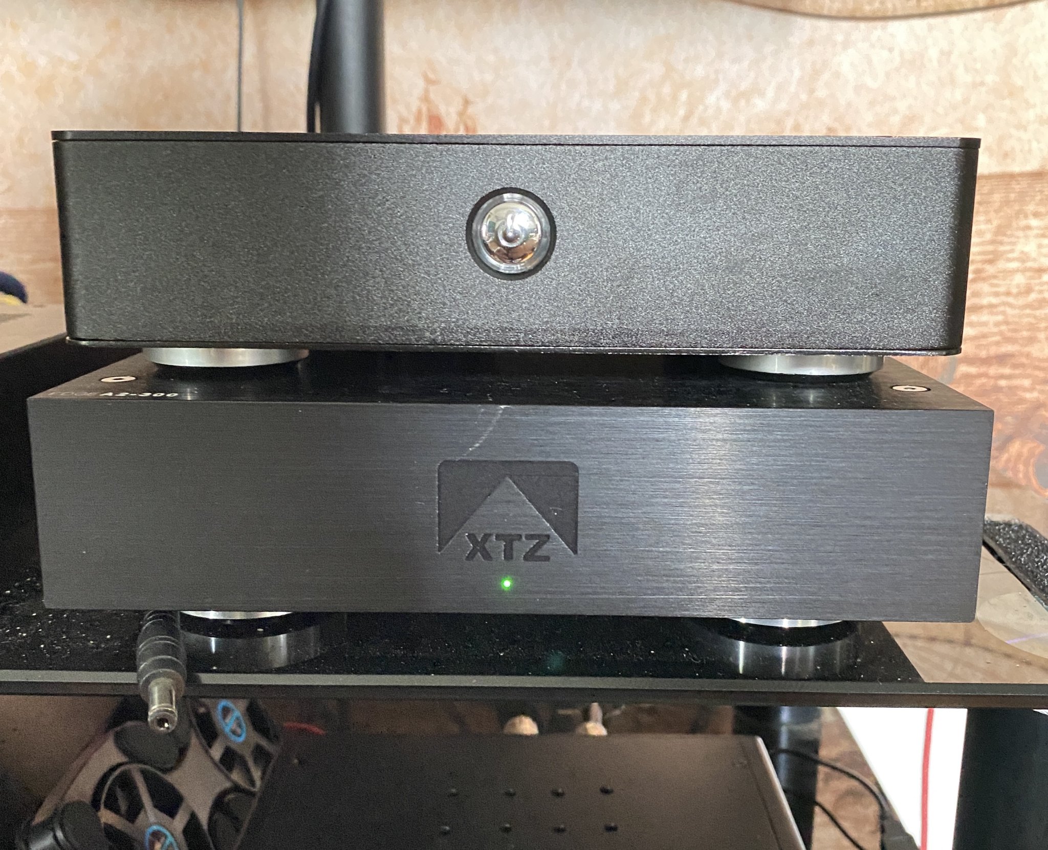

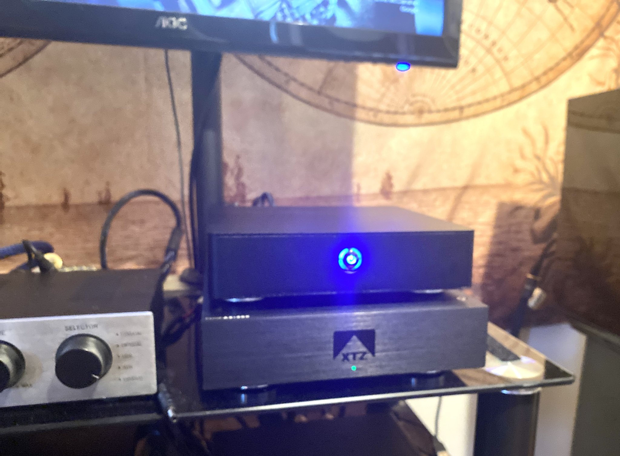

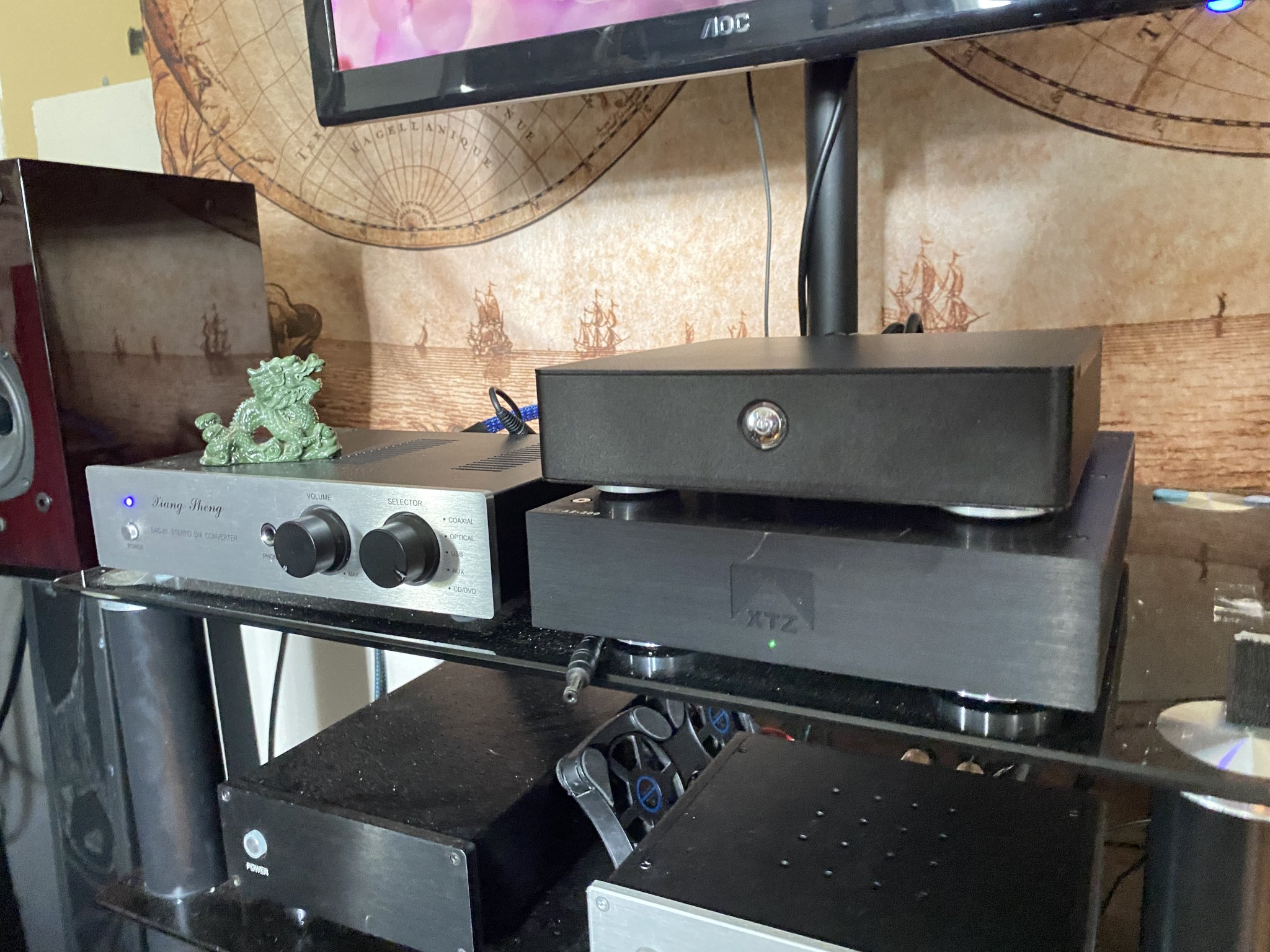

man Am I confused theres like a million boards Ian of Canada. What is the most cost effective way to potenytially improve audio from Protodac if even possible really. It sounds amazing as I have it and only differences were seperating the hat and the Pi running jumpers from Gpio of Pi to Protodac. Feeding 5v linear power to both. High quality cabling and shielding on rca's. can I run the Digi2 pro in Master and the proto dac in slave? how to do this. Also those you listed are USB. I dont have a want for usb signal to feed the streamer. Its a network streamer and Dac Ive Built. This is it. here. on top of the XTZ edge amp.
