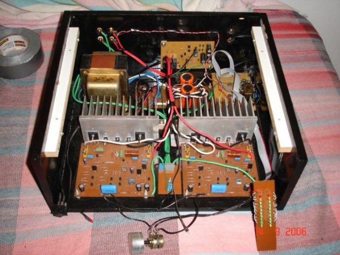

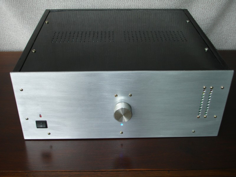

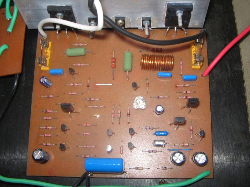

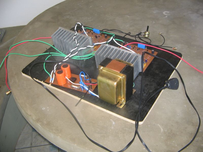

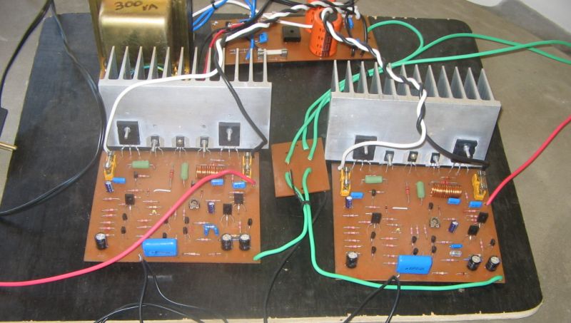

jpnascim said:
Unfortunately I don’t have a digital cam to send some pictures but I’ll try…
Well, after some months I've managed to obtain some pictures of this amp I've built. It continues to sound great....
Sorry about the mess !
João Pedro
K-amps said:Your power supply caps look like they are too small.... small PSU caps can cause hum.... (Size is not always a good indicator of capacitance ut still they seem underrted.)
Hello K-amps,
The PSU capacitors are from SIEMENS, rated 50 V 10.000uF each. I don't have Slone book in my hands right now but I recall trying to follow one of his advices when rating caps for the PSU. I will recheck that. Do you think it is necessary to go for bigger caps ?
The amp is driving a pair of 8 ohm loudspeakers and show no signs of serious hum (just a little bit when no music is playing and you have to put your ears close to the loudspeaker).
Best regards,
João Pedro
hummmmmmmm..... ,a diy confidence killer
u know that a hummmmmm can reverbrate through the mind and heart of a diy person and shake of his resolve.y so?bec this irritating noise means imperfection in your work.
when i built my first amp,it was noisy like hell,reason being that it was built on a vero board.
so i took off from my computer to use cad program to draw a good layout and laid down the pcb tracks.
i took every concern concerned to make a good n great layout so that no noise can interfere.thick earth lines,zero jumps,thick wires for o/p and thin ones for i/p.
i assembelled that amp with all care and voila!!!on the first start the amp blasted out loudly to my happiness.it worked to great levels for a week or so but that !@#$% hmmmm appeared from nowhere.that made me doubt for a sec my ability to make a good board for myself!!but i made out that if it worked fine earlier then whats making it funk now??
i double checked all the solder joints to see if any is loose.best way is to see loose joints is use a continuty tester while pressing the components inside the pcb.if soldering will be loose then no continuty.
two three were loose. ifixed them and the humm was gone.
what i suppose in your case will be bec of leaky capacitors.check them through capacitance meter.
one very common reason is oscillations which can be due to micro mini ripples inherrent to any power supply output which are amplified by amplifier to give out that disgusting sound.
to avoid oscillations,use a 100nf capacitor(metal film) from each supply rail to ground as close as possible to the amplifier power i/p as possible.
keep track lenght microscopic from 100nf caps to the required semiconductor.this will surely take care of noise.one very common reason for noise but not yours is faulty pcb layout so if u design yours,do read guidlines for pcb design available at the site of EXPRESS PCB.
hope this essay helps..

Re: hummmmmmmm..... ,a diy confidence killer
Oh yes, since this is my first DIY amp I didn't expect to work 100 % at the first time. There are probably many imperfections in my work but I don't expect it to be 100 % perfect either !
I tried to be very, very careful with solder joints, I took my time, used a shinny lamp and went really slow, soldered, inspected, soldered, inspected
I don't have a cap meter to check if my electros are leaky, unfortunately. Well, I have a simple one in my digital multimeter but it goes up to 20 uF only. But I would like to do this check. I just don't know how...
Right. In my case, power supply is decoupled on the PCB board using 100 nF metallized polyester capacitors between V+ and GND, V- and GND. It is also decoupled in each amp board using, 100 nF and 220 uF capacitors between each rail and ground. I guess that is enough....
But anyway I appreciate your suggestions very much sagarverma. Next time I will do better following much of the advices posted by you guys.
Thank you very much
João PEdro

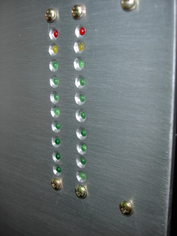

Well folks,after 1 year...
Hello everyone !
Almost after a year since my last post here I come back to post some pictures of my finished amp. I did the chassis by myself using plywood smoothed with acrylic mass and high quality glossy black paint. The reason is that it is really difficult to find companies that construct chassis projects out from a drawing at reasonable prices here.
The panel is made from 5mm aluminum and it is my design also. The knob I've got from a repair shop and it is from an old vintage receiver, paid really cheap.
All its parts are screwed together firmly (i think more than 30 screws in totoal )
Well, it is far from perfect but I am satisfied with the results and feel great that I could get my first DIY project completed. the amp is playing great, hum is almost gone thanks to help from many here. Now I can sit back and listen to some good music !
I hope you like it !
Best regards,
João Pedro
First picture, top view, without panel mounted.
Hello everyone !
Best regards,
João Pedro
