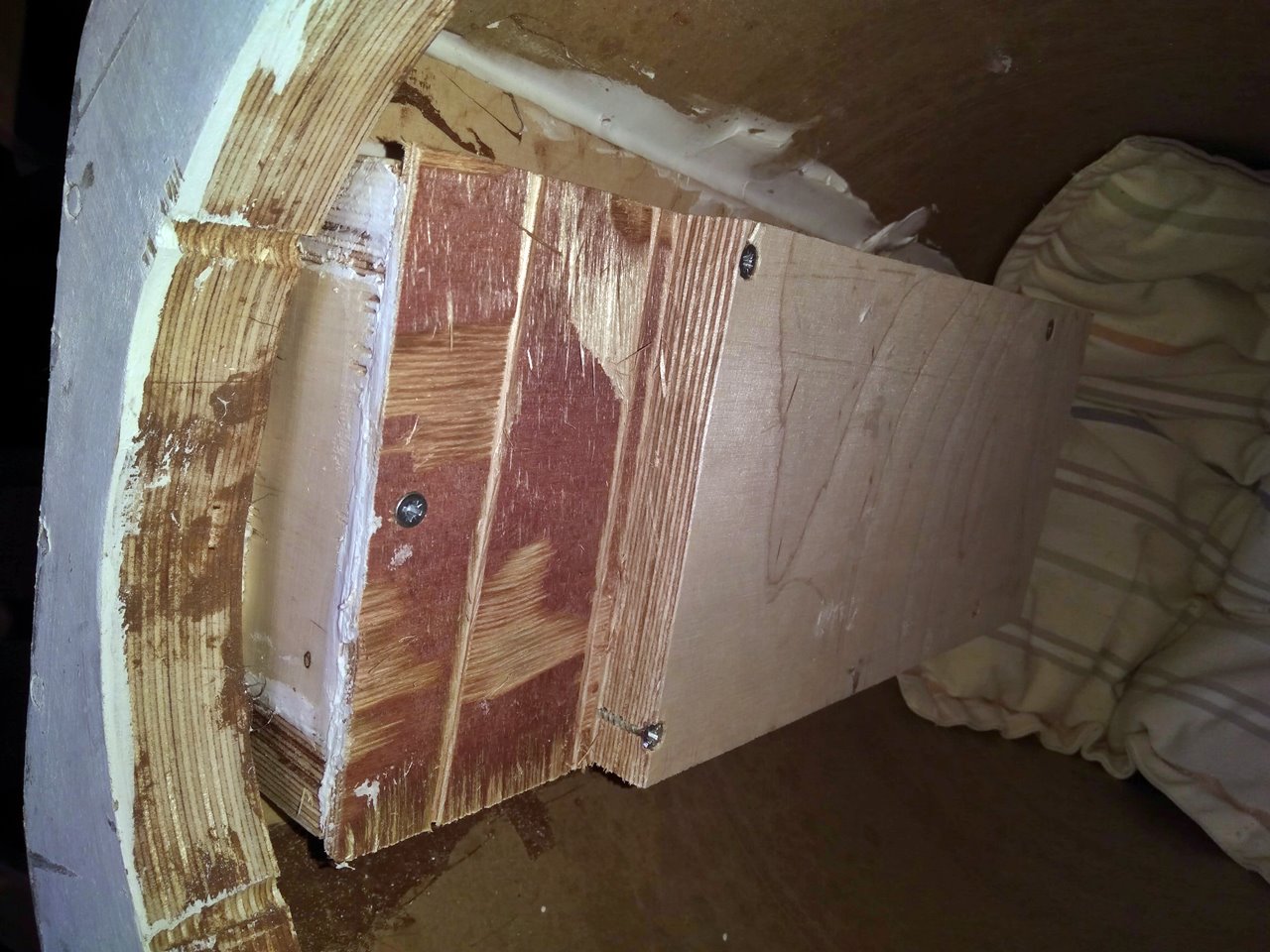

Mixing analog and digital isn't as bad as it sounds. Sitting on my bed now listening to a pair of semi-diy 3-way speakers powered by two Hypex FA123. Source is Spotify on Yamaha WXC-50, sending analog unbalanced to each Hypex. Music starts playing when I select a piece wotih my laptop or phone and select device as "Bedroom" and Yammy and Hypexs start playing in a few seconds. No hum or noise, just plain hifi!
Other option is to select "Living room" in Spotify - and Yamaha RX-V685 wakes up and starts sending unbalanced RCA to Minidsp 4x10HD and ICEPower modules driving 4-way diy speakers. No need to stand up and walk to mechanical switches.
Makking all these fully digital is beyond my know-how. Totally wireess is even beyond my dreams and not personally needed in any way. (modern Scandinavian minimalistic interior could benefit from that perhaps?) Balcony use could be served with bluetooth speakers, but I don't want that at home - at work I have that (mono) for quiet background "noise".
