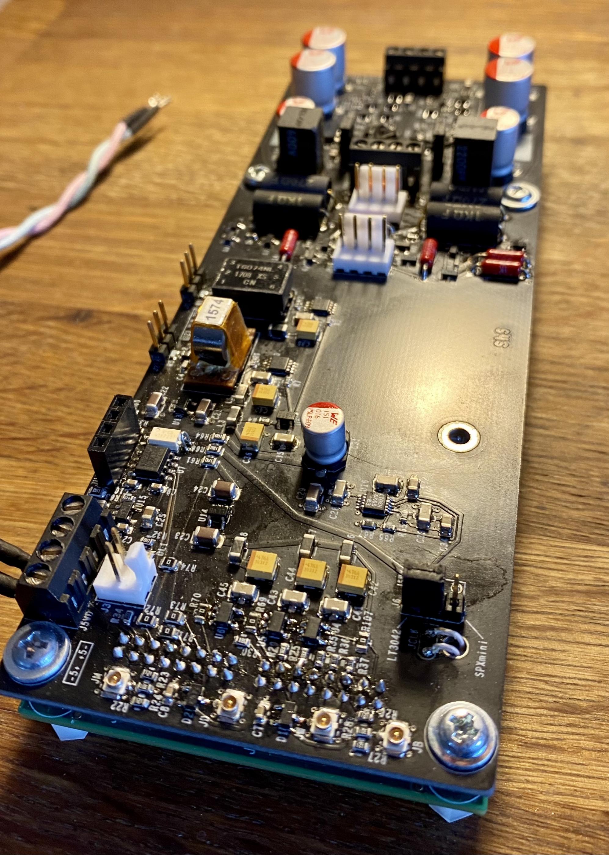

Hello guys!
I´m new here, and for my first project I´m building a dam 1121 as a DAC with a whammy headphone amp. So far so good, everything is working fine, so I´m begining the phase two where I will try to improve things a bit and fix some "temporary" things I´ve done while building it.
One thing that I can´t find a solution (I´m sure is very basic, what I´m going to ask) is how to plug things to the pins on the DAM 1121. I have some sockets "pitch 2.54" or something like that, but they are too big for the soekris board. I´ve ended up using some of these 2.54 plugs where I could, but they move around and it´s obvious that they are not meant for that use. Also the resistors and output cables I had to solder them directly because I had no room for anything else (I think it´s not ideal?? I don´t know...)
What is the name of these sockets for the board? Where can I find them? Or ... what´s the best way of plugging all the cables there in an "elegant" way?

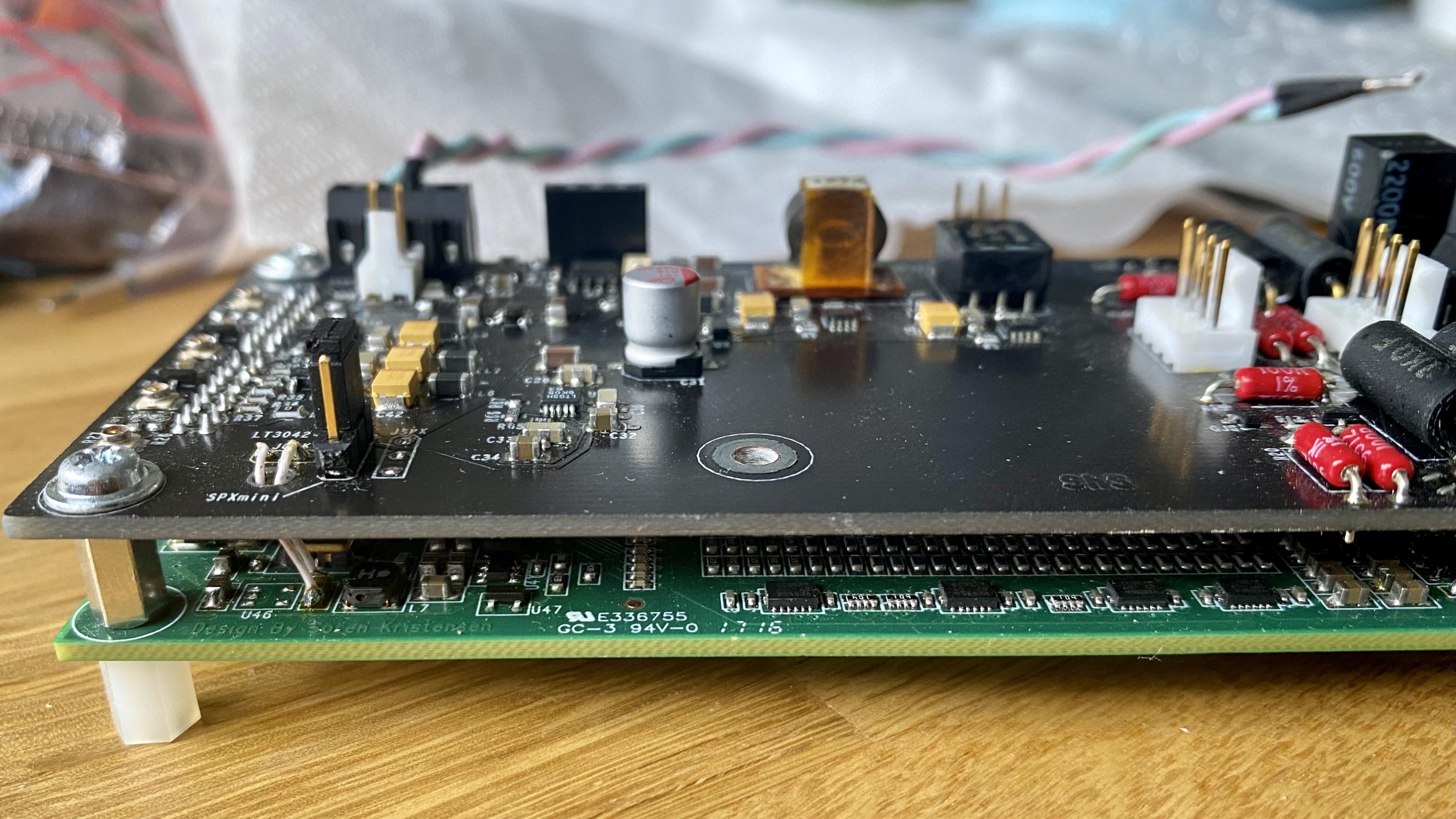

Pablo,
I use 2.0 (female) headers which I press on the Soekris male headers.
The female headers are meant for PCB mounting but I soldered my wiring directly to the solderpins of these headers.
First I tried with adapter PCB (2.0 tot 2.54 pitch) which was a bit wobbly and I did not like it.
Directly soldered to female header:
