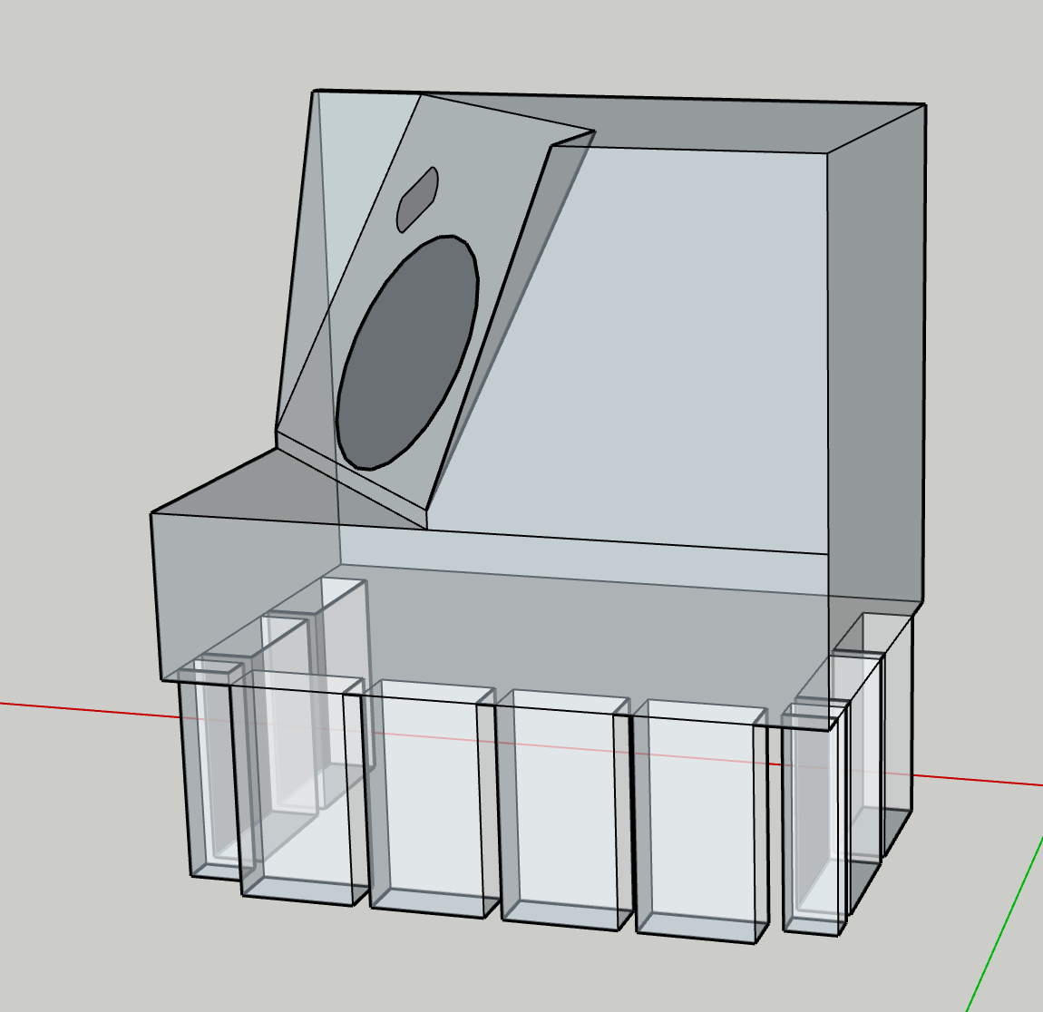

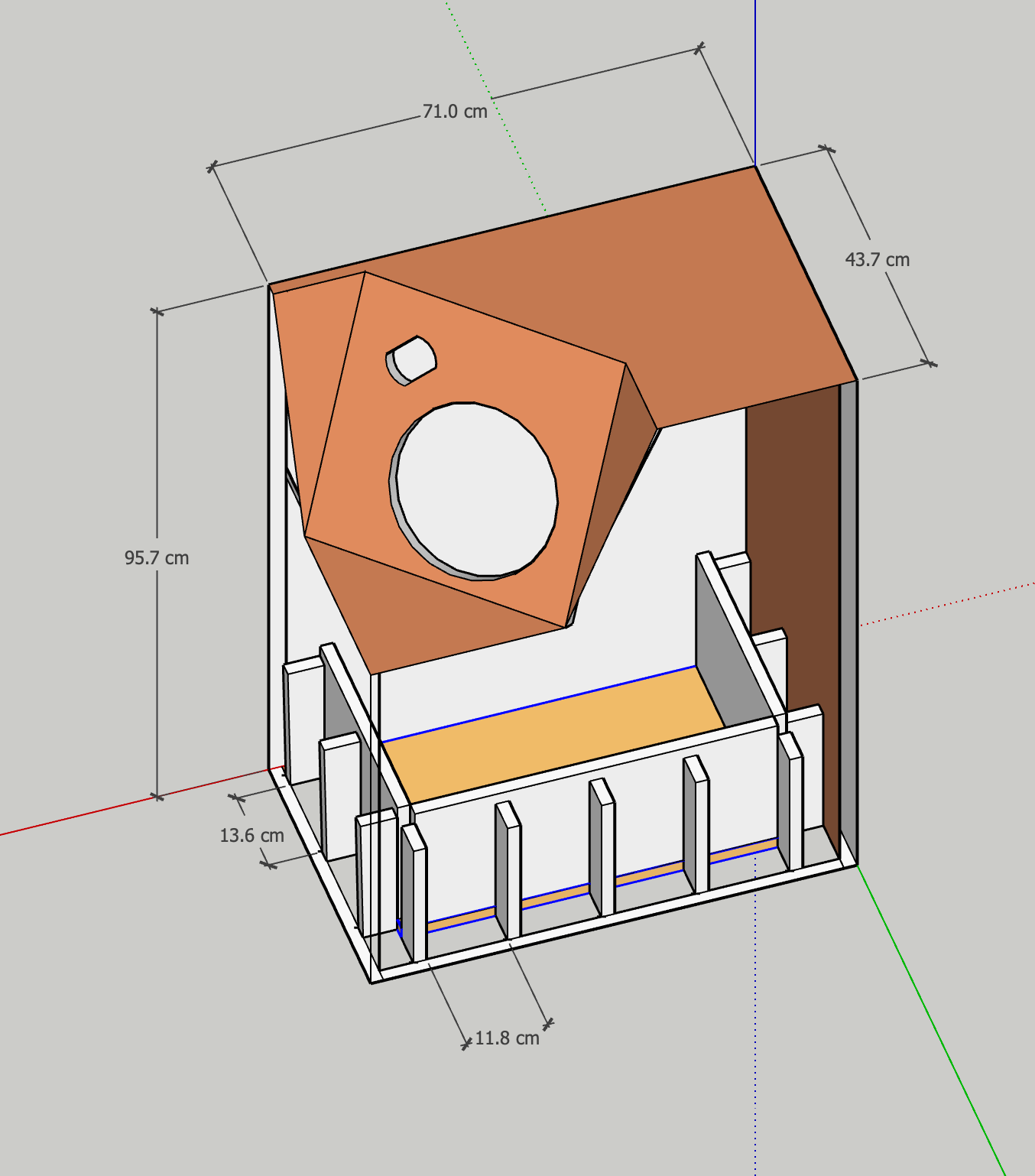

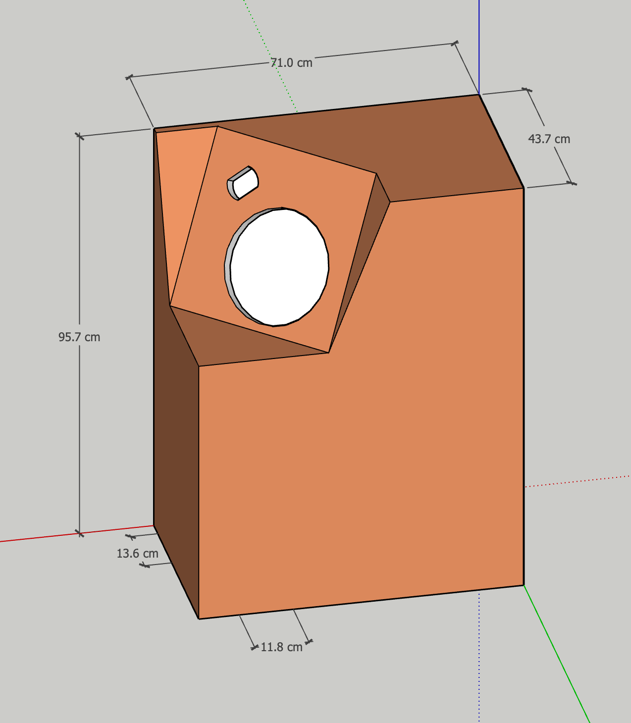

Attached is the design of the speaker, along with the T/S of the driver and a hornresp file which is close (not accurate to model), but shows the modeling strategy. A big box, with a big downfiring port...Not quite Onken big, based off what I read.
1). The ports fire down, and I can adjust height from the floor...but am unclear as to how to model this in hornresp. Is there a rule of thumb minimum here?
2). The angle of the speaker is 60 from horinzontal. It will be firing upward and backward into a corner that is 8.5' in height, and slopes up to about 17'. 60 degrees was pulled for aesthetic and math purposes. Is there a better angle to consider?
3). bracing. I have not yet added the bracing to the model, and know there will very likely need to be some. I have seen a lot of braces with the circular cutout approach. Is there some minimum hole size relative to being able to ignore, or else how do I model it. Or, do I do minimal bracing and accept that the Ql will be quite high? Looking at the rough modeling, this seems to be pretty insensitive to Ql. Though i have no idea what a Ql of 50 looks like.
4). Design - Am I missing something critical in a "never do that" sense?

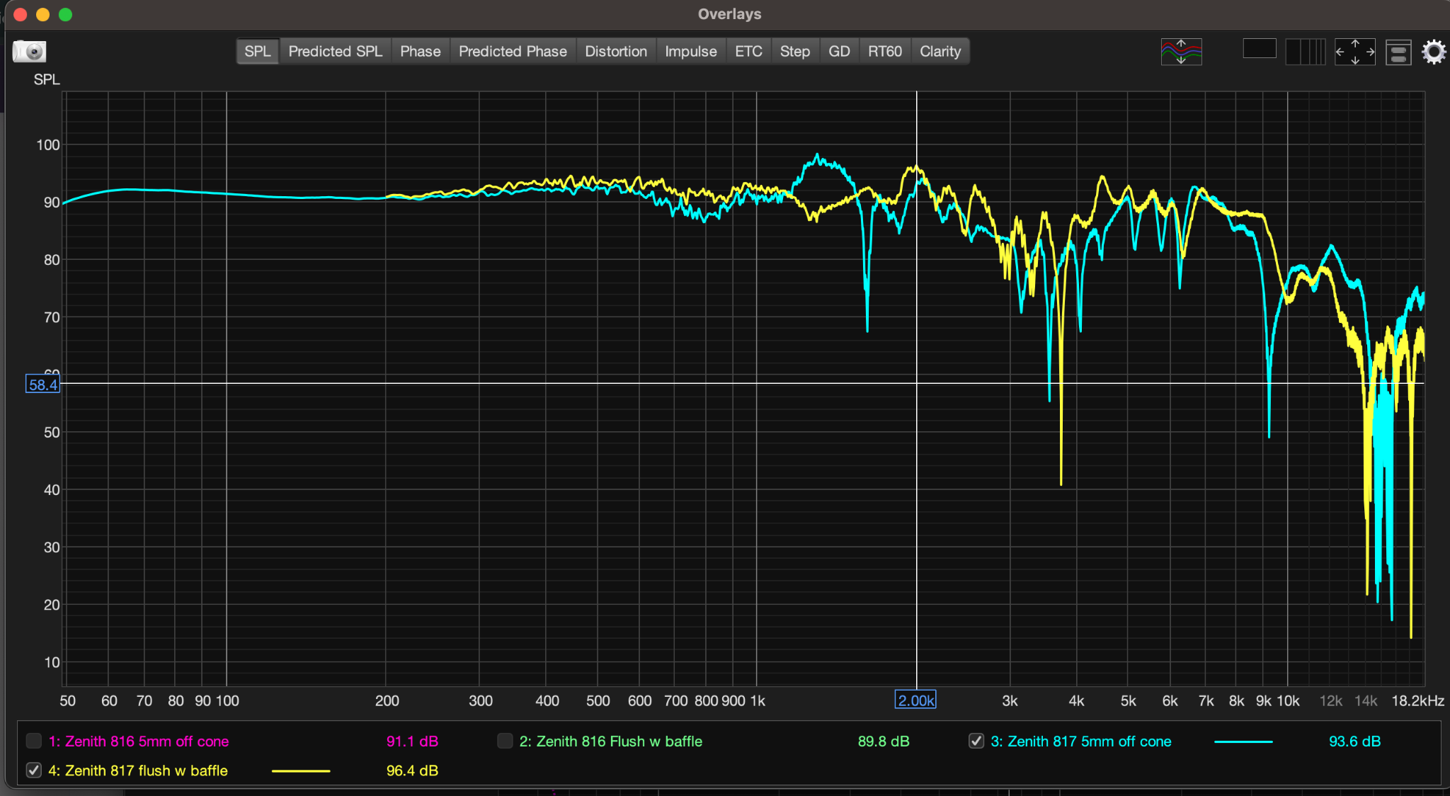

Listening near-field to my 49CZ852 right now... propped up nude aimed at my ears forming equilateral triangle (realizing the most acute hearing), only the 2-5khz "romantically bright" hump needed a bit of taming. Extension both ways really quite good. Firing into room upper corners would scramble mid-to-high frequencies to (possibly) not reach the listener together. I think you might need to design and test a slightly convex corner reflector to bounce the driver(s), in order to disperse and control HF.

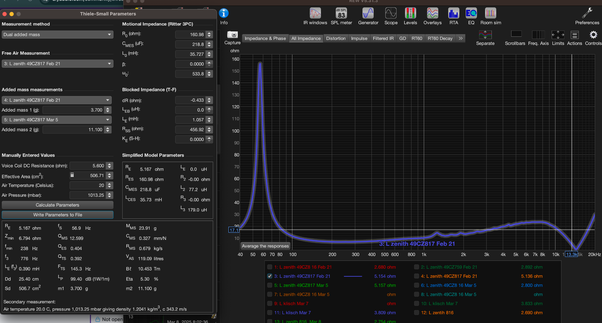

Hi @wchang. Interesting that your 852s had a hump, whereas my 817 apparently has a dip. But it was harvested from a three-way, so likely different. (https://www.diyaudio.com/community/attachments/screenshot-2025-03-10-at-11-59-03-am-png.1433422/). GM suggested that this is due to the felt dustcap.
I am curious, wchang, if you see funky phase behavior in your hump range. I see things get all wonky in the 2.5K range. Which is why I am still unsure as to the crossover point. (https://www.diyaudio.com/community/threads/how-to-model-this-speaker-is-sd-relevant.424787/)
Perhaps next weekend I'll measure phase "my way", LX over a reference flat-phase driver in opposite polarity and check if on-axis null offset shifted with frequency. Last evening I notched the hump (reported in Fullrange forum) and would like to compare phase before-and-after. But the work-week has already started here.

Assuming you're referring to the woofer, then this is where the ribbed part starts. BTW, what's its Fs?
Hi @wchang - as this is for my bedroom, I can't see the floor space being available. It's gotta be packed against a wall. I do like the concept, though I don't know about cone sag? but that is for a later day.
Hi @GM - First, this is the same woofer from the previous thread on "is sd relevant?". I decided not to mess with the 7", so as to start building something. I found hornresp a dangerous rabbit hole, but perhaps better than social media ;-). The Fs is 56.9, and this is tuned away lower. But hornresp seemed to suggest it was OK, though I don't quite know how to interpret the electrical impedance graph. The txt file above hase the hornresp file for what is close to being the final-ish design.

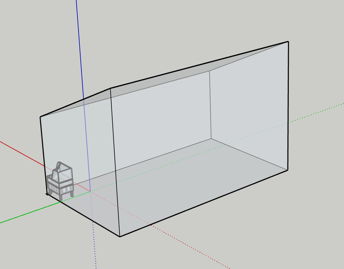

However...last night I dug a little deeper into akabak (watched some videos...). And, since I do know exactly where this is going, and in what room, it seemed highly appropriate. The room is 22 x 8.5 ft, with a ceiling slope from 8.5 to 14.5 ft. So I just spent more hours than I care to admit generating what I hope to be to correct 3d models. I am really curious to see what this will show me. And very interested in suggestions/comments.
No bracing in cabinet yet. I think the model is right? The ports don't look it, but they are open at the bottom.

Steep learning curve? Understatement for me. Somewhere, somehow I can't figure out how to get my sketchup to the right mesh format. I feel like I could have built a rough shell with the amount of time I have spent circling the sketchup drain....argh. I end up having to use some online step file repair tool, which then generates a bunch of elements. Then an accidental click with gmsh, and back to square zero. There has to be something that I am missing, and I will be embarrassed once I figure it out.
But i am committed to learning this, and so curious as top what it tells me about speaker placement. And I love that these tools are open source, and group supported. A bunch of unsung heroes have certainly created a wonderful playground.
