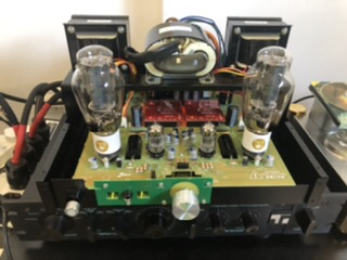

My TU 8900 pictures
A couple of pictures to share. Not finished but already singing
