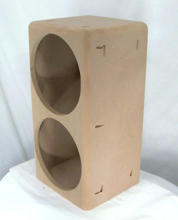

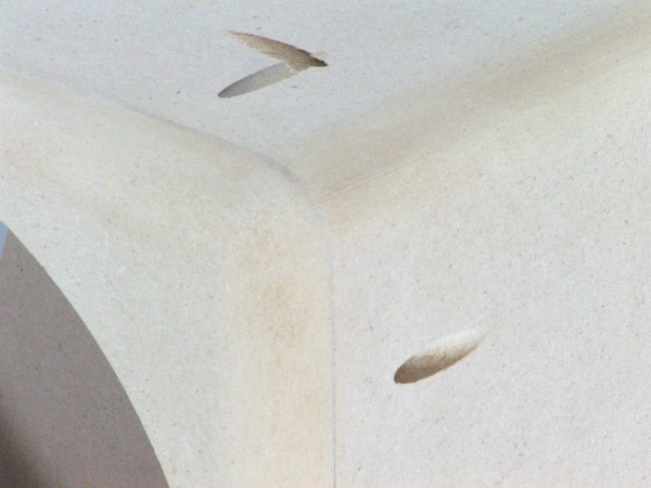

A shipment of cabinet flats will be on their way to Earl tomorrow. These are cut on the CNC, assembled with pocket hole screws, rounded on the router table, sanded, numbered and then disassembled to be packaged. The pocket hole screws really simplify assembly for those who have limited tools available. As all holes are pre-drilled and each cabinet assembled already, they should simply screw back together exactly as they came apart. Seams will be nice and tight. Well, of course I'd suggest using wood glue when you put them together. 🙂
Here is a pic of what to expect with 7 pocket holes one each side and 2 on top and bottom. The holes can be easily filled with body filler, wood filler, etc after assembling.
John
John
