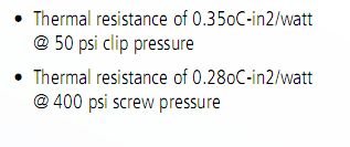

Well, just when you were writing your answer I took another look at the datasheet of the T-gard datasheet only to notice that "T-gardTM 5000 is ideal for applications that require a delta temperature across the interface of 2.0°C/watt or
higher on a TO-220 clip mounted @ 50 psi pressure." I would have thought a delta temperature of roughly 2 degrees / W (OK, it's TO-247, not 220) would not suffice for the 70W heat dissipation / 2 IRFP devices / channel of the F2...

You're right, I was calculating as if the thermal resistance would increase instead of decrease with increasing the surface! Stupid! In this case, for the ~2 square centimeters of the metallic part of the IRFPs I would get say ~0.7degrees/W which would roughly translate into a 25 degrees temperature difference between the mosfets and the heatsink. Should do, I guess...

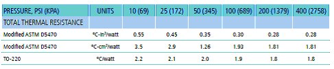

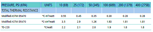

Juma, why am I wrong again? In the datasheet it says 1.26 degrees/square cm/W (see attachment), so at about 2 square cm IRFP surface this would give about half or 0.63. I rounded it up to 0.7 just to be sure. 1 square inch is > 3 times the IRFP surface and that's why the figure / square inch is much lower. If the heatsinks I am building will be efficient enough, around 0.3 C/W that is, during the hot summer days when I get a bit over 30C in my room the contact surface of the mosfet should be at 70-75 Celsius. I hope this would be acceptable.
