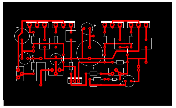

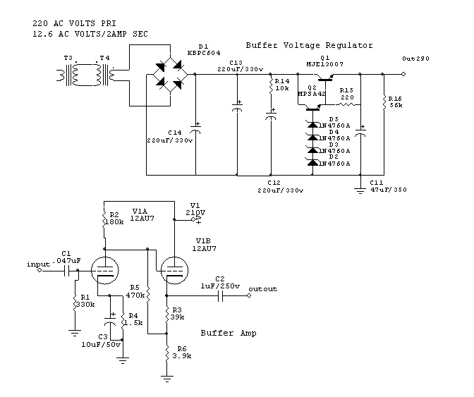

Code Nelson infor
Everything I wanted to do, was somehow done before. We all want to be the first at something. But often, we can not have our way. So we do the best we can.
Nelson designed and put together the PLH amplifier, which I found to be very interesting.
It was my intention to design a better PLH, but the more I tried to change the design in an effort to improve it. The greater the parts counts got. Soon I was designing a monster unit.
I did not want that and the changes were getting beyond the scope of what I intended.
Looking at the MosFet Citation 12 that I had built, I discovered that it required a lot drive to get the smooth bass and tremble. And PLH was the same also. But once the input was there, it was not good, but outstanding.
So I added a buffer amp. A vacuum tube buffer amp as the front end of the amplifier, requiring no mods, just the addition of the buffer stage.
It improved the tones a great deal. Then I used my Conrad Johnson Fet#2 pre amp. And that completed the system..., almost.
What was lacking was a power supply to power the amplifier. And I found one At Harbor Freight. An arc welder transformer with a 115 volt input and 70 volt at 50amp output. $100.00 dollars new, then I destroyed it.
I am posting the pcb of the PLH, single sided board, with only two jumpers.
It is not to scale. I used bipolar caps for the input and output, until the 10uf caps arrived from Mouser. But I never got a chance to upgrade the pcb. All caps voltages were increased as I played with the higher voltage.
I installed IRFP460's units (Quasi's favorites) in the output. But IRFP250 are good also. Jameco Electronics has them them both.
The Buffer amp used a 12AU7, but a 6DJ8 or a 5963, 5965 works great.
The buffer needs a regulated power supply, two inexpensive 220volt.12.6 volts@2amps transformers works good. Use a good fast switching power transistor. TIP 48,49,50 will induce noise. MJE13000 series are outstanding. The MJE13009 is the best.
I have not posted the pcb for the vacuum tube, but it is turret designed pcb. Very simple.
Also I will post drawings of some of the other types of vacuum tubes circuits, in which the research was done by Wim De Haan.
I used the 12AU7 because it is easy to obtain. The buffer amp being submitted is a clean tone unit. Flat.

I nssd help!
I designed the Buffer Amp stage, for pcb layout. I used
Express PCB, so that anyone can download it from their web site, if they so desire.
My problem is, that I do not know how to upload the Express PCB files so that members can simply download the files from the forum. Can anyone tell me how that can be done.
I use WinRar, but the forum will not upload .RAR files.
Help me out here guys..., please.
